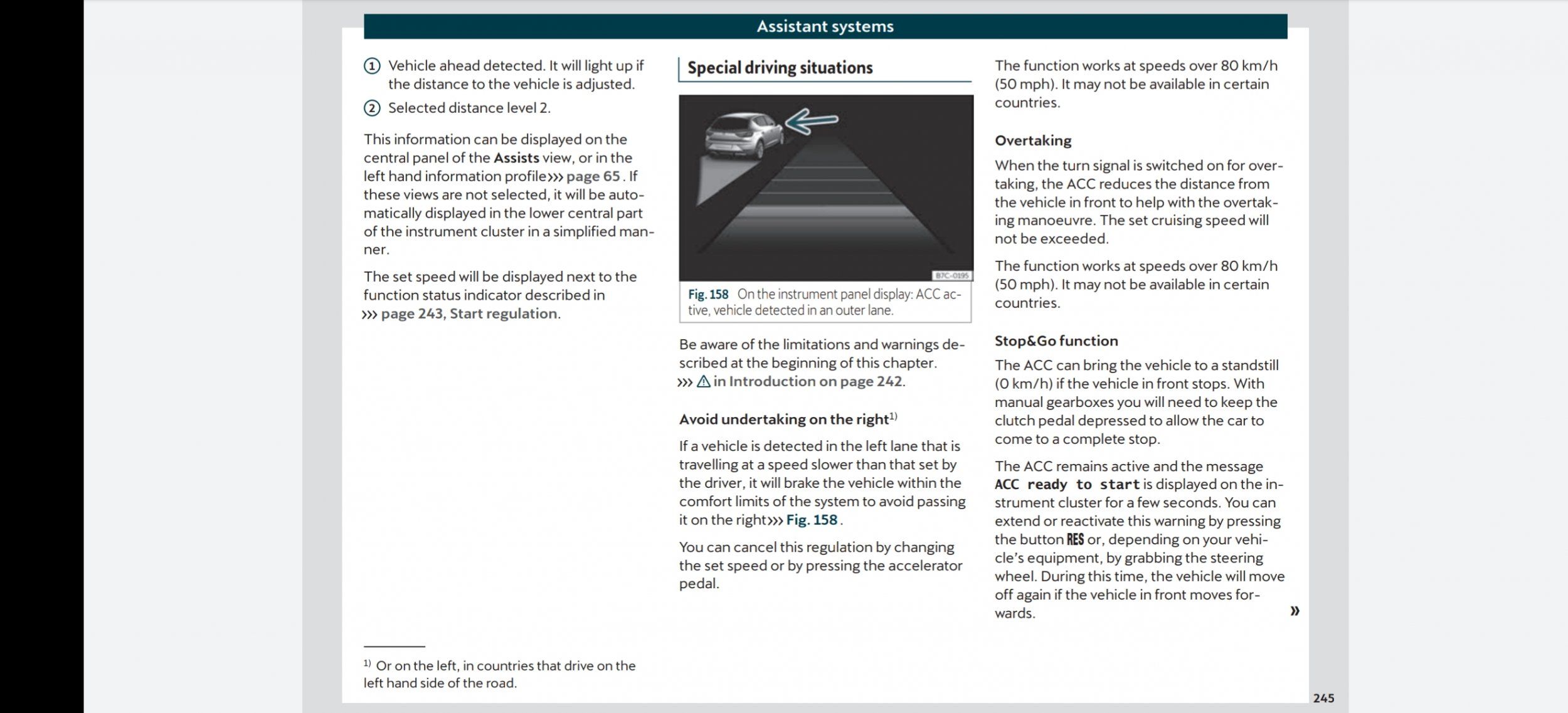

Thanks for the feedback Agnes. I've just read the manual and it specifically states that it should only happen when passing cars on the left (wrong) side, so I think they've got it set up incorrectly for UK cars. The Golf never had this issue and the hardware, I'm pretty certain, will be the same. I'm going to contact Cupra and see what they say. Snapshot off manual extract :

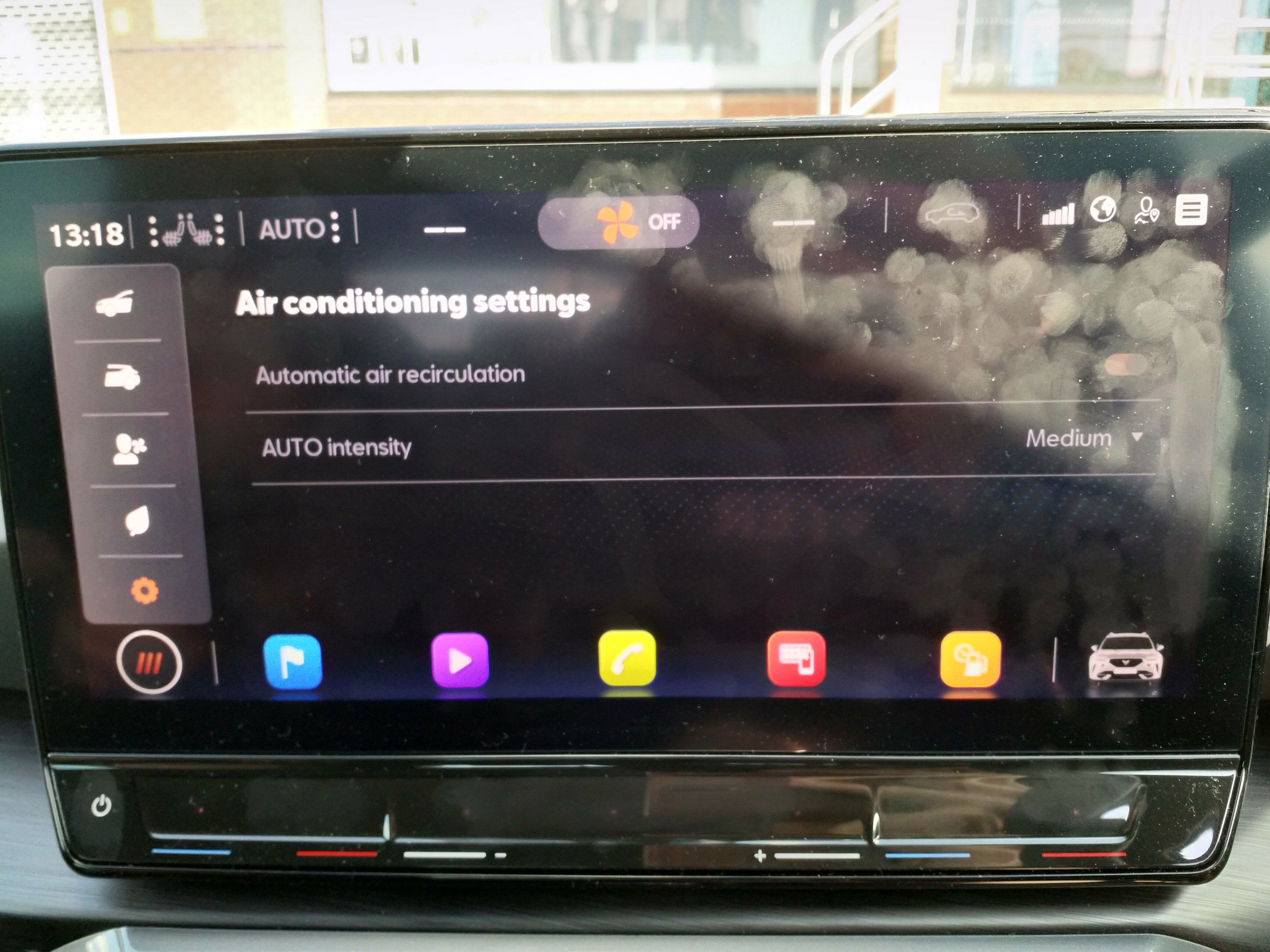

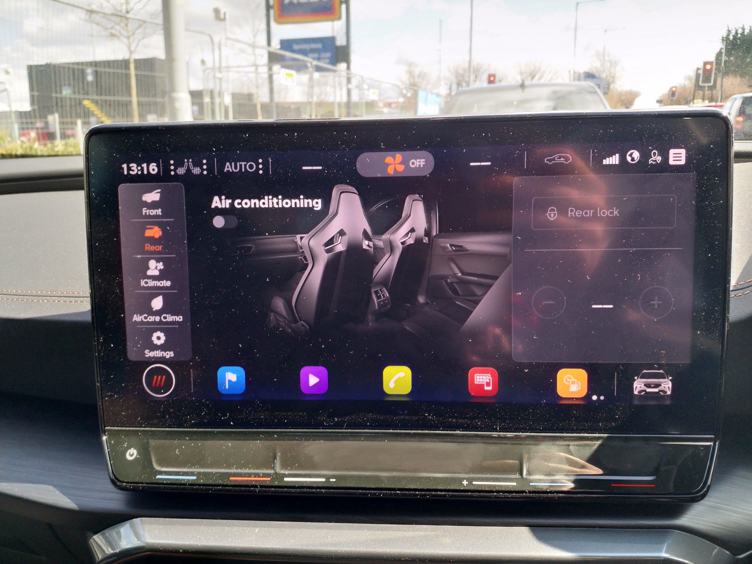

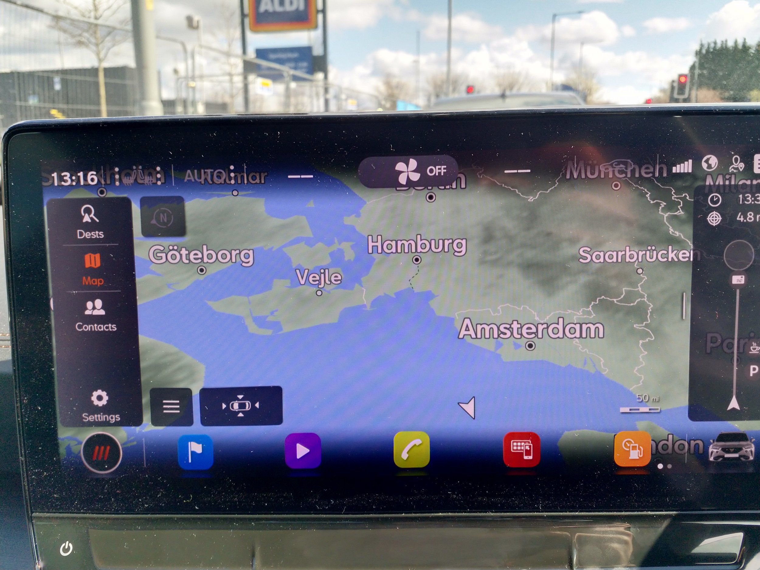

Right another problem with heating system doing my tits in now, look at this.. none of the ventilation/ heating controls are even illuminated for me to do anything. And the touch sensors aren't responding.
Sorry should have put this in system errors

I've had to park up, lock my car, walk off, come back and it's now sorted itself out.. ball ache though need to get in touch with dealer
I was thinking it is a mistake. Just like they had SYNC for AC work like in LHD cars, it looks like ACC is behaving as this is a LHD car. Make sure to query Cupra about this.
