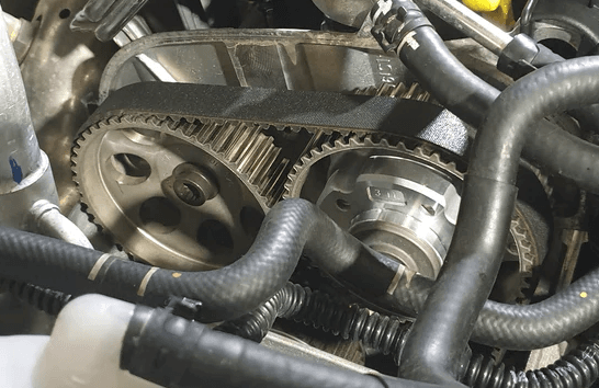

Someone mentioned it might be the cambelt. Took some pictures. What do you think? Time for a replacement?

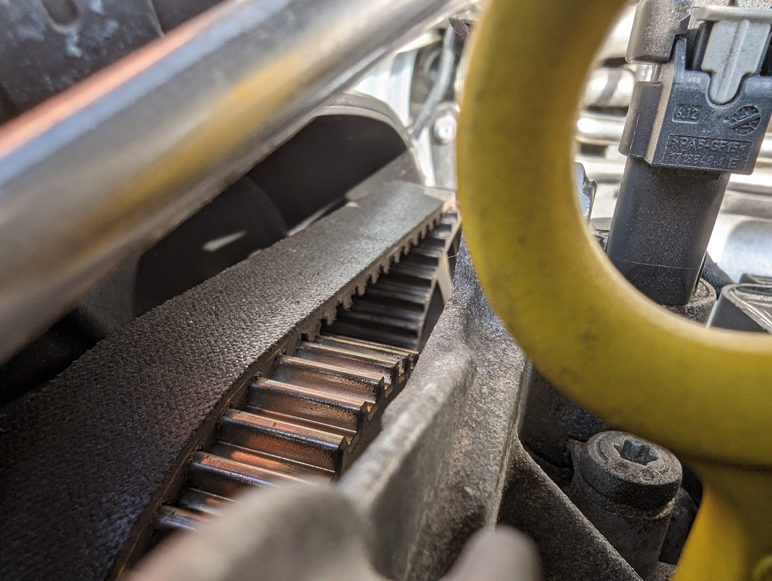

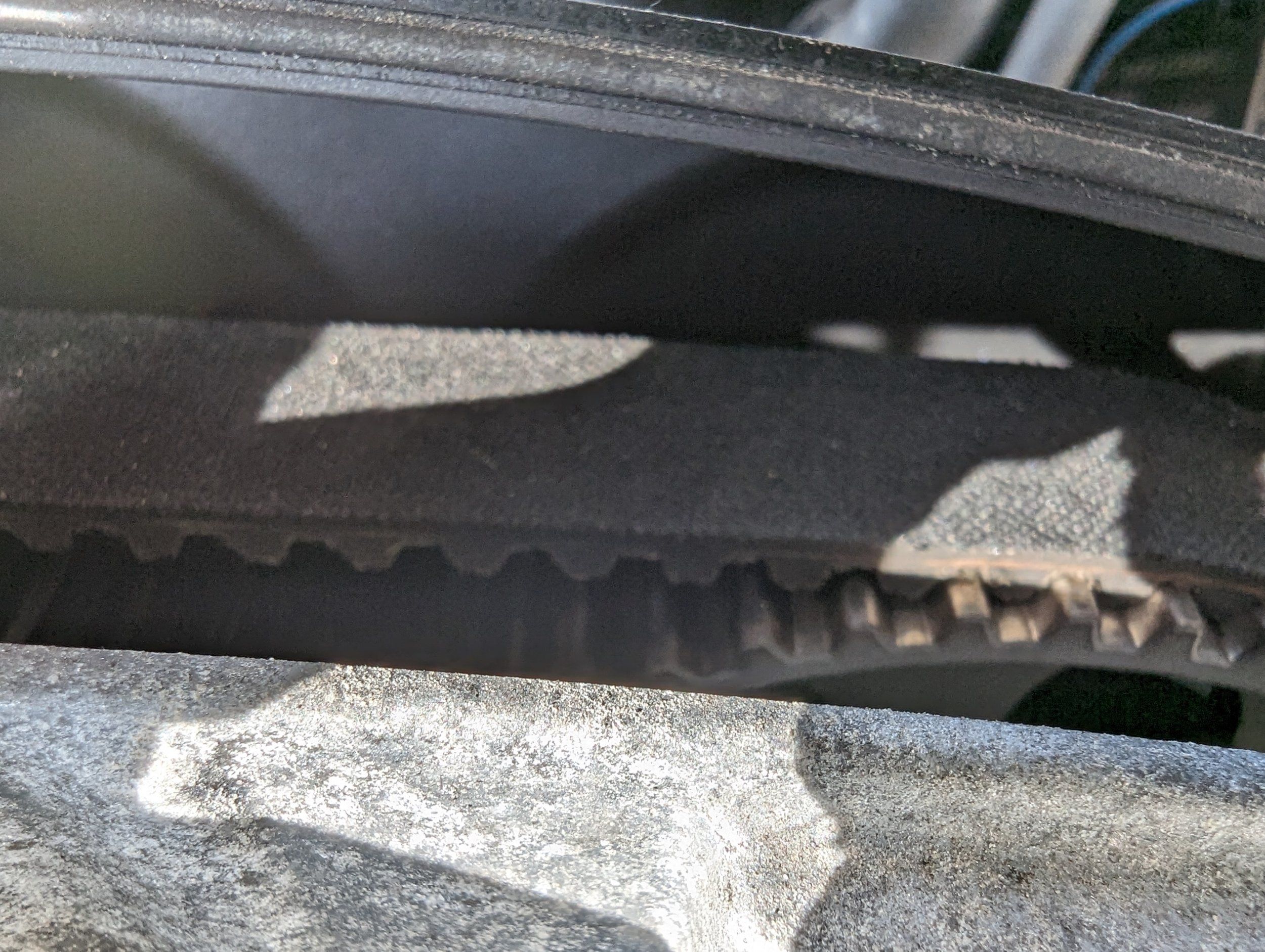

Pictures of the cambelt btw.

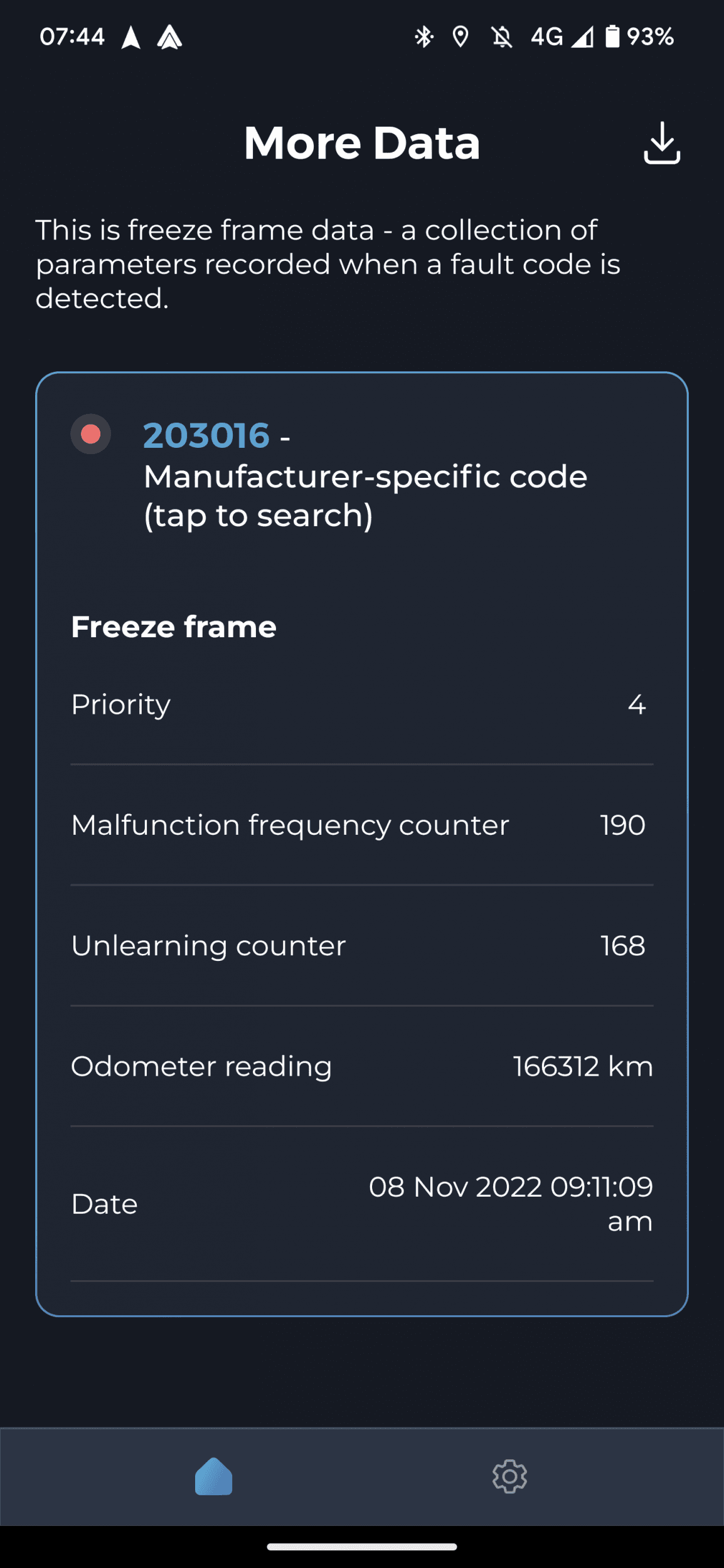

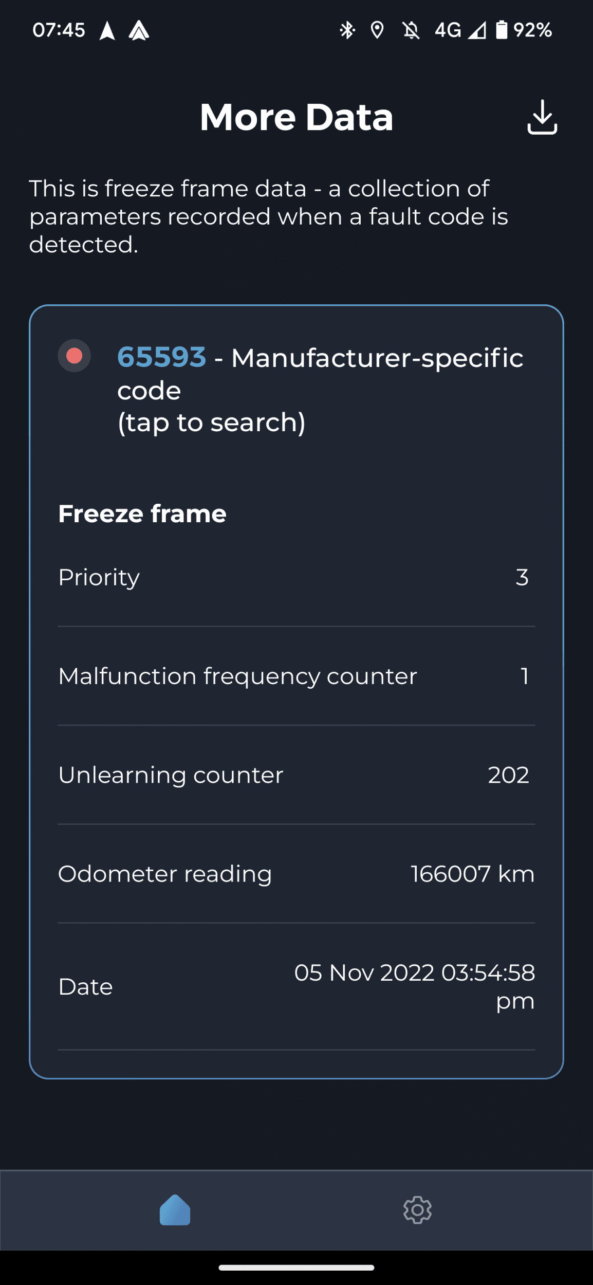

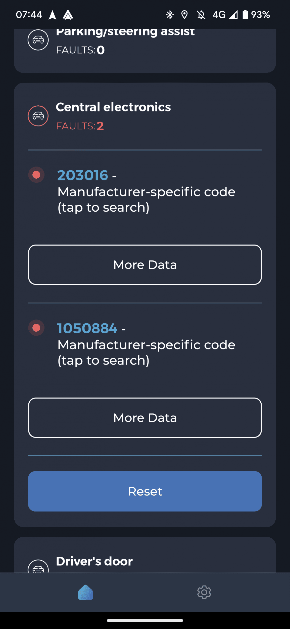

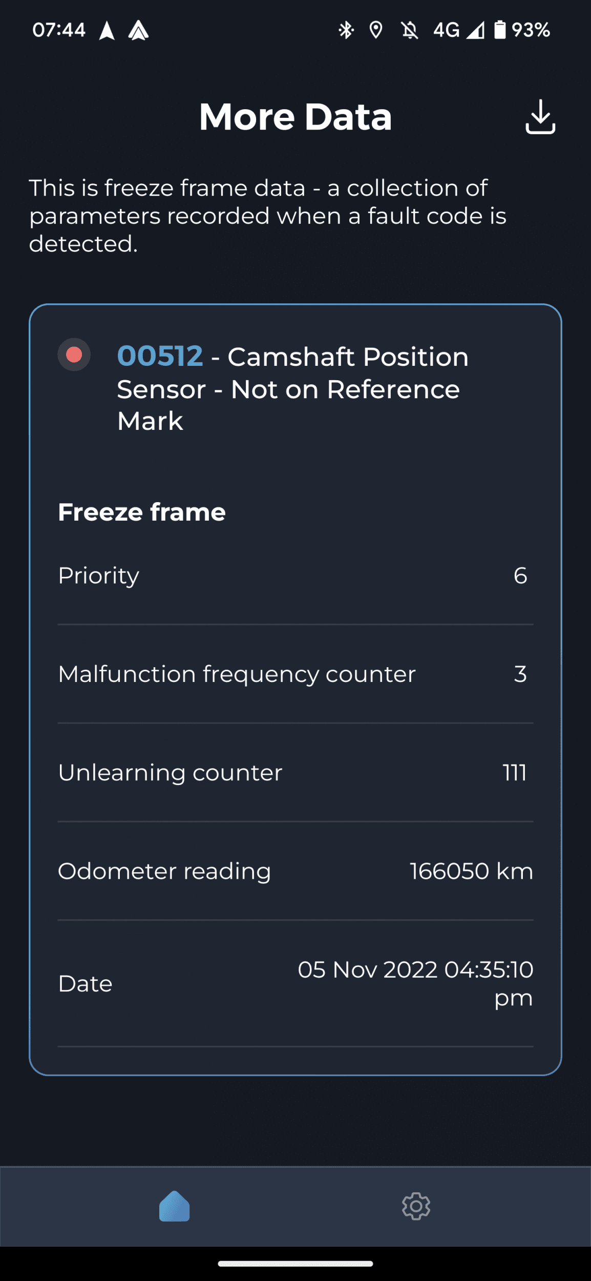

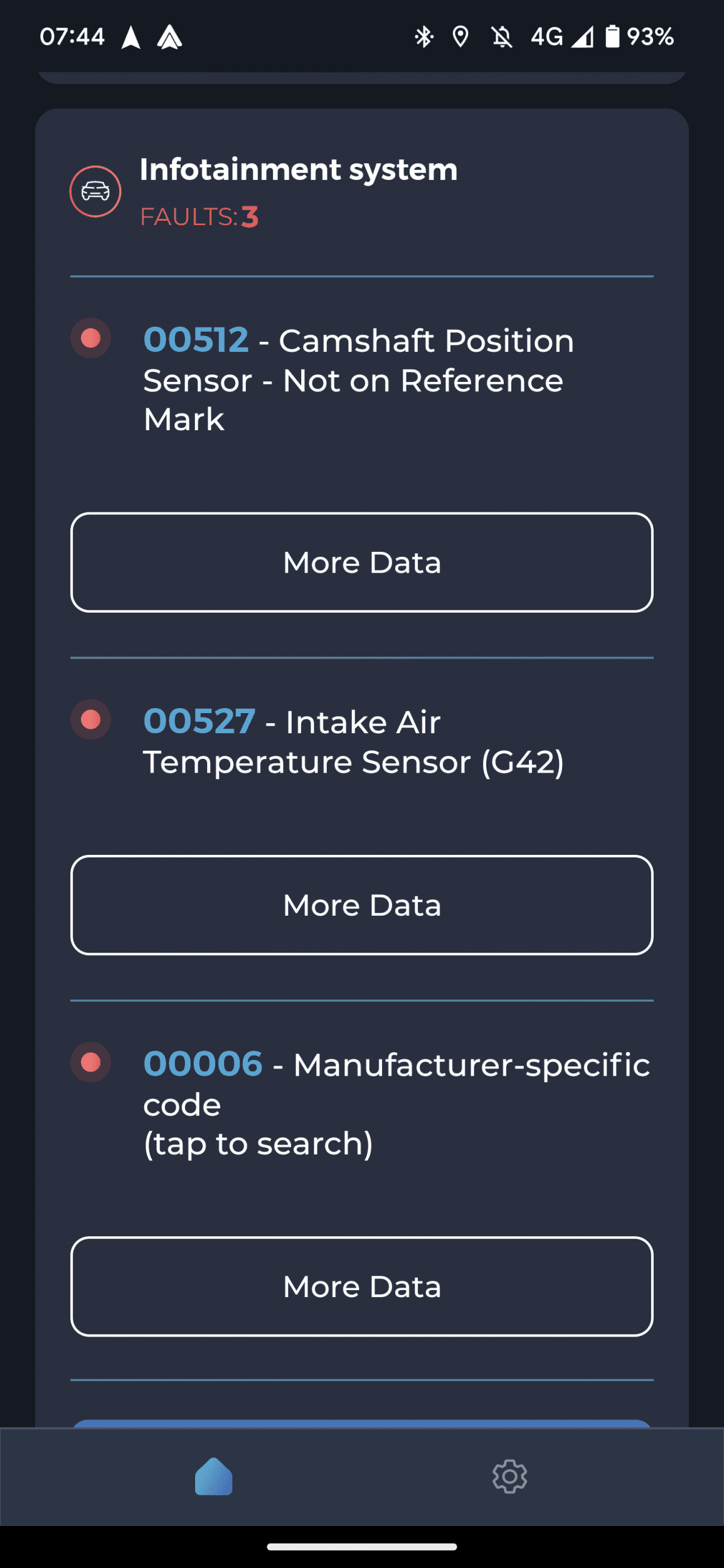

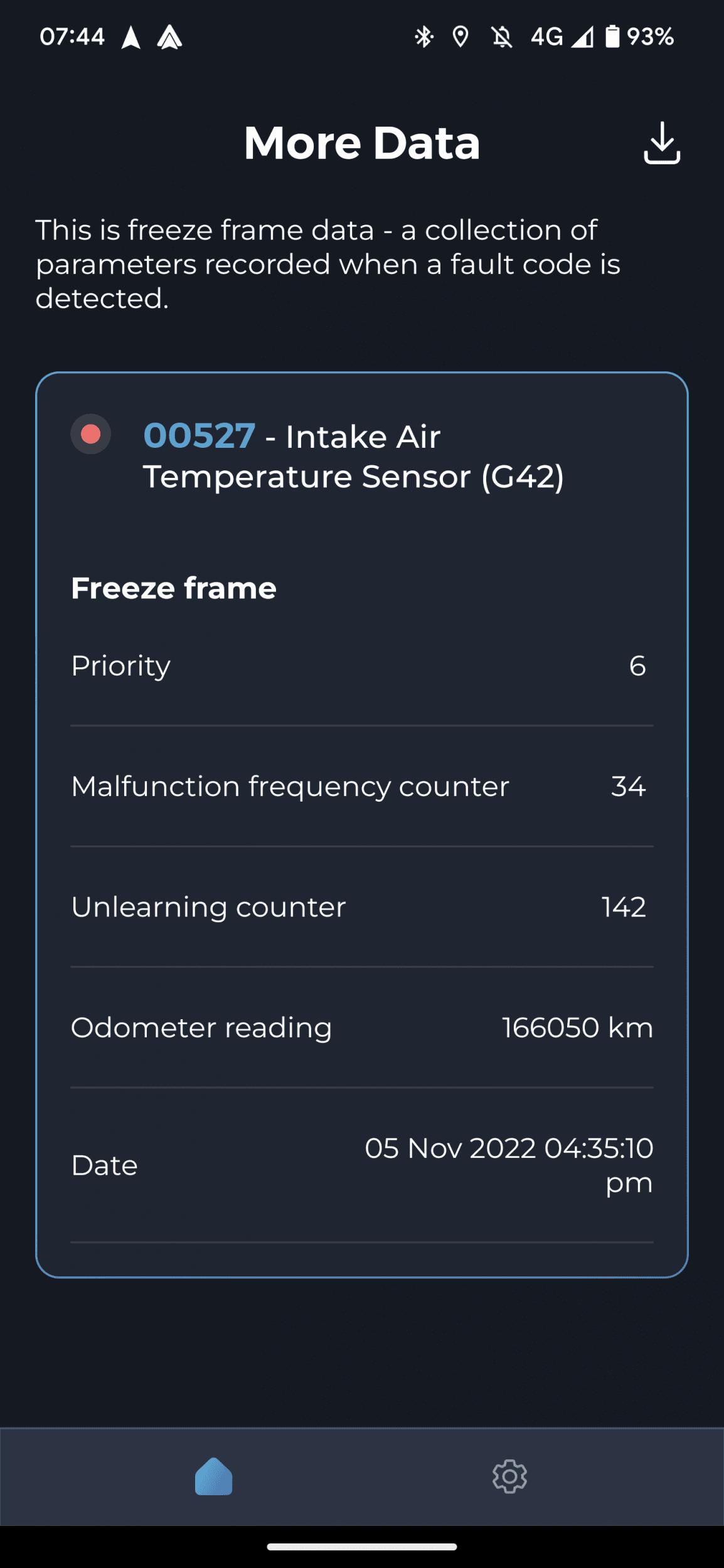

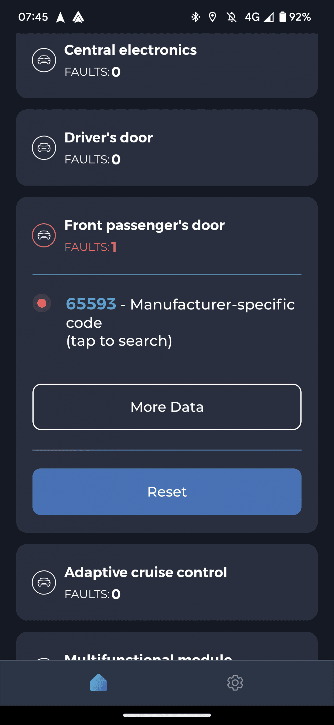

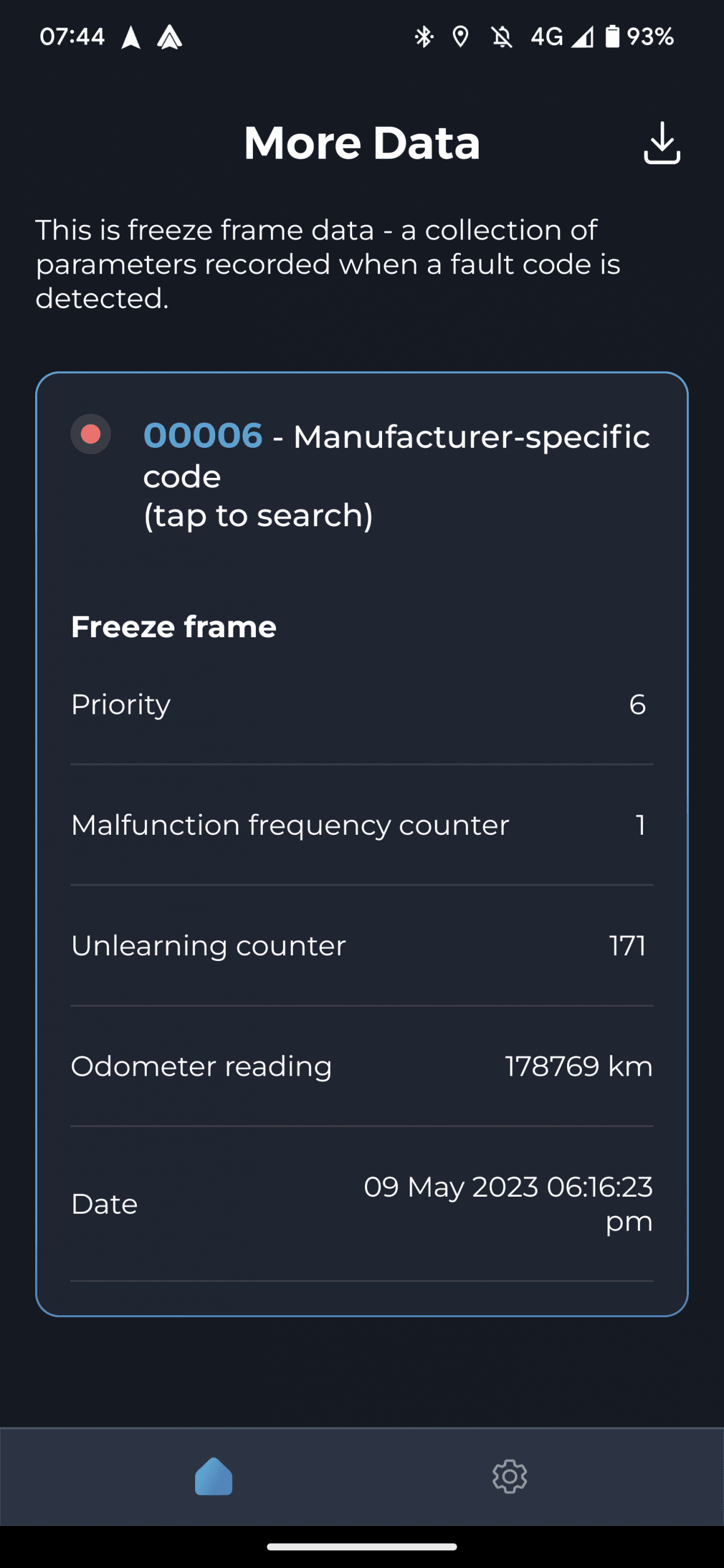

Plugged in the carista to check for errors too. This is what I got back.

The cambelt can't cause intermitant issues, but it looks horrible from what i can see in the pics! Also the position of it in the first pic is very weird! i was trying to work out if it was a camera angle, but it looks like its almost come off the back of the pulley?? Is it tensioned properly? It should be fairly tight and you shouldn't be able to slide it back and forwards.
I'd get it looked at/changed ASAP.
I've noticed that the cam belt does not sit in the centre of both these cam shaft pulleys on my wife's 2015 VW Polo 1.2TSI 110PS, so I've put it down to a design error, regardless of where the cam belt or new cam belt is initially located on these pulleys, when the engine is turning, the belt will move into what is the "best" position for it, which probably means the position that reduces its tension to the minimum for it, just logic in my mind.
This is just the angle of the photo I believe.
The one pulley on the EA211 looks like its twice as deep as the other pulley.
