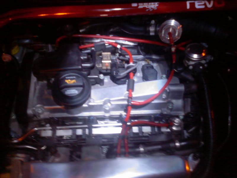

just would be nice to have a bit of noise from it thats all? had a look on the searchy but the pics dont make much sense can you not see the 249 valve on any of the pics abouve or could you give me a clue where bouts it is??
gazjones
you have two pies coimnig off the top of the inlet manifold, one goes to the fuel pressure reg ( round brass thing) the other goes into a t piece. the pipe coming off the t piece goes into the n249 valve. this valve also has other pipe going in the back. and one coming out of it to the dv. remove the pipe going to the dv at the n249 and remove the pipe going to the 249 from the t piece join these with conetcor in line sort. thats the first bit, this way saves removing pipes from t peice i brok my t pice trying to this lol.
next bit is to run a pipe from the back of the non return valve, this is located just after the t piece, this valve has a pipe going into a right angle conector remove the pipe from the right angle conector and get some new vac hose and another connector, then you will see another valve like the 249 at the back of the engine bay. remove the hose that joines into the frame of pipe that connects to the vac chamber. and attach hose from the connetor you installed on to this
sounds complicated but if you look at the pics of my red hosing you will se what im meaning

so in the pics abouve is the n249 valve not been bypased? will be able to do the first bit easy will need to look at my engine to see what you mean on the second bit how much 3mm pipe do you need (length!) beacause ive got some 3mm vacume pipes knocking about might do it now??
gazjones
not much lenth from other valve to the pipe of the back of then non return about 15cm i would say
gazjones
the pic ive posted are normal one ive just taken pic of it done will load up now
gazjones
this is it give an idea whee things go but i think conecting the dv hose to the one going to the 249 is better for doing it quick at this time of night

gave the vacume hose rearrangement a go but was a bit foggy on the hoses that run into the back of the n249 valve and there is a black rubber hose type thing going into the back wasnt sure about that might give it anouther go today before the crawley meet :)

gaz gave it a go last night obviously the 1st bit is really easy but am confused on this bit could you word it diffrently mate because am really wanting to do this before it gets dark tar!
"next bit is to run a pipe from the back of the non return valve, this is located just after the t piece, this valve has a pipe going into a right angle conector remove the pipe from the right angle conector and get some new vac hose and another connector, then you will see another valve like the 249 at the back of the engine bay. remove the hose that joines into the frame of pipe that connects to the vac chamber. and attach hose from the connetor you installed on to this" :confused: :think:
