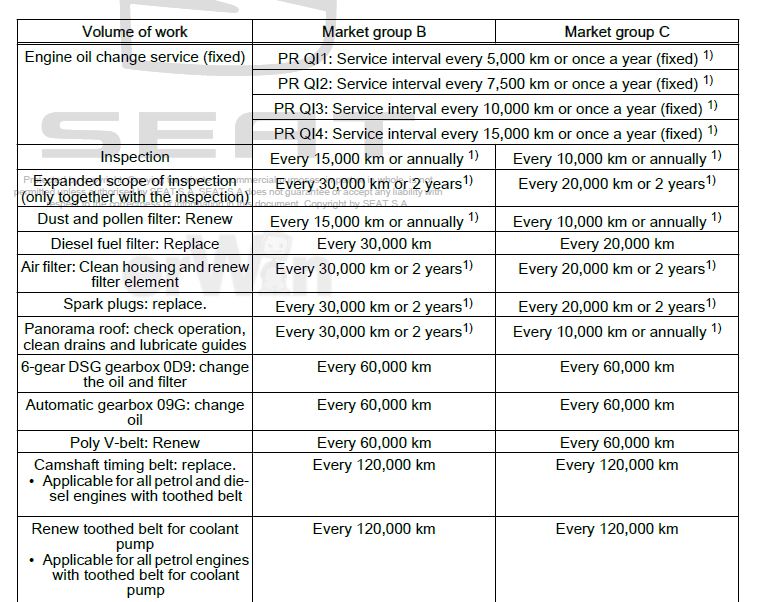

Taken from the workshop manual that @paddy6789 provided
From the Maintenance Manual Seat.

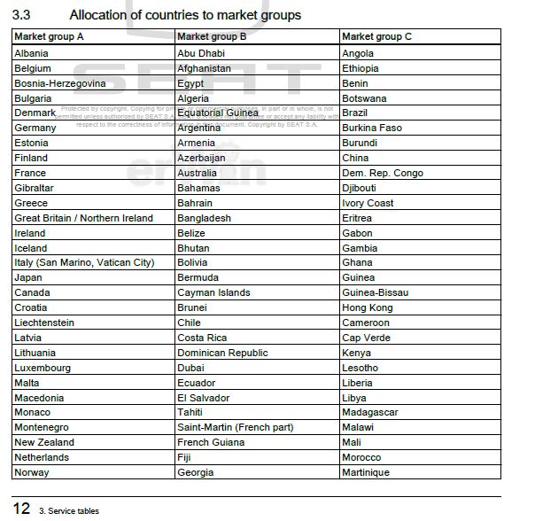

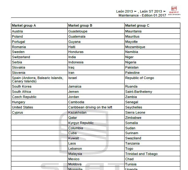

The table posted up is for another country grup, B.

Sorry school boy error I just did a search looking for Timing Belt.

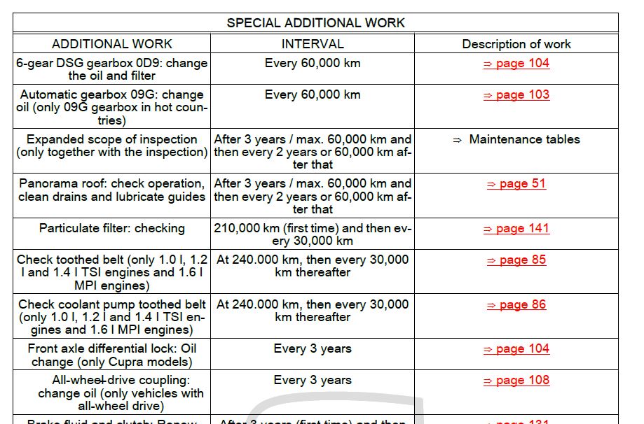

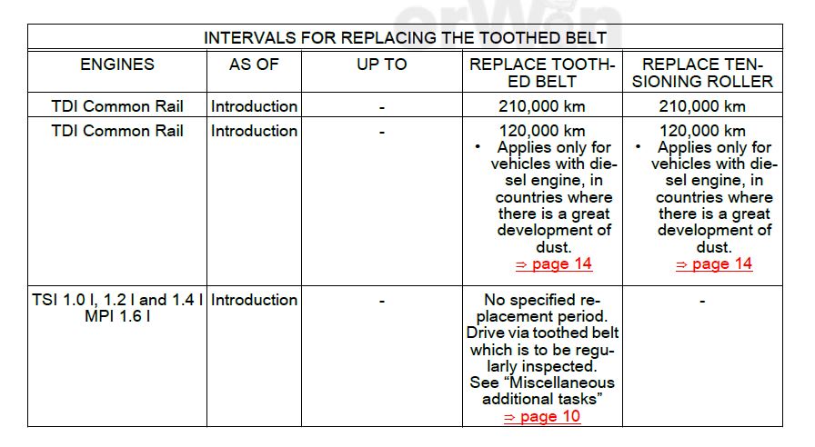

Would I be right in thinking there is no specific mileage for replacing the timing belt ( for 1.4 petrol ) ?
As long as it is inspected every 30000 miles ?
Don't think that is the case as the belt has to be taken off to inspect to see if it is cracked on the teeth which of course are on the inside of the belt. Might be wrong unless someone knows for definate??
I read daily VW, Skoda, Seat forums from Romania, UK, France, Italy, Germany and Russia. I didn't find until now one single case of broken timing belt. See how to check the belt.
