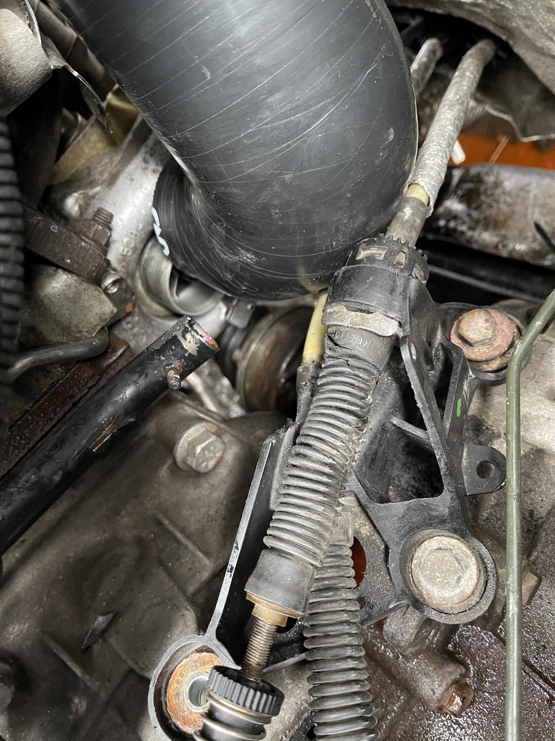

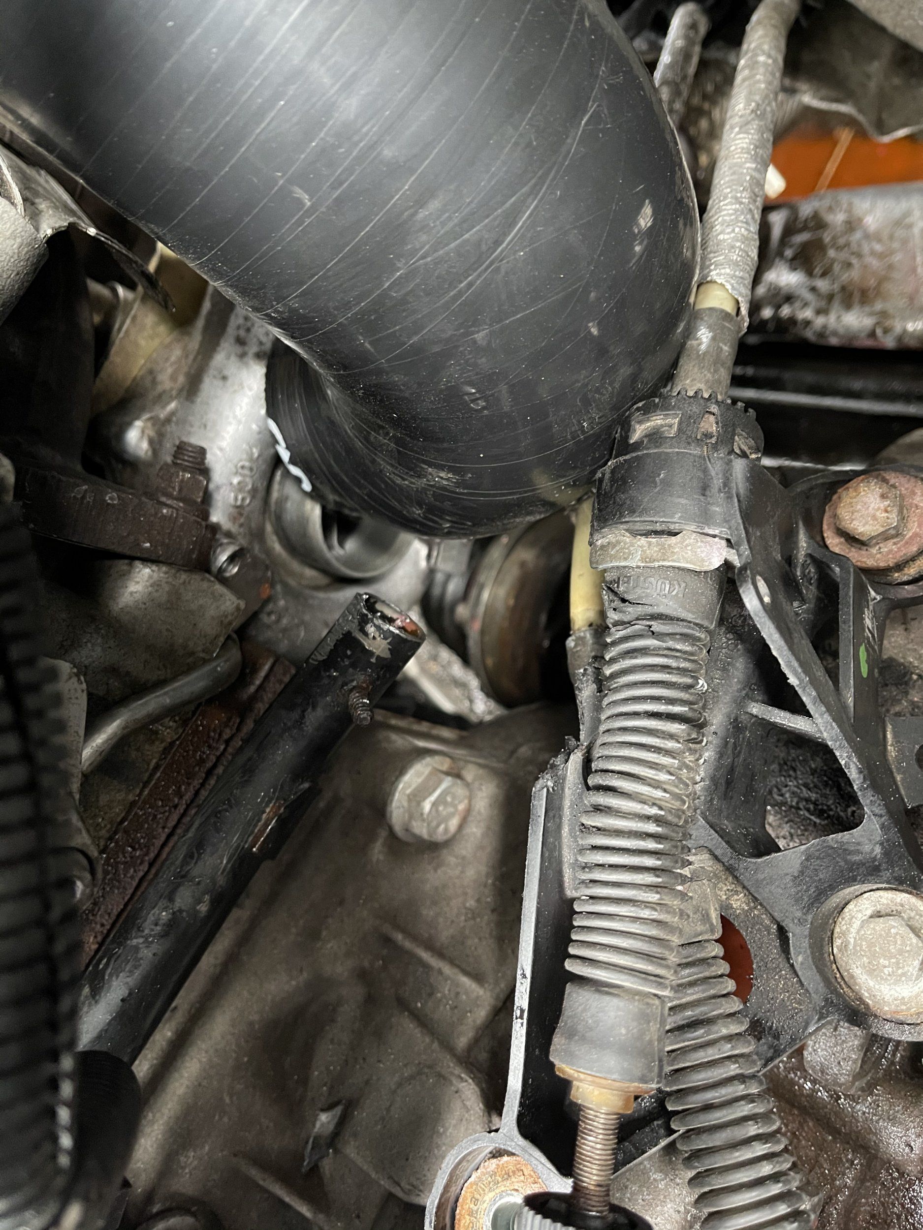

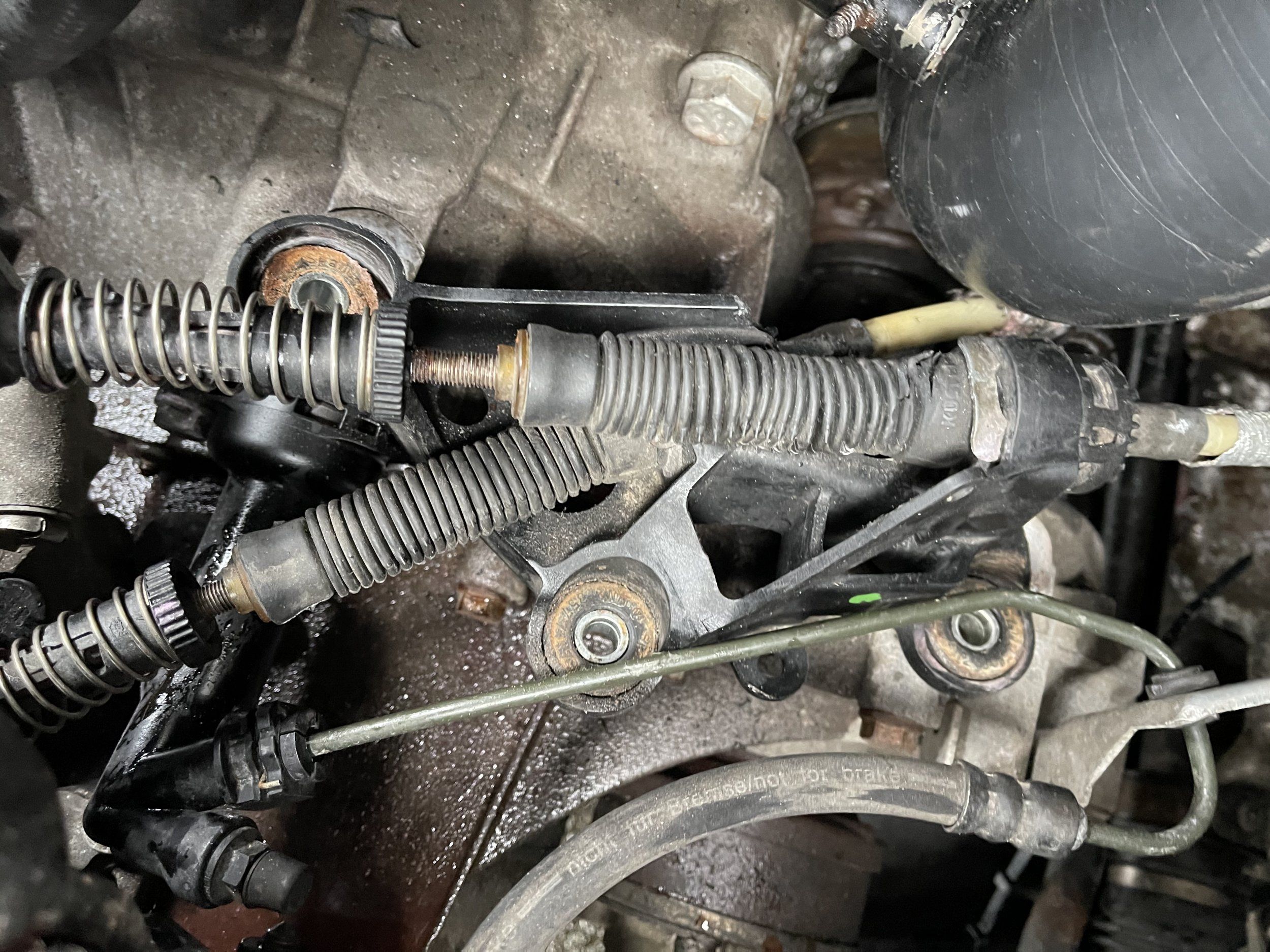

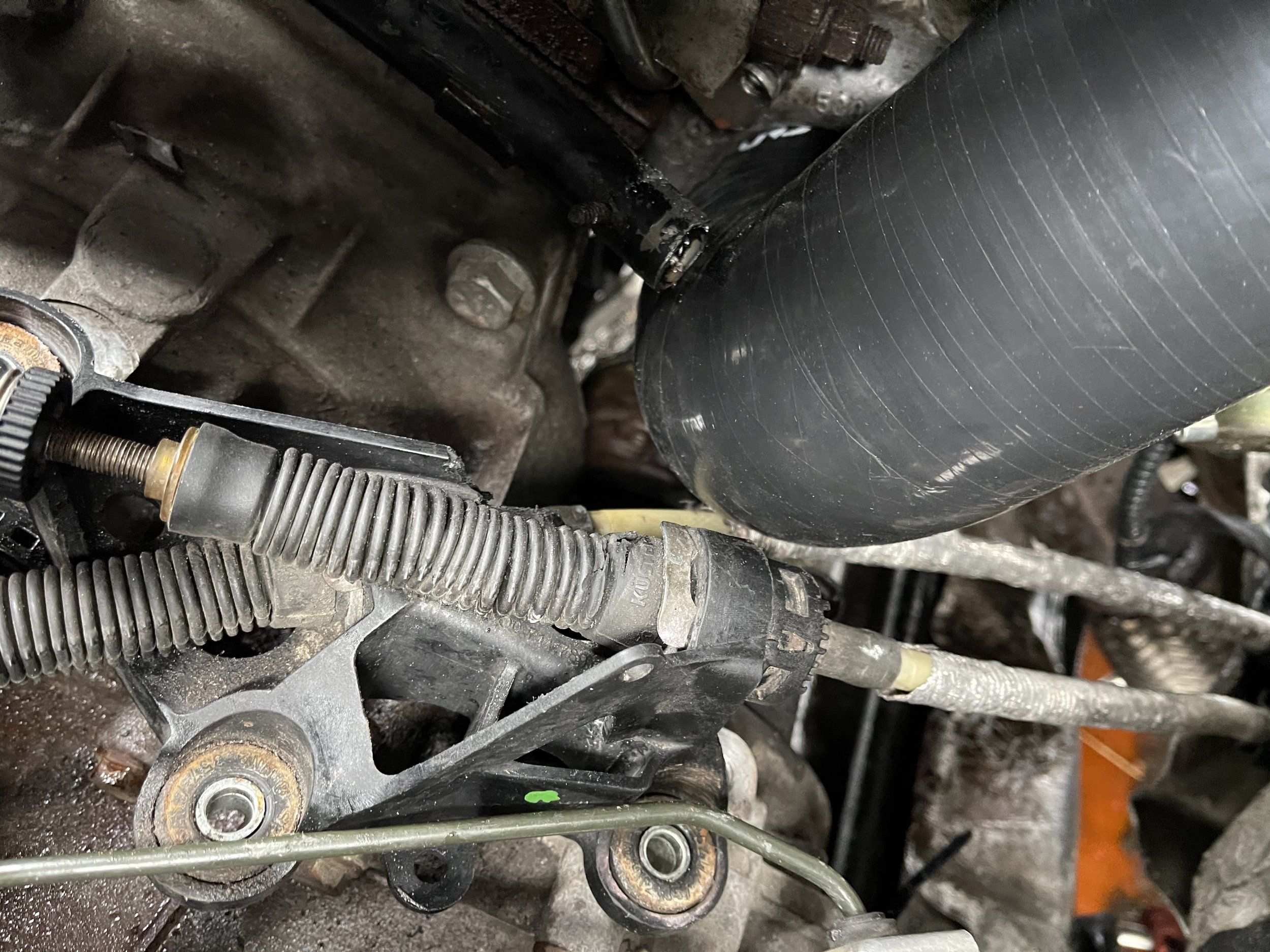

Hi mate, so I’ve taken as much as I can off the TIP before it starts to get larger and can’t fit a jubilee on it, I’ve also taken off a lot of the plastic on the housing to try and give me more clearance, but I can either get the TIP in but knock the gear selector, or vice versa

That’s strange how it’s doing that not seen that before normally the coolant line needs a tweak as it can get in the way you’ve not got it connected yet but that might also cause a issue. I’d talk to creation mate see if they’ve had this before. I’ll take a quick look online see if there is another cable bracket shaped differently but with the same bolt pattern.

Yeah I cut it and got a new rubber hose to go on (the old one was buggered anyway). I’ve got in touch with them but to be honest they’ve not been any help at all, they showed me a picture of a MK3 Ibiza with a regular sized hose on which didn’t solve anything, and then asked if the Ibiza is the same layout as the BJX Polo. Still waiting on a helpful response hahaha. The only thing is catches on now is this bloody gearbox housing/shifter cable, but I don’t really want to adjust the shifter cable when I know it all works. Cheers mate been a pain haha
