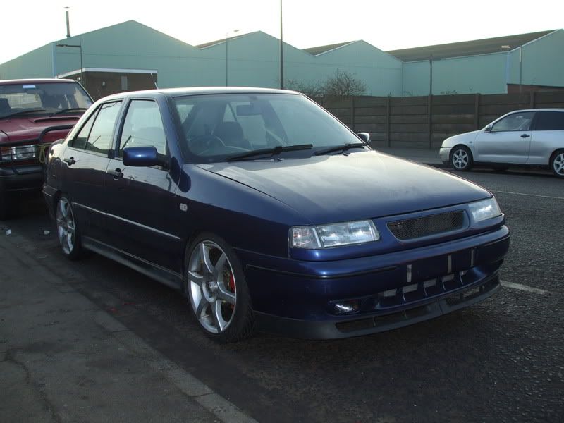

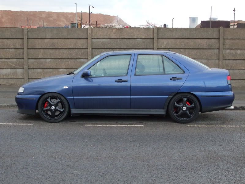

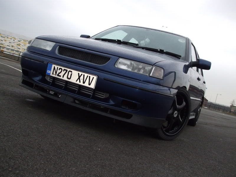

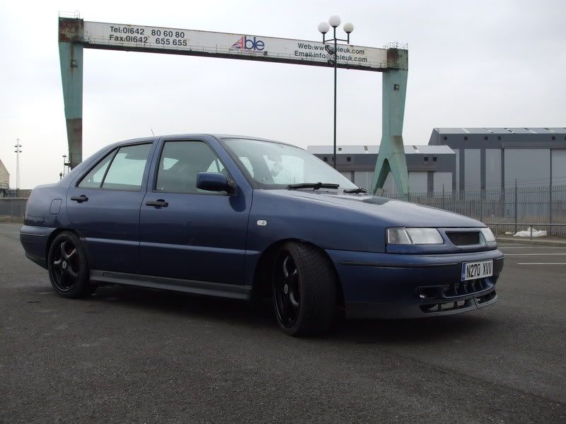

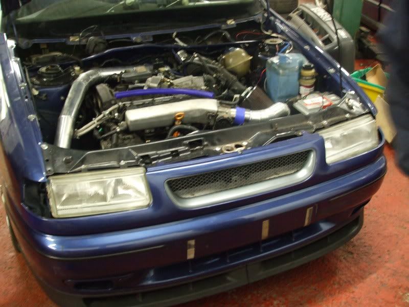

thought id post up somepics of my mates seat toledo mk1 1.8t conversion
running an ibiza cupra apq 1.8 t lump with stock management & dbw throttle

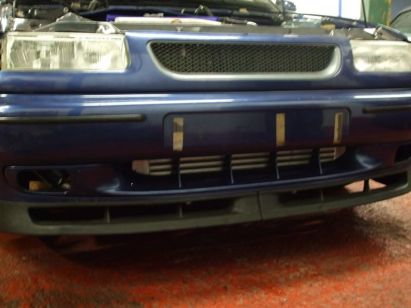

custom boost pipes & huge fmic
passat 2.0 02a cable gearbox

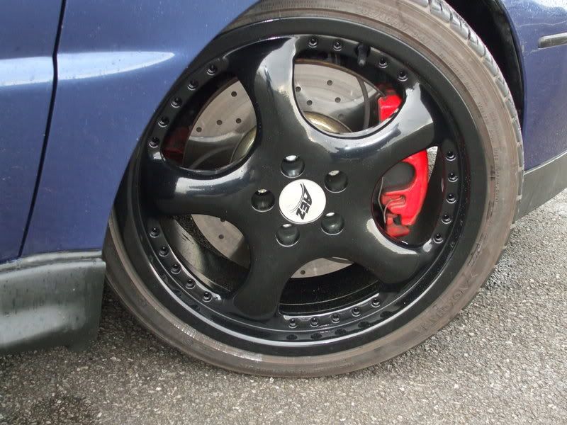

vr6 clutch & abf 16v flywheel
312mm drilled & grooved front tt brakes
mk4 rear calpers
aez porsche style black 17" rims with yoko tyres 205-40-17
koni gas shox & eibach springs
powder coated red subframes & rear axle
fully polybushed
mk3 blue & black colour concept recaro leather seats
cheers dan 4 the pics, shes beginning to look the part all we needs the remap to go with it:)

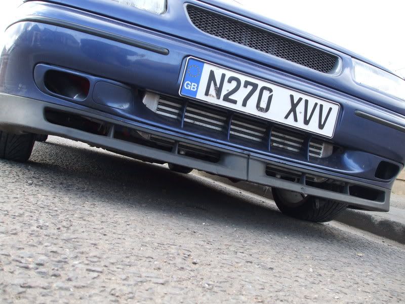

would the fmic need a little bit more air flow though ? looks like most of it is hidden behind lots of plastic.
dont get me wrong how you have got it now looks great!, was just thinking about cooling.
love the car btw, looks very nice!
no issues with cooling as there aint really anything left of the bumper but still when its ready for stage 2 revo the bumper will be removed for a bit more butchery :)

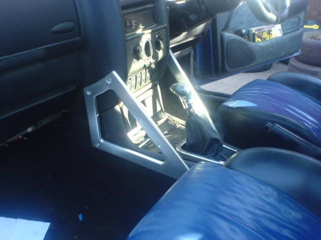

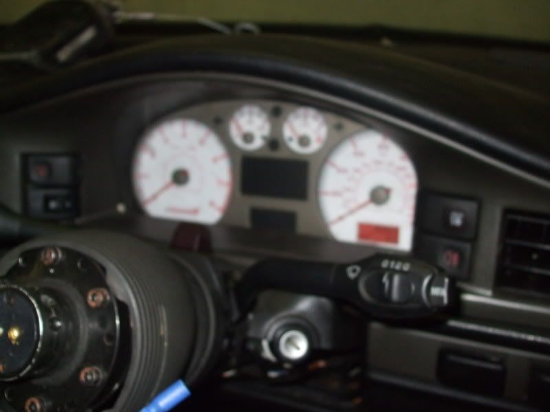

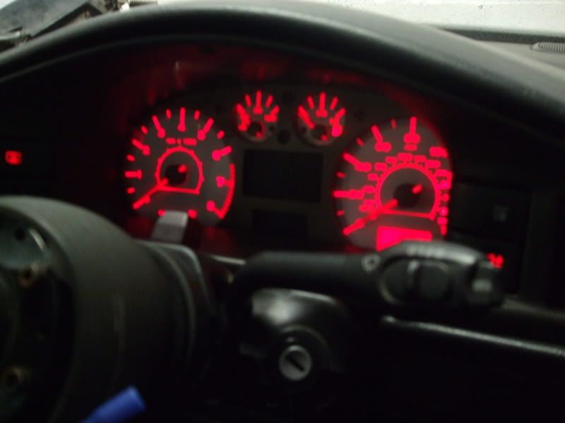

hi guys

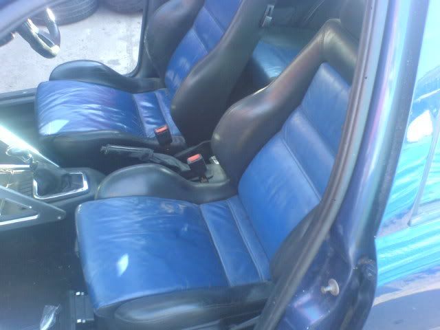

seen as you like the outside here is a few shots of the interior
mk3 golf black & blue colour concept recaro leather :p
TT dash knee bars
