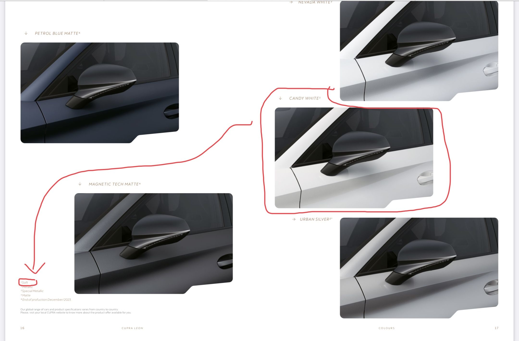

Got a cupra leon in the standard no metalic white. Can't find the paint code anywhere. Anyone know if it's the same as Seat bila white?
2,420
1,300
According to page 16 in the May 2022 Cupra Leon brochure at the link below the non-metallic white paint colour used by Cupra (non metallic is described as ‘soft’ in the brochure) is Candy White.
Forum sponsors @SEAT Motor Parts have Candy White touch up paint for sale on their website (paint code is shown as B9A / LB9A; link to the relevant pageon the sponsor’s website below (takes you to Cox Motor Parts, not Seat Motor Parts, so maybe they’ve changed their name or have been taken over?).
If you buy via their website and input your car’s registration number, they’ll check to make sure the colour is correct for your car.
