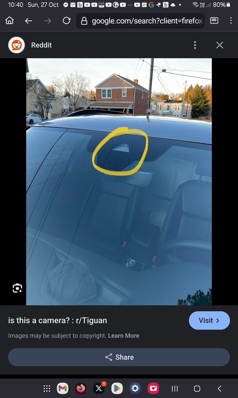

Saying that it uses the lane assist camera to image the on coming traffic headlight. No lane assist camera and you haven't got it. The other cameras aren't HD that one is. Also reads the traffic signs if you have TSR.
To activate it you have the lights switched to auto, click headlight on main beam then wait for it too digitally image other drivers lights when it will dip.
The lane assist camera looks like a feed horn aperture. Image to follow. Bit like the blinkers of a horse so it only sees in front. The inspection you do when looking to see whether a car has lane assist. No lane assist and you won't have that ability. Step number one. These will have been sold as a range of safety features and bundled with the model spec now. It's possible you have the camera but they choose not to give you high beam assist. Where the build codes come in to determine what the car has in it.
To see whether the high beam assistant is active, the high beam symbol in the dashboard is white and has an "A" in it. Depending on the country, there may be a high beam assistant but no lane assist. So there are some really strange features.
Apart from the A it's the build codes that are definitive. No aperture camera and you ain't got it. Aperture camera as above it's possible. Build codes will / should tell you. Why I say a real motoring enthusiast pays the 8 Euros of air time on Erwin and downloads the build codes, the manuals and the SSPs of interest. 8G1 on my builds.
