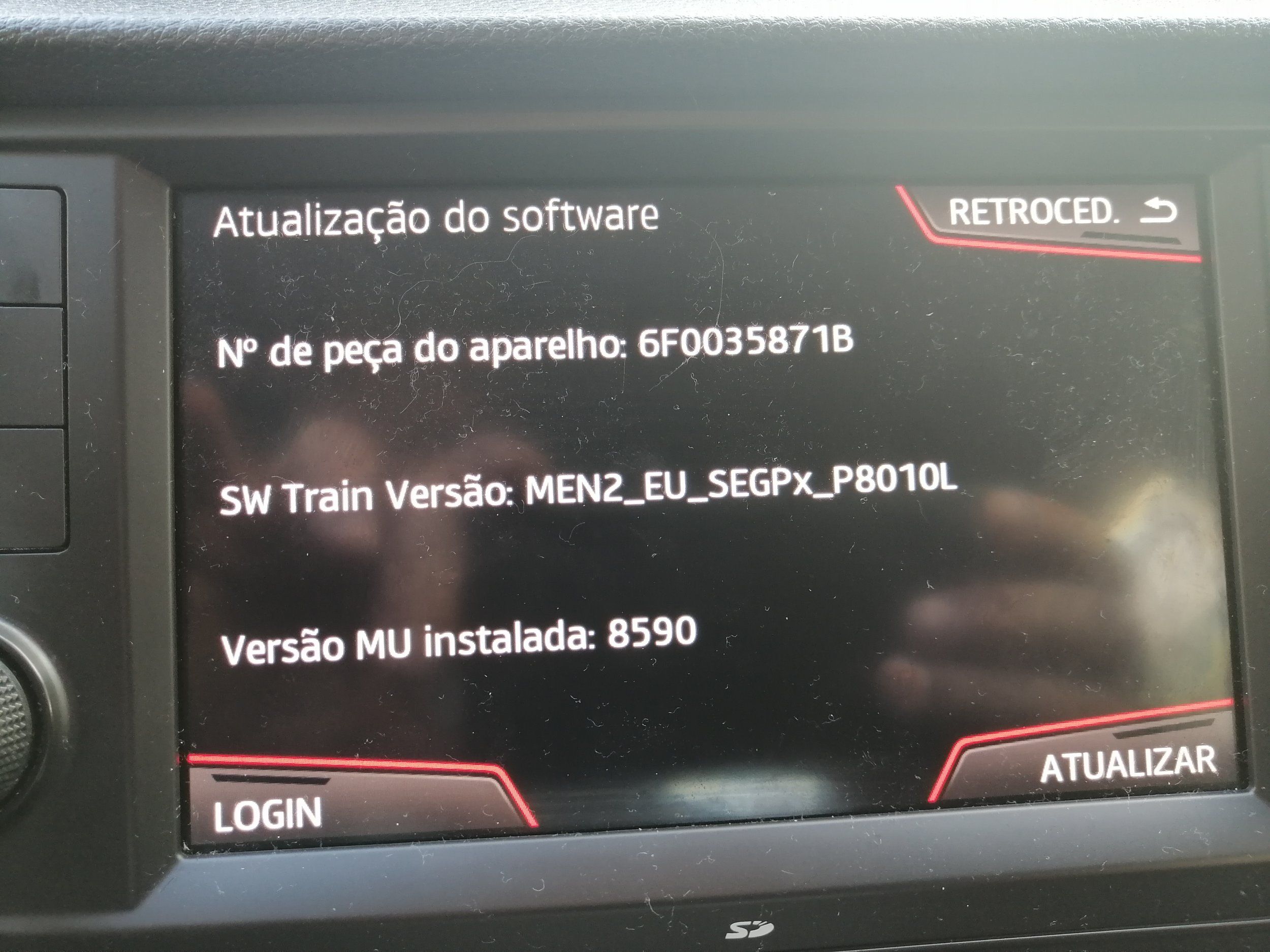

I have a Seat Ibiza from december 2019. I already updated the Maps to the newest version. However I was wondering if it was possible to update the entire firmware of the MIB platform?
Currently I have:
Hardware: H50
Software: 0514
I need to upload the firmware for 6F0035871B (SEAT Ibiza Style 2019)
The last file/software is "MEN2_EU_SEGPx_P8010L"
Can someone give me the link to download the newest version, please.

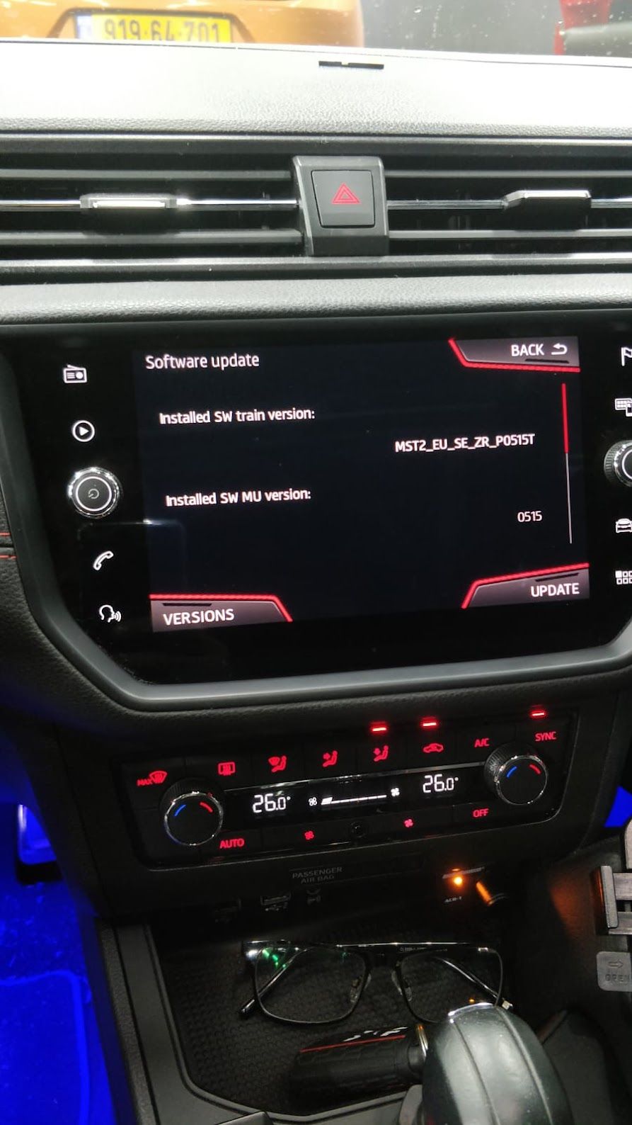

i'm attacihg screenshot of the firmware that i currently have installed on my Ibiza(kj1\6F), 2019.
how can i found out if there is software update available to install? currently im on version 515 as you can see at the screenshot attached.

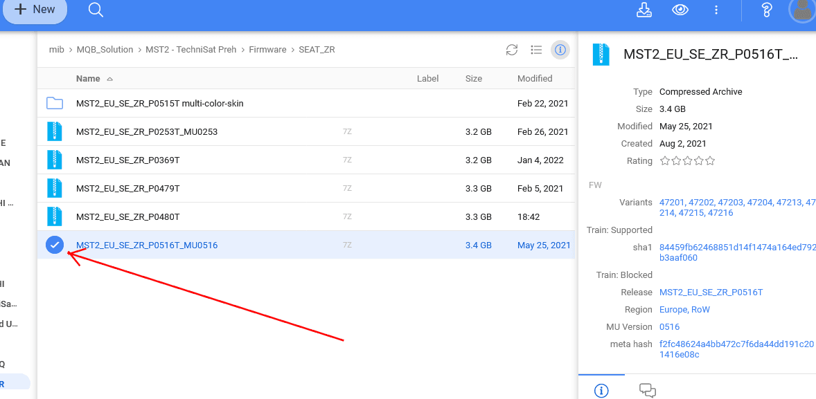

You have installed the version MST2_EU_SE_ZR_P0515T
the next version on this page ( https://mibsolution.one/#/1/9/MST2 - TechniSat Preh/Firmware/SEAT_ZR ) is the version MST2_EU_SE_ZR_P0516T_MU0516.
Yiu shoud downlod this version (MST2_EU_SE_ZR_P0516T_MU0516), unzip to a SD card and do upgrade

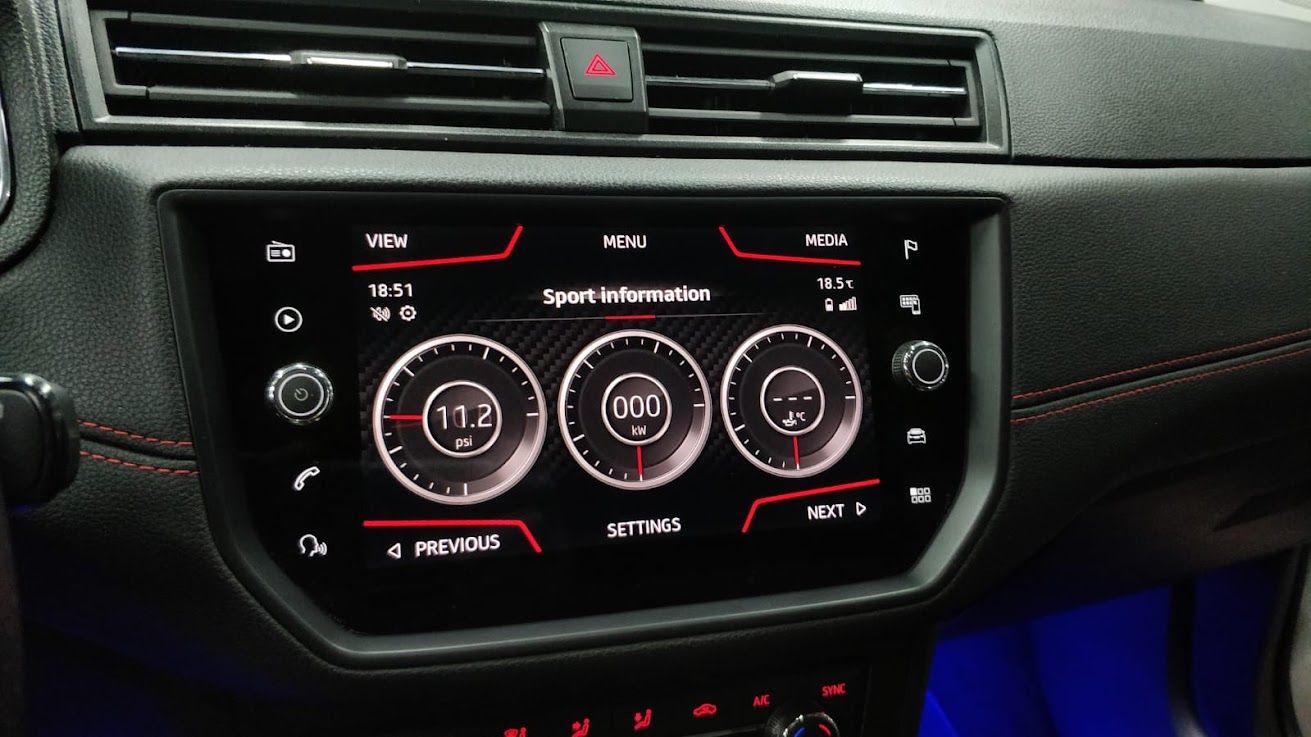

Hello guys, me again..
so as i already mentioned, the firmware update went well without errors, and everything functions without issues.
but, in the previous version i had the "sports information" fully working, i paid for it quite amount of money.
Is there any way to bring it back maybe with obd11? i've done everything as explained in that youtube video, but i was not able to open the "sports information" window...
and this is how it looks before i updated the version from 515 to 516 -
Thanks in advanced.

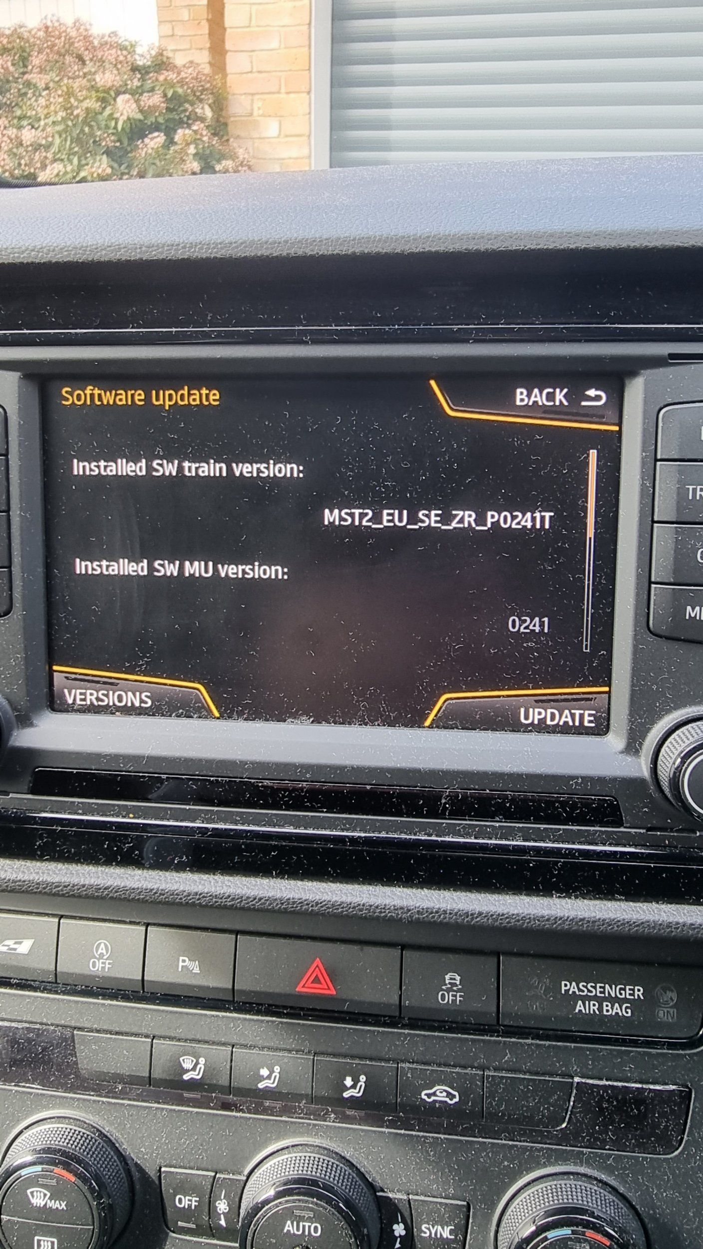

Hi I'm also looking for to update the firmware for my 2015 Leon Cupra 280. Currenlty running "MST2_EU_SE_ZR_P0241T"
but can't find a link to "MST2_EU_SE_ZR_P0253T" Does anyone have a working link they can send me please?
