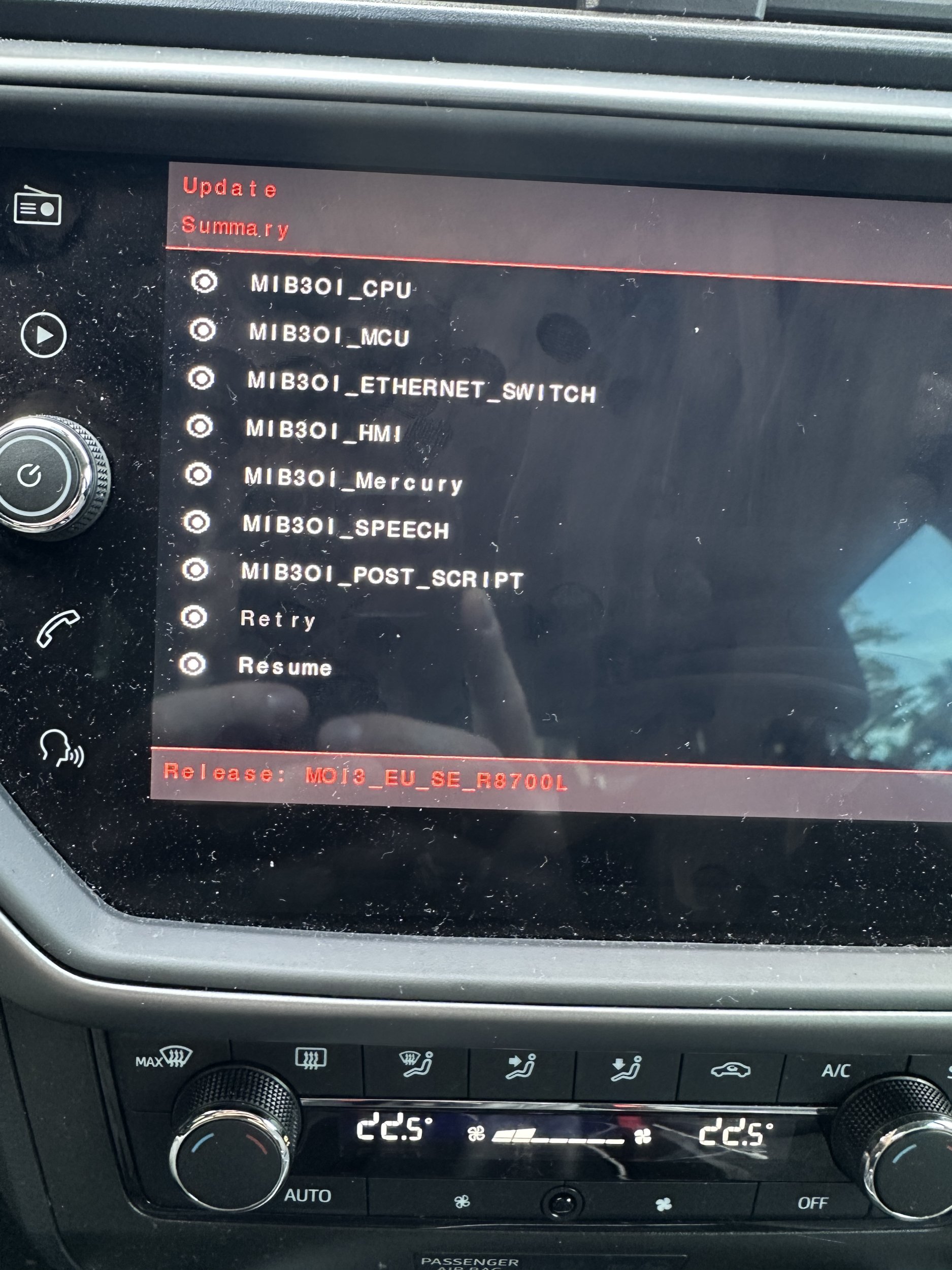

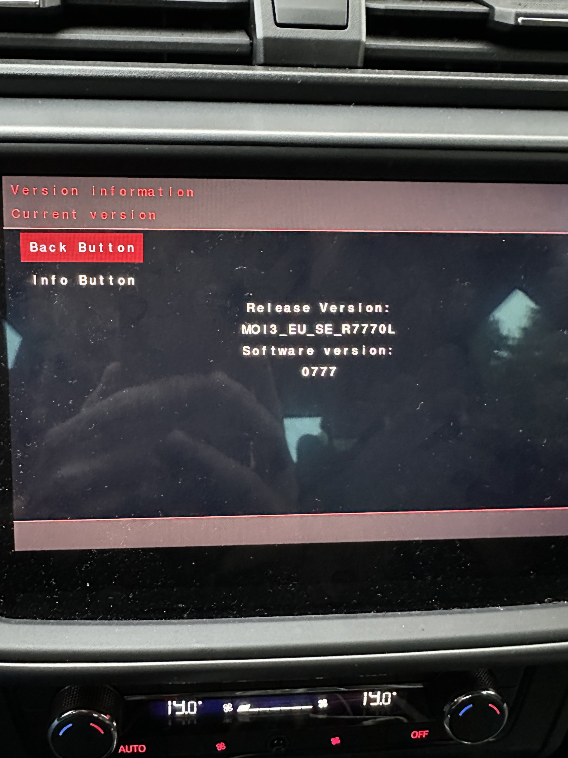

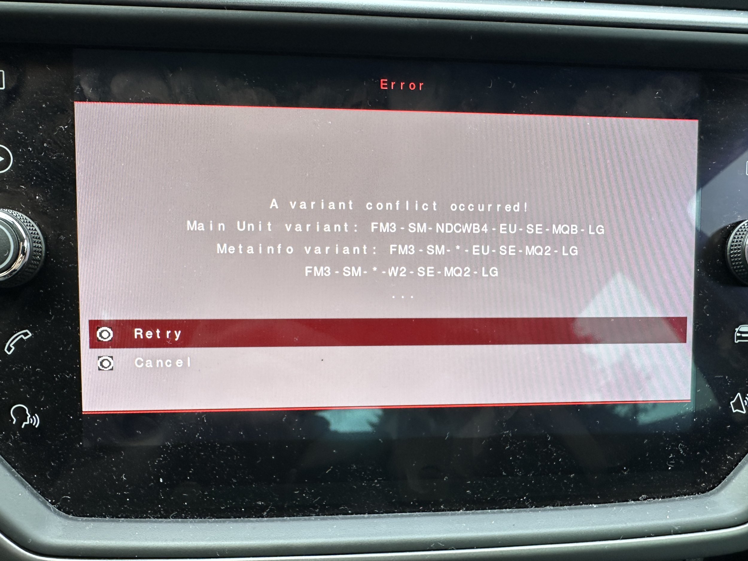

Hi!
I tried all updates available from MIBsolutions, but no succes updating version 777.
stays on 0777. I get the variant mismatch error when updating, even when I try older versions of firmware in between the most recent firmware.
the problem is, apple maps/google maps forces turn-by-turn navigation/route guidance behind the steering wheel, even when it is cancelled/disabled/ showing milaege information etc, it pops up whatever I do.
Help would be greatly appreciated.
thanks for the fast respons.
no OTA updates available, It did update once, but it still says 0777 firmware
Be aware on mibsolutions. Sometimes there are files that are missing. Or not complete as download..
