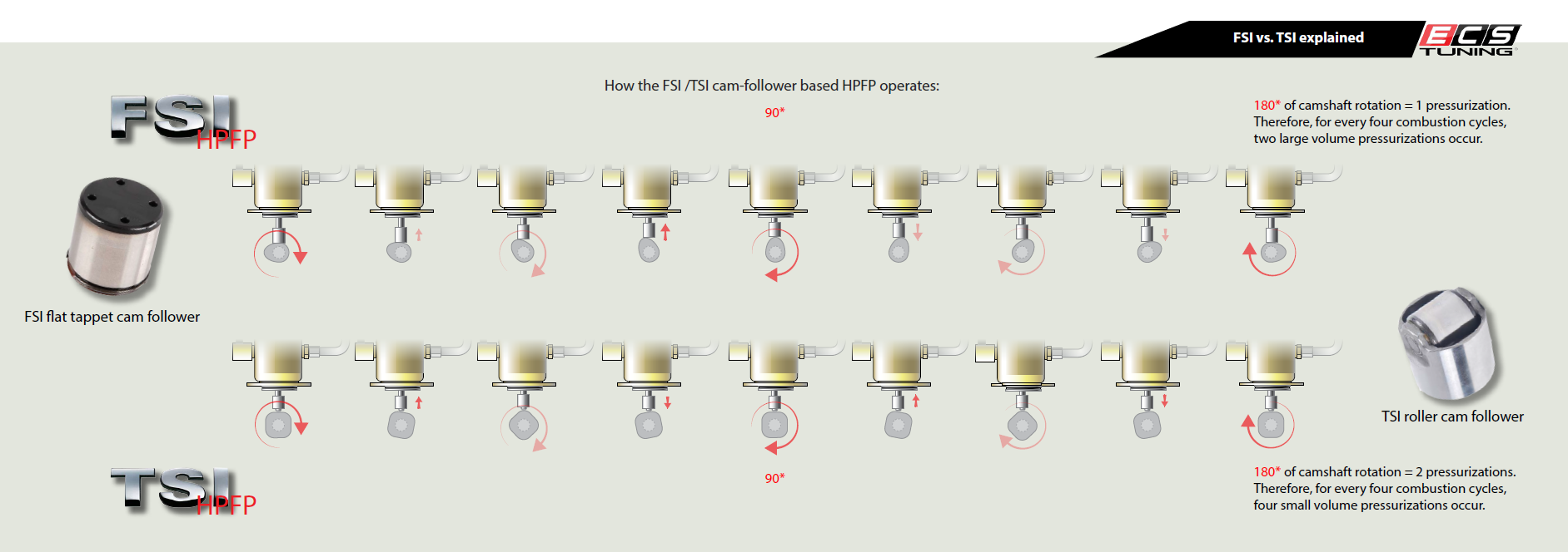

Yeah these engines (TSI) are roller followers, compared to the previous gen (TFSI) are the standard followers - bar the 2.5TFSI.
My thoughts exactly, many stage 3 cars knocking about now and I have never heard of engine failure - from the cam follower at least.
Its probably best to leave the original in which case
The diagram attached is helpful if anyone else comes across the same debate. Its easy to see why the TSI was updated to this
Cheers
