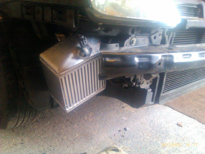

Ibiza cupra fmic on my leon :)
fog light still there..
Sorry about the pic , upload from iphone..

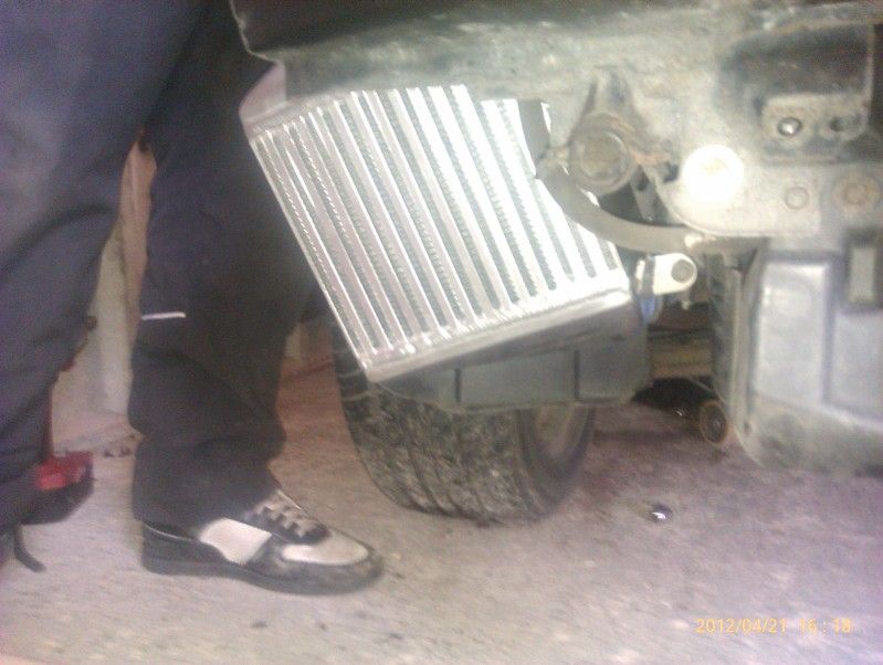

Im a tig welder so i fabricated the pipe work by myself
Pipe after a little upgrade :)
