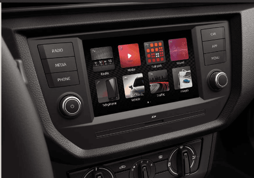

If you want Android Auto/Apple CarPlay, you may be able to activate it with your existing unit? On the main menu, is there a page for app link or anything like that?

Sorry it was early and my coffee hadn't kicked in- the name is 'Full Link', not 'App Link'!
When you press the Menu button, it should bring up a page of icons. If Full Link is listed there, then you can activate it using a code from the dealer, which will be a lot cheaper.

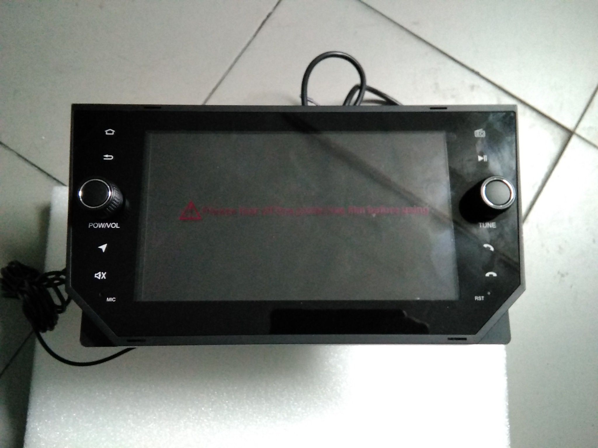

If you have the 5" radio you don't have full link I had that same radio. You have 3 options
1.original seat radio 9"screen,mib in glove box, other glove box, 3 new cables if mib is used you must remove cp
2.upgrade radio to 6.5" with full link you just need if (used) cp remove
3.you can buy android radio its just plug in.
