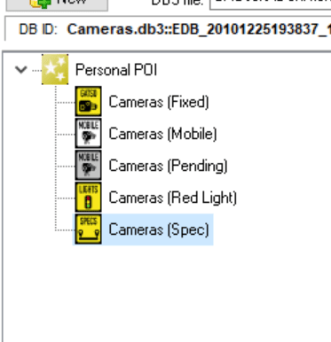

I started with a completely new setup and this way of structuring (Siblings) never worked with my MY2018 car:
I thought I was going mad, but then I tied the following structure (Child) and it worked straight away:
Not sure how you could set up the sibling route any differently. It just never worked. Bit I've updated my Cameras 3 or 4 times now, and the Child way always works.
It's suppose to be the top one. May be Radas altered the program so it's the second one now but works fine for those who have previously done it how he said before !. What you can't do is go mad an do what you could with the RNS units before MIB2. That is the instruction of hanging them off the route. You can't have siblings hanging all over the place in a big tree structure.

Has anyone with a MY2019 tried it the way I have it?
Once I got a bit of direction from @Maypack, the system is pretty easy to use to be honest.

In the POInspect0r manual, the developer talks about both structures. Although he does say.....
under the heading 'Discover' Units...
For these 'newer' units, it should look like this (according to this link). It then shows a screen shot as per @Tell's instructions.
The link, by the way, is to this thread ;)

At the risk of throwing him under the bus for not telling you :whistle:, here is the screen shot he sent me of what he uses:

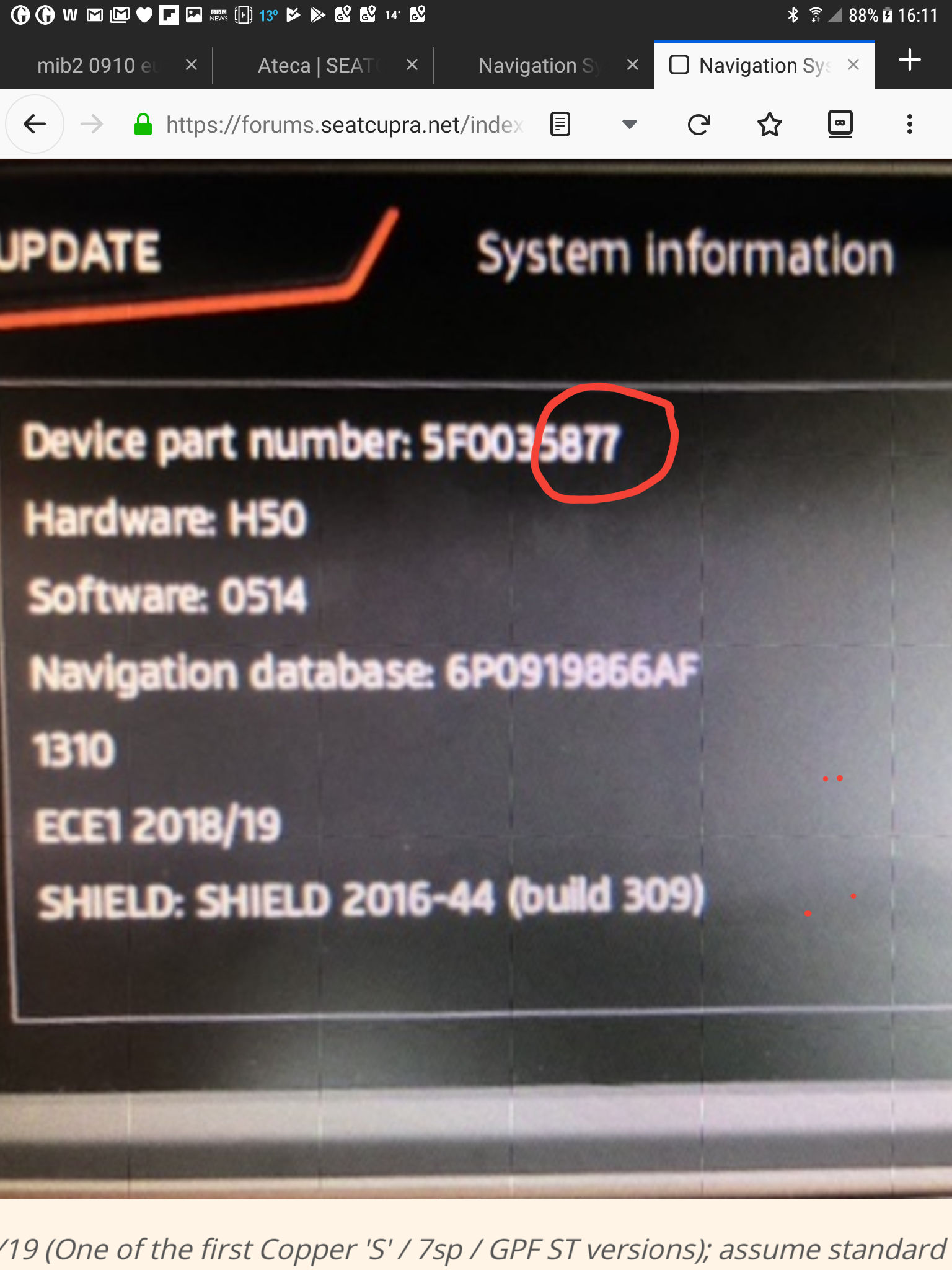

Could this be the reason so many new people with MY2019 can't update POIs?
No that's the hardware finishing in 877 and 877A, the standard unit with wifi. The Spanish board have led the way on that since the guy that manufactures the files from a Spanish speed camera database found all his user base getting their freebies from him were not working. He uses Radas program. So he pinned the issue down on Spanish Leon and Ateca sites. It goes threw to MY20.
There are other people with scripts that do the import but they all fail since nobody can import Pois on those units. Saying this I think its an incompatibility of the firmware with the device so it was never tested correctly with the hardware. The solution being via a change in the firmware but that hasn't happened yet as it has run onto the My20 units. Of course Seat says we don't support it if you read the Spanish thread referenced above.

Ok had a reply from Radas replying to which of the two should be used shown in post 100:
Both will work. Program export all Cat´s into root as discover unit does not support tree structure.
Btw docu is already updated by anyone from germany.
I have edited the document with the words "May require" since Radas says either but linked down to the recent examples above.

I'm very happy...... finally got it to work for me! :bounce:
I used the @Damo H / @Maypack way ;) Also. had to use an SD card.... wasn't happy with the USB stick, but it did like the icons. YaaaY

Well Radas says either method in post 100 works but given the second has more recent positive posts I'd go for that. I'd test the first method again with the more recent update of the program, but the thought of fiddling around to construct that again put me off when I have something working. Basically that part of the program is a graphical interface to create the structure of the database file. That may have changed but we are told not.
Once the database file is created you populate it. The icons wherever you get them from need resizing to 39x39 if they aren't already. I provide one way of doing that in the text, there are others.
