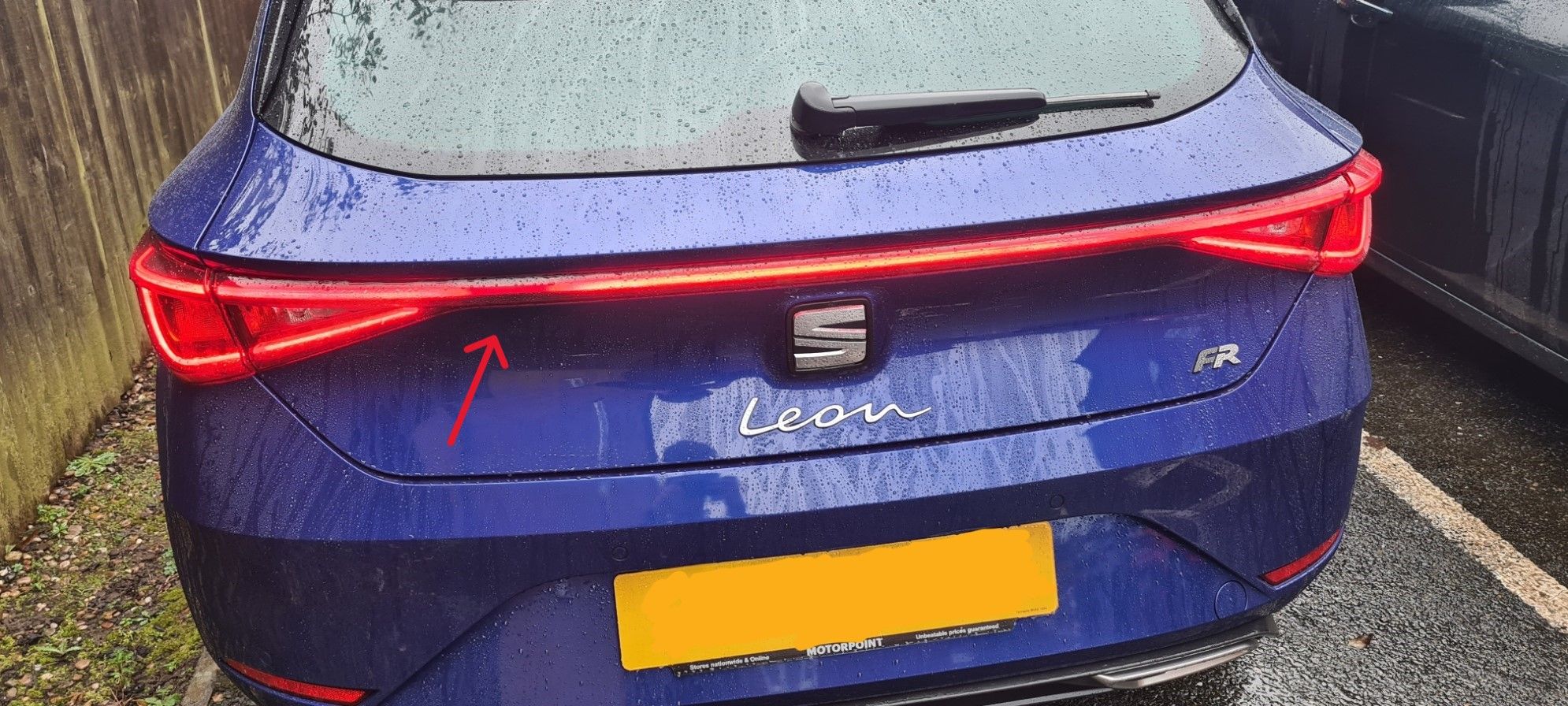

- Possilbe single LED broken on the rear light (picture below). Anyone had any issues like this, do I need to replace the whole light? I don't think its included in the warranty from the dealer but is it worth asking anyway?
