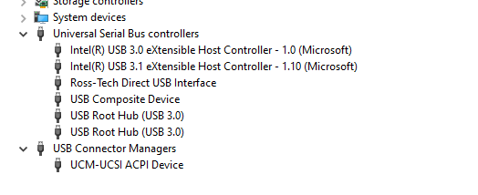

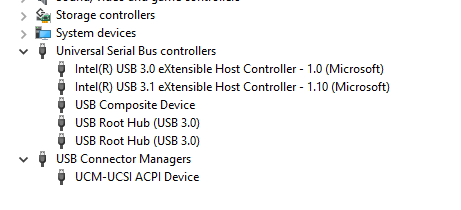

Ok so I tried the cable in all 3 USB ports (2 x blue and 1 x black). It did not register in the black port however it came up in the Devices section:
I opened the properties to check it was working:

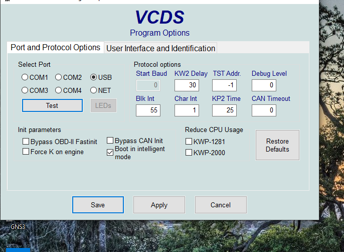

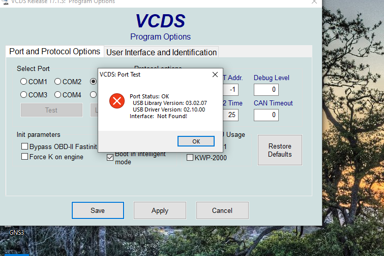

I thought OK it’s seeing it so I ran the VCDS but got this message:

So a wee update:
I couldn’t get the supplied software to work on laptop so tried it on my Mums desktop PC and it loaded OK
Contacted vag-diagnostics who then sent a link for an updated software, this worked on laptop. Now I can’t get the cable to read when connected to OBD port
The cable registers on laptop, I open VCDS and run a TEST of cable and it registers but says nothing connected to car’. When I connect the cable to OBD port and turn on ignition there is a green LED lit up which I would expect, however, every time I try to read or test I get the same error message:
Anyone had this or can help (vag-diagnostics are not the most helpful )
