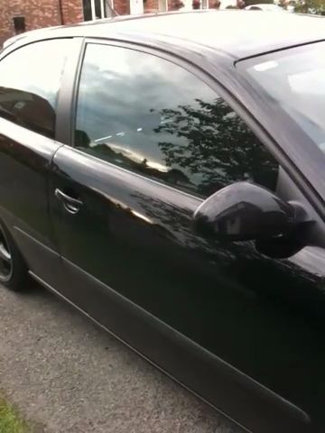

As far as I know turning lights can be done on the Mk4, nor can auto windows off the fob (though the car does do it with the key in the door) without a KVW100 module.
What do you wish to do with the central locking?
Some things I have done include adjusting the steering weight (to stop twitchiness at motorway speeds) and comfort rear wiper, as well as some key coding. I believe selective unlocking and auto-locking can be done if you wish.

Central auto locking - I believe if you haven't already got this, you +32 to your existing code.
This link provides a good amount of information about what you can do with VCDS on the Ibiza. The link mentions Golf/Jetta/Beetle but most of the VCDS related coding is the same as our 6L Ibizas.
This link provides info on adjusting the steering weight. I think I set mine to 000151 but knocked it down to 000141 (or 000131, can't quite remember now) as my power steering started making a bizarre revving noise on the higher setting. It doesn't do it I now I lowered the setting a bit. It started originally on 000121 and it's better now.
Remember, before changing any coding, always make a note of existing coding first, in case you have any problems. This way you can always revert back to your last known good setting.
