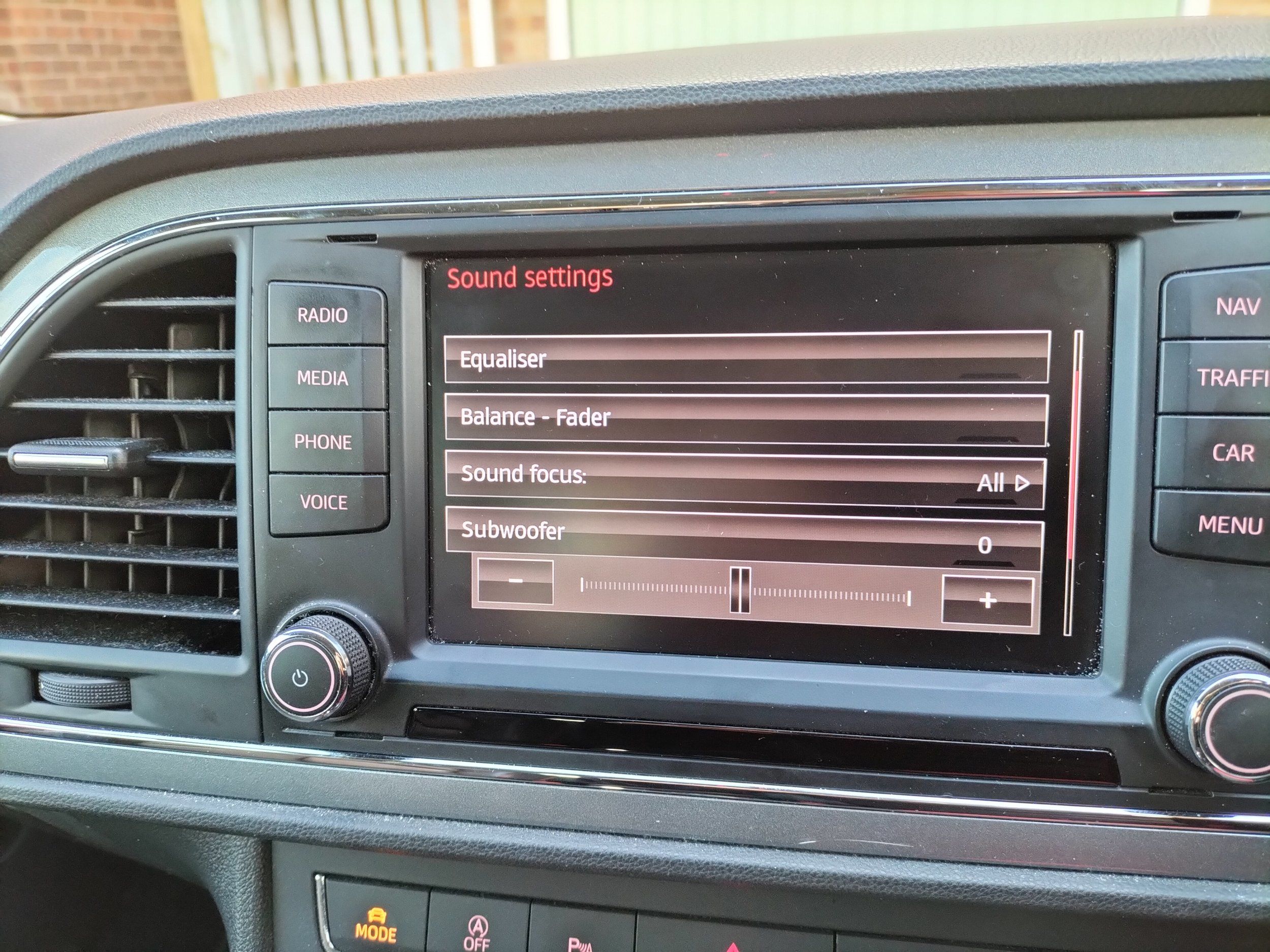

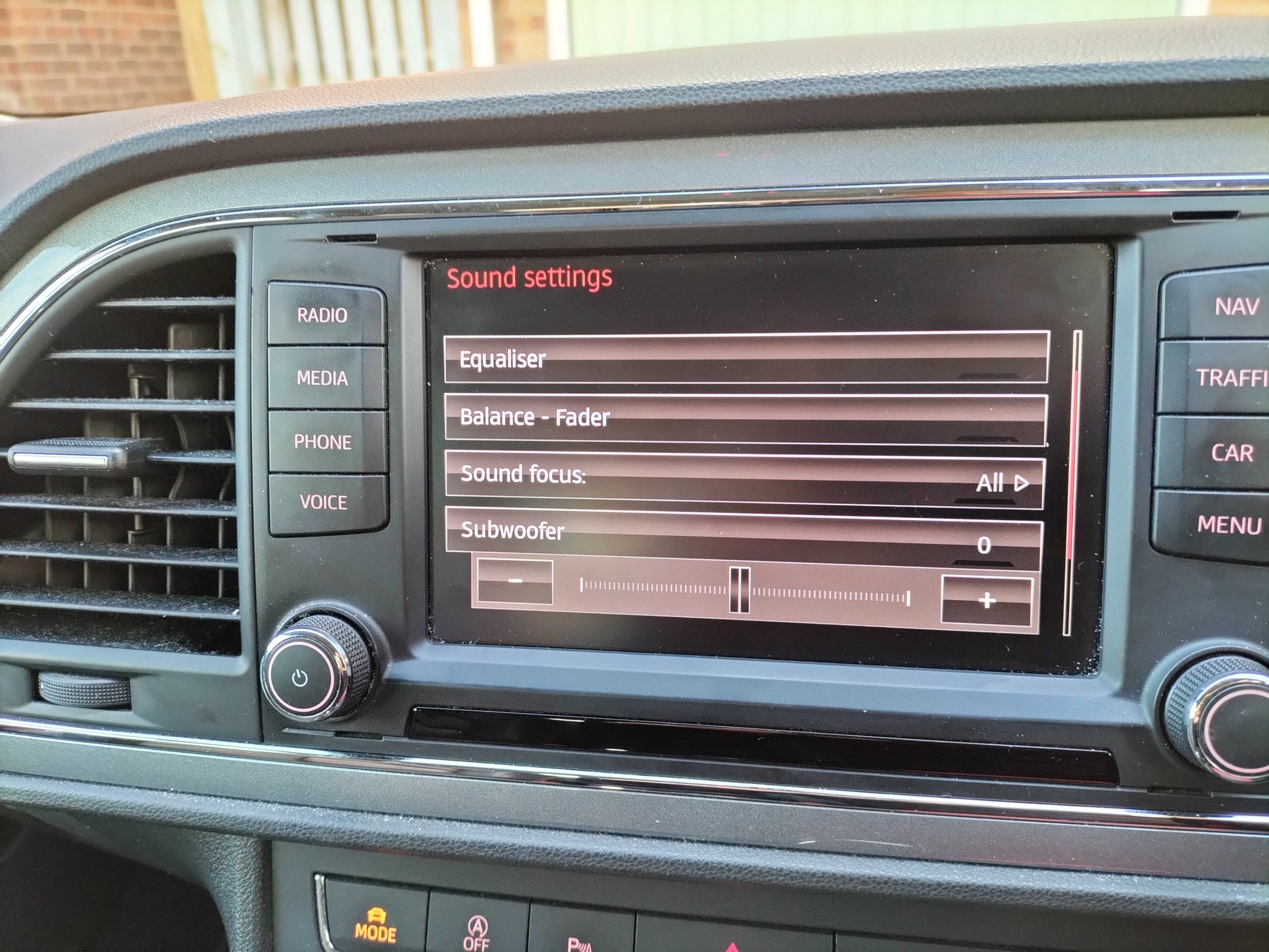

i have managed to apply seat sound to a mib2 technisat unit with just the use of carscanner app pro.
i stumbled on this thread which gave hope without having to get vcp and zdc files like i did with my first mib2 unit.
https://www.audi-sport.net/xf/threads/436166/

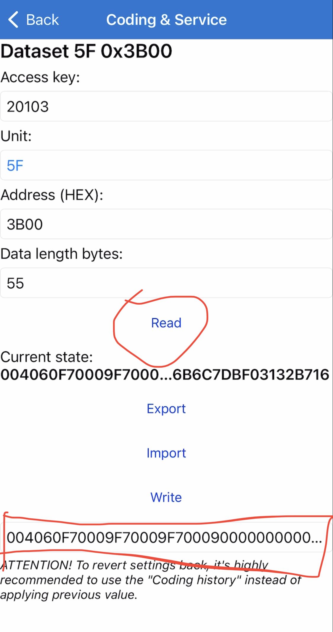

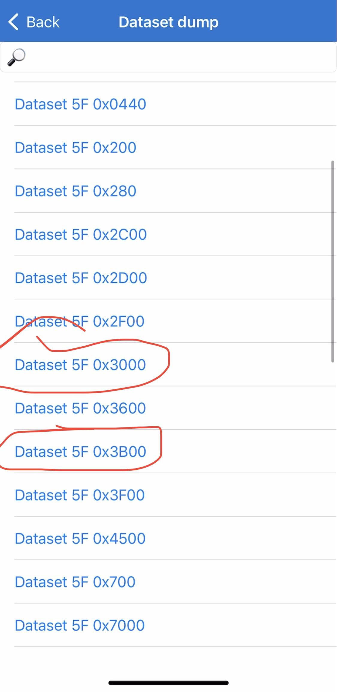

however why go to the trouble of editing datasets when i already have the correct ones from a vcp patched unit already, so i just copied the data sets from the enabled mib2 unit and wrote them to the new unit and it worked.
i used a vlinker mc+ ble elm327 unit and carscanner pro. you can also add fec`s with this too. its bloody brilliant.
just replace these strings for both data sets with seat sound ones.
  • 0X3000 seat sound enable mib2 technisat-preh .txt
  • 0X3b00seat sound enable mib2 technisat-preh.txt

No, car type is a different setting. This just activates seat sound where it splits audio and gives the subwoofer setting.
Car type you can change after, let me know if it works, make a backup of the string you currently have also before changing.
Backup done and checked against your files above in Excel - same length but lots of changes (283 bytes changed in 0x3000, just 4 changed in 0x3B00)!
Will give your files a whirl in a few minutes..

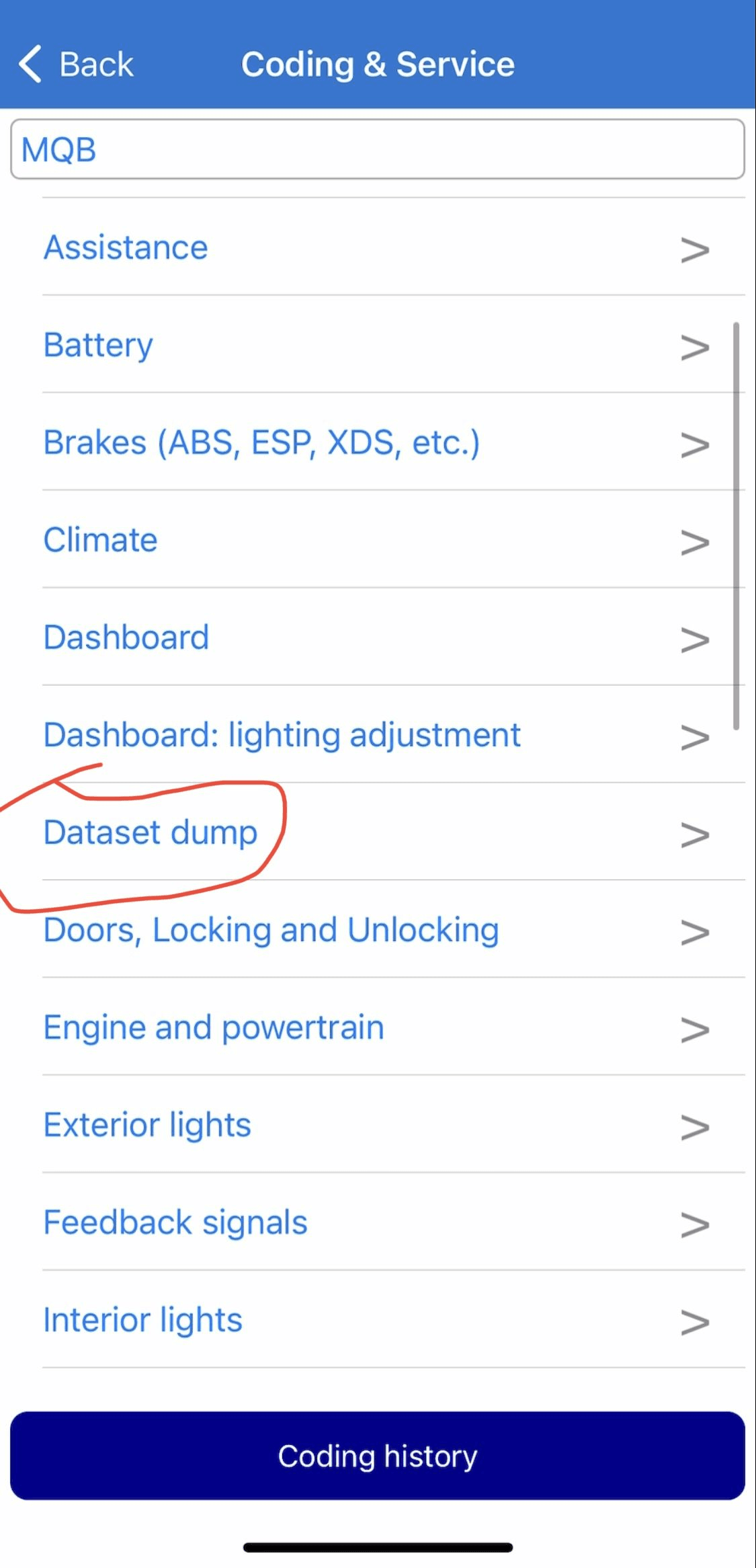

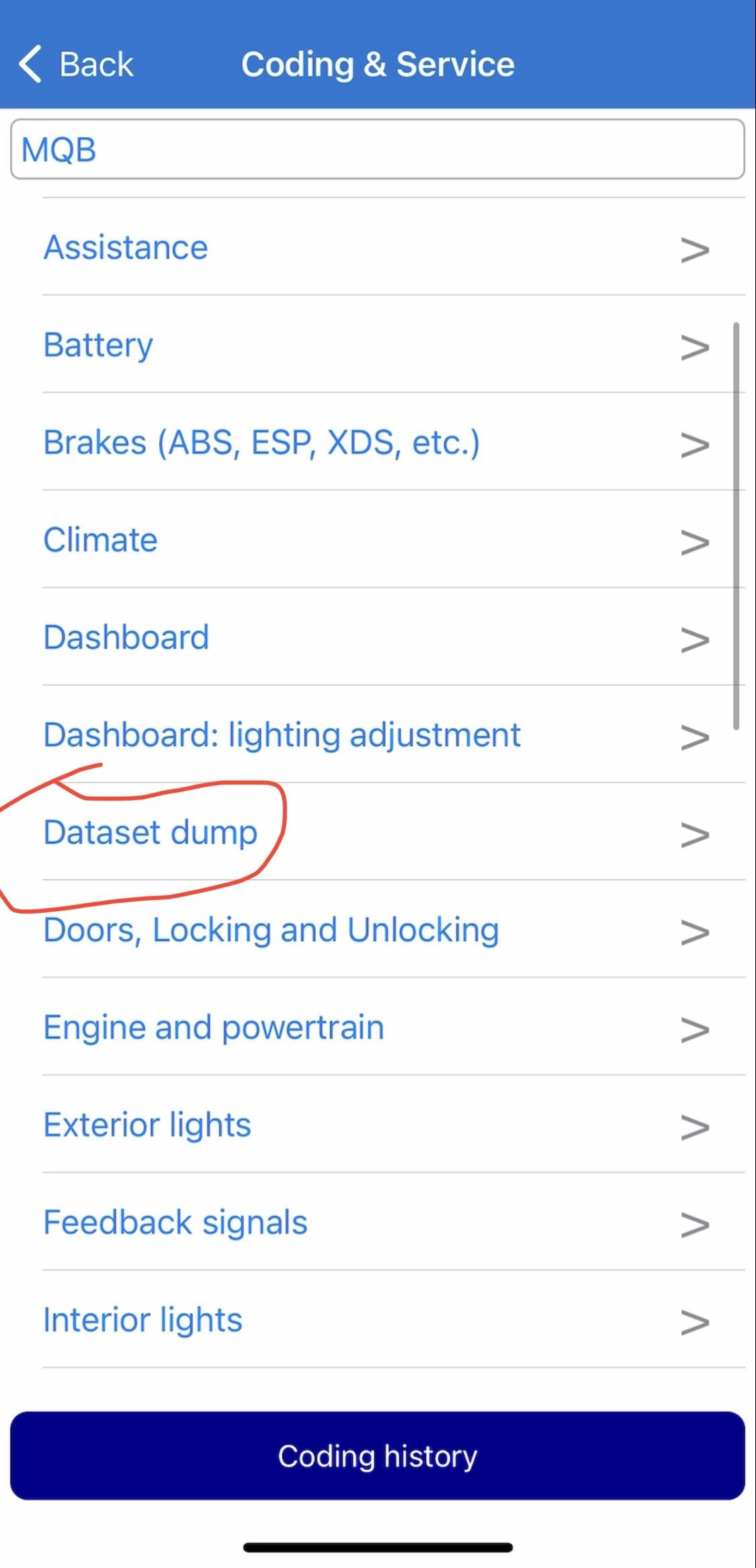

Hi ive done mib1 swap to mib2 and i lost my subwoofer control menu, i wanted to use car scanner pro and add it back, just like you. When i connect with Car scanner pro go to coding i have no option such like dataset dump, am i doing something wrong with connecting or whats the reason.

Worked like a charm!
