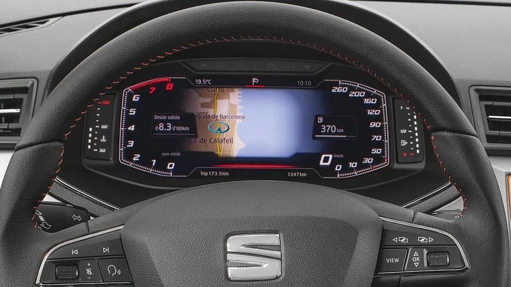

I bought a Leon Cupra 2018 today, but I do not have this display option on the virtual cockpit.
Is there any way to add it with VCDS?
Thanks in advance.

Sadly not.
You'll have the original unit, the unit in the picture is a Rev A (or B) and includes different software. Its not possible to update the software to the newer one (suspect as the old unit won't have enough memory/storage), as it has 2 extra screens (the one above and the central rev counter).
Can it be retrofitted, yes, but 1) its expensive (talking £800 plus fitting) and 2) second hand ones can be problematic due to programming the mileage As only new ones can have the mileage set correctly.
@East Yorkshire Retrofits did mine back then and have now become a sponsor :) They made sure the upgrade was all registered with VAGs/Seats systems etc. So if you want to splurge I recommend them :)
