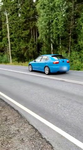

Did some minor tweaks and every one like to use NLS (shift cut) so I decided to go different route and used "mild" settings for Anti-Lag to ease gear changes
Sound good and works but I think that I can not use that aggressive ALS on track, only if I will go to do some 1/4 mile events.
Enjoy, at least I did :D
