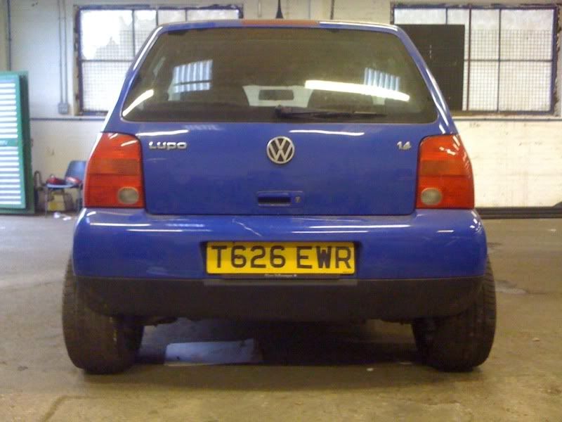

Middle of last year it became apparent that I was going to be in need of a new daily driver, with the Alhambra to be gotten rid of end of the year and the Cordoba being taken off the road. after a bit of searching I found this VW Lupo going cheap on eBay and swiftly bought it.
Only did I realise when it turned up on the back of a car transport did I realise the reason why it was going so cheap, and the decription of the bodywork being described as 'good' was a bit optimistic....
But hey ho, it was here and the work commenced!

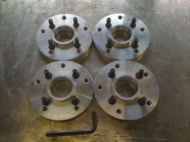

Sourced some 15mm thick adaptors .....

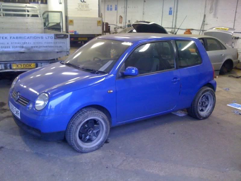

Comedy shot of wheels with the 944 sized tyres & standard suspension

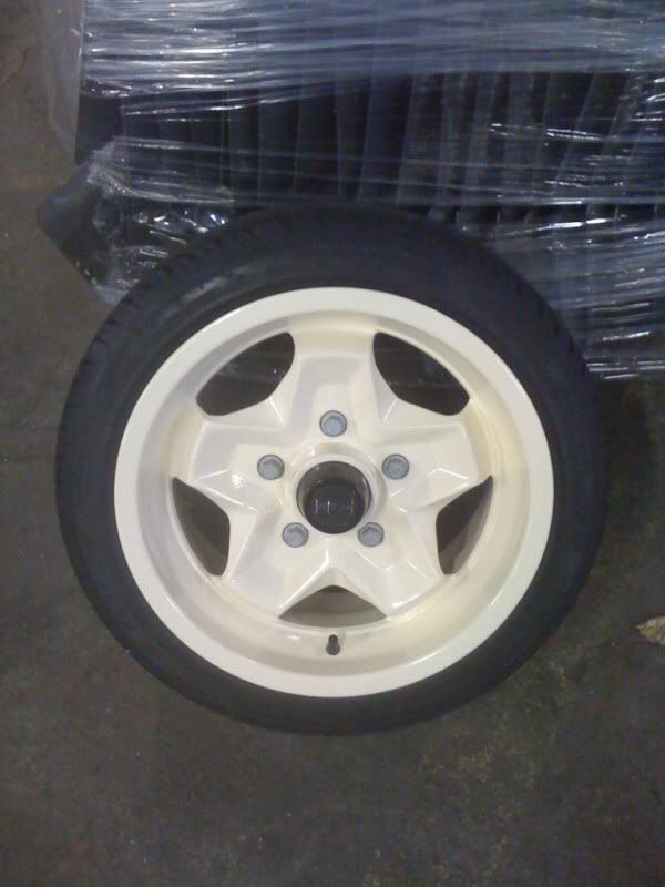

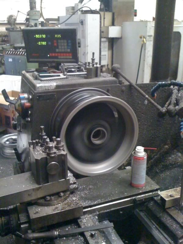

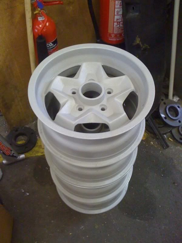

The wheels where in pretty ropey condition with all of them with kerb damage on the outer rim, I filled and buit up areas of damage with weld and had the lip machined flat by a local machine shop
Pretty much convinced myself to 'not' go down the polished route as its me we're talking here:rolleyes:, so after an hour or so in the shot blaster at work they were ready for painting by the powdercoaters next door.

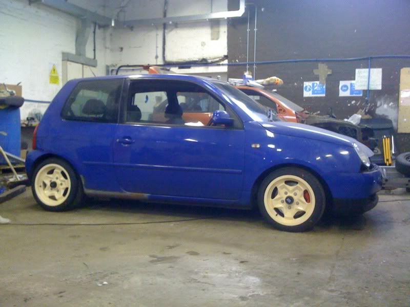

Colour chosen, 185/45/15 rubber and to be a bit different over the Porsche centre caps I spotted those little beauties when ordering the wheel bolts from machine7.com.

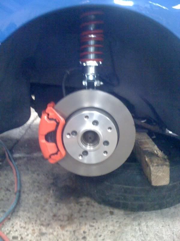

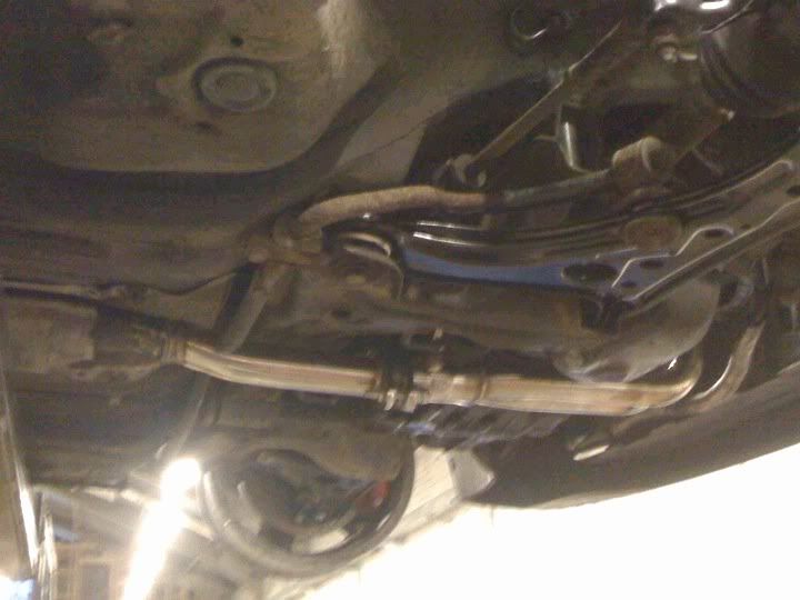

Next up was to give the suspension & brakes a once over, on inspection the rear shocks were weeping so it was good enough reason to order a set of TA Technix Coilovers from Germany and new wishbones & balljoints. The 239mm brakes were changed in favour of considerably more effective 280mm discs using hubs from a mk4 Polo 16v and calipers & carriers from an Audi A4, with braided hoses & Super Blue fluid.

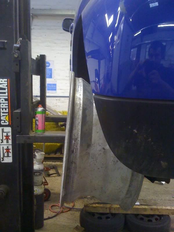

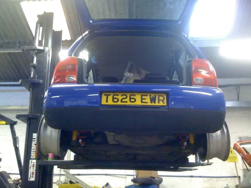

Turning my attention to the rear suspension, because of the offset of the wheels + spacers being like ET7 the tops of the tyres were going to protrude the car, to get around this problem I hashed up my own home made camber shims, giving me in the region of 4 degrees :blink:

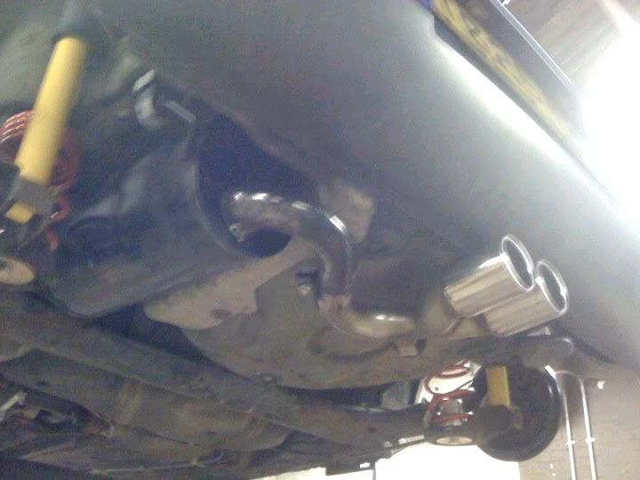

The the old exhaust was looking in dire shape and was fortunate to stumble across a Jetex sports exhaust in mild steel on Club Lupo, especially as the guy lived 20mins drive away
With the back box being in the usual place and the tailpipe being in the centre means a convoluted route for the pipe, which sure as hell does nothing for the flow of it!
If you thought the tailpipe arrangment was odd, the pipe diameter from the centre box to back being 70mm!

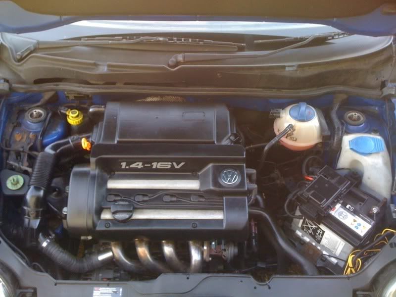

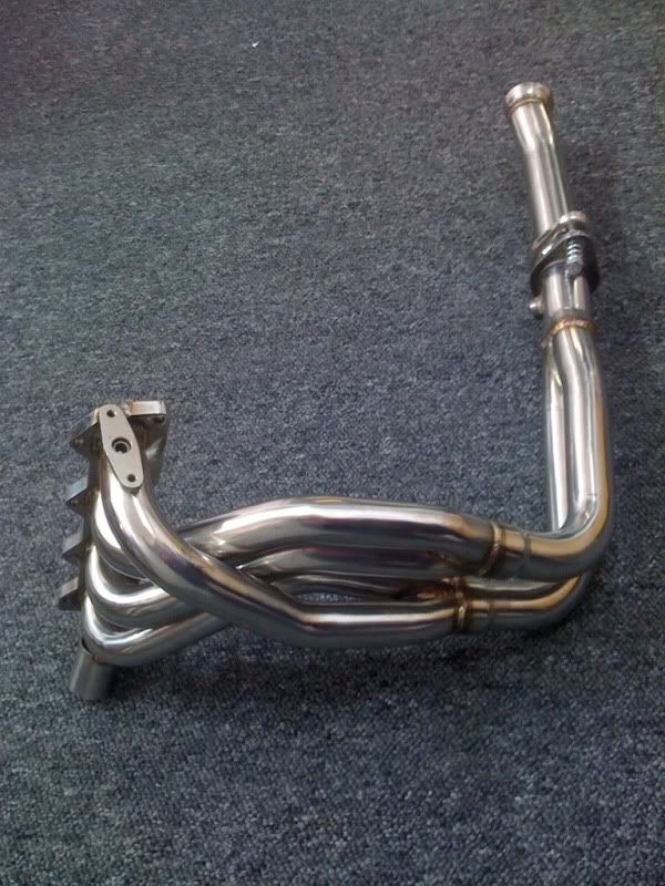

To finish off the exhaust a raceland Manifold was sourced from germany, originally meant for the Polo it needed a bit of adaption to fit to get it to line up with the rest of the exhaust and the lambda being in a different place

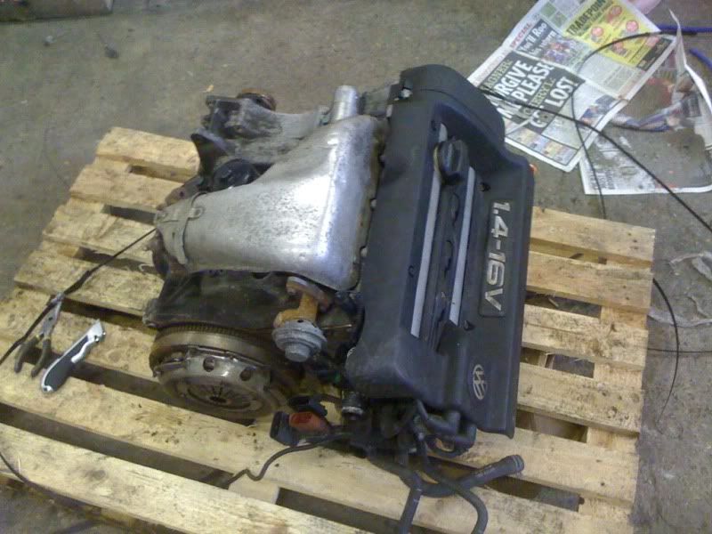

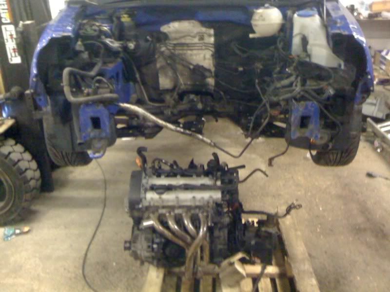

Meanwhile, a replacement engine was found and whilst it was out the car I changed the cambelt & tensioners, waterpump, thermostat, Hydrualic lifters, Spark plugs, Oil & filter
Old engine coming out along with the gearbox, with the tight confines of the engine bay it was easier to remove the whole front end and lift the car above it, putting the engine back in on me own wasn't as straight forward!

Engine back in and a quick clean up, shiney manifold discoloring nicely :)

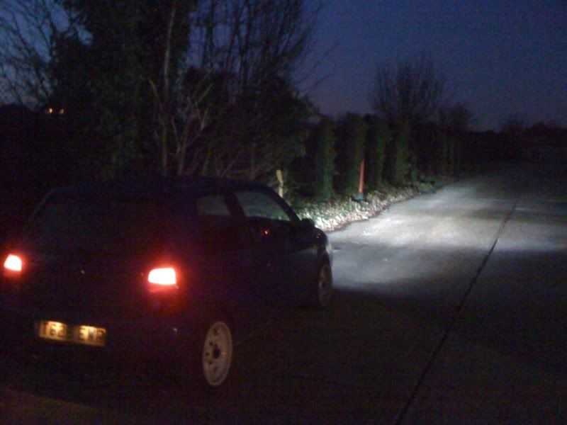

My favourite tweek of the car, H4 6000K Bi Zenon HID's. Lights up the road a treat :D

I think it suits those wheels very well. :thumbup:. H4 Bi-xenon hids definetely light up the road well :D. Does the manifold make any sort of difference apart from the look under the bonnet??

Just the body work, it's had lots of bodged repairs and dreaded tinworm, no idea what difference the manifold makes as I never drove the standard one.
