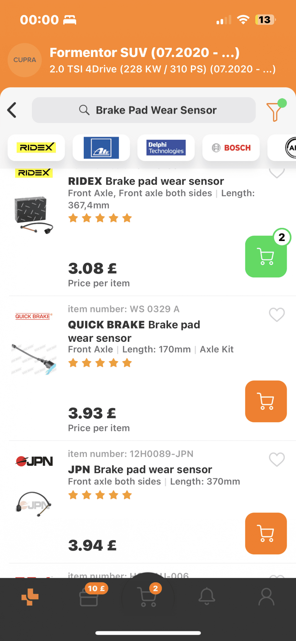

Hi all,
Just joined the forum.
I’ve just had ebc yellow stuff installed on the front of my vz3, however the pads didn’t come with sensors
I’ve searched for the correct part online and get quite a few hits of different brands from brembo to ridex at various prices.
Presumably any of these sensors will work/fit?
any advice appreciated.
thanks

I managed to get the part number for the brembo sensor from my local garage.
£60 from Cupra, £11 from a parts distributor
if anyone needs it the part number is 8J0615437
