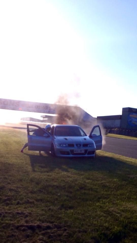

Unfortunately yes. It happened at last nights track night at knockhill. The turbo let go in a big way afaik and spewed oil over the full length of the exhaust which then went up in flames.
I have a pic of the aftermath but I'm not putting it up in case Garry doesn't approve.

Onto the straight, noticed some 'steam' out the exhaust. I'd been having coolant temp issues all night so wasn;t particularly surprised/worried by this, until my passenger started screaming about flames and had no boost into 4th gear :(
So as above, the turbo let go, and oil poured into the exhaust, which at 1000 or so degrees, thought a wee fire would be nice.
The pictures make it look fairly terminal but its honestly not that bad.
