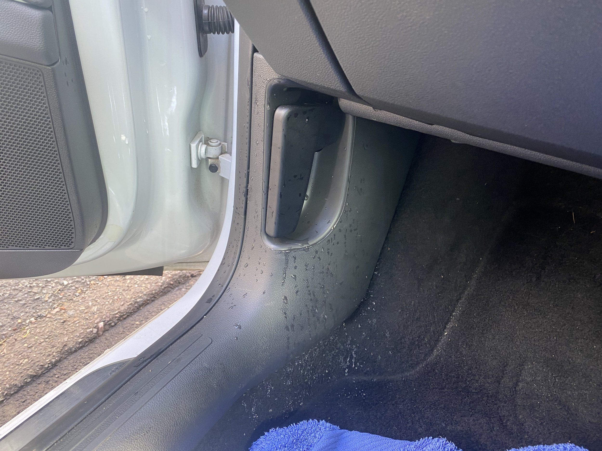

so over the last week we’ve had some really bad rain here and last week I noticed I had some water droplets on my bonnet release lever. At the time I thought nothing of it as my girlfriend had just been in the car and I thought it may have just been off her shoes.
so fast forward a week and I get a yellow warning light saying “Error : Airbag”. Following this I went straight onto YouTube and had a look where I came across the wiring looms at the bottom of the passenger seat, so I thought I’d give it a go. This is when I found the passenger side footwell is wet through. I’ve read so many things on the internet in the past few days but none specific to Seat’s. I managed to get a photo of the drip so I’ll post that below, just wondered if anyone has any idea on where to start? Thank you so much.

However it rained again last night, and it happened again. Cars booked into a VAG specialist on Tuesday so I’ll keep everyone updated. The water seems to be coming through the hole for the bonnet release cable, so maybe a bungs perished or something like that.
Just got back from my local garage, they seem to think the waters coming through the windscreen since it’s not the original Seat glass indicating that it’s been changed. Booked into the VAG specialist tomorrow so hopefully will find out for definite tomorrow!
