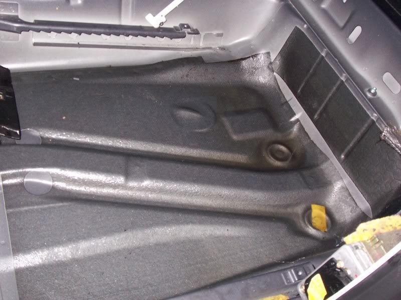

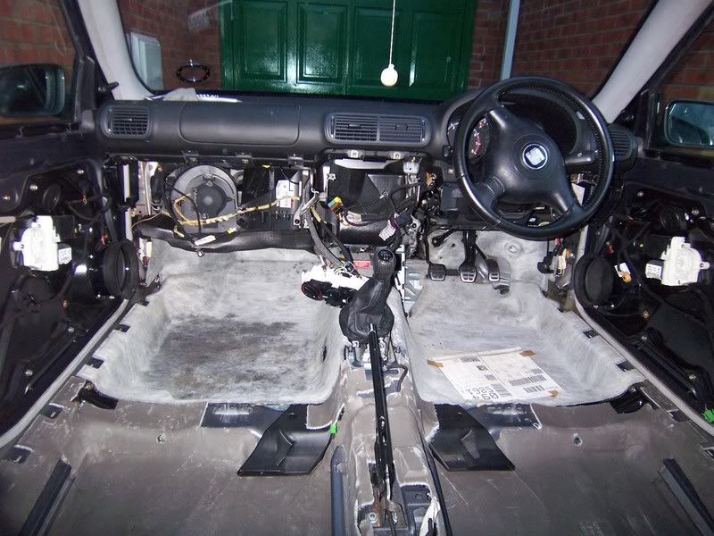

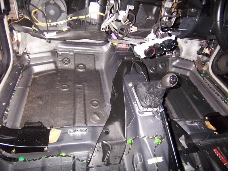

while i am away, my baby has been stripped because of the water problem!!!
will post pics tomorrow, it is gutted...the problem with wet carpets is that you will find the sound proofing is like a sponge!!! you can wringe it out!!! (thats under the carpet!)
