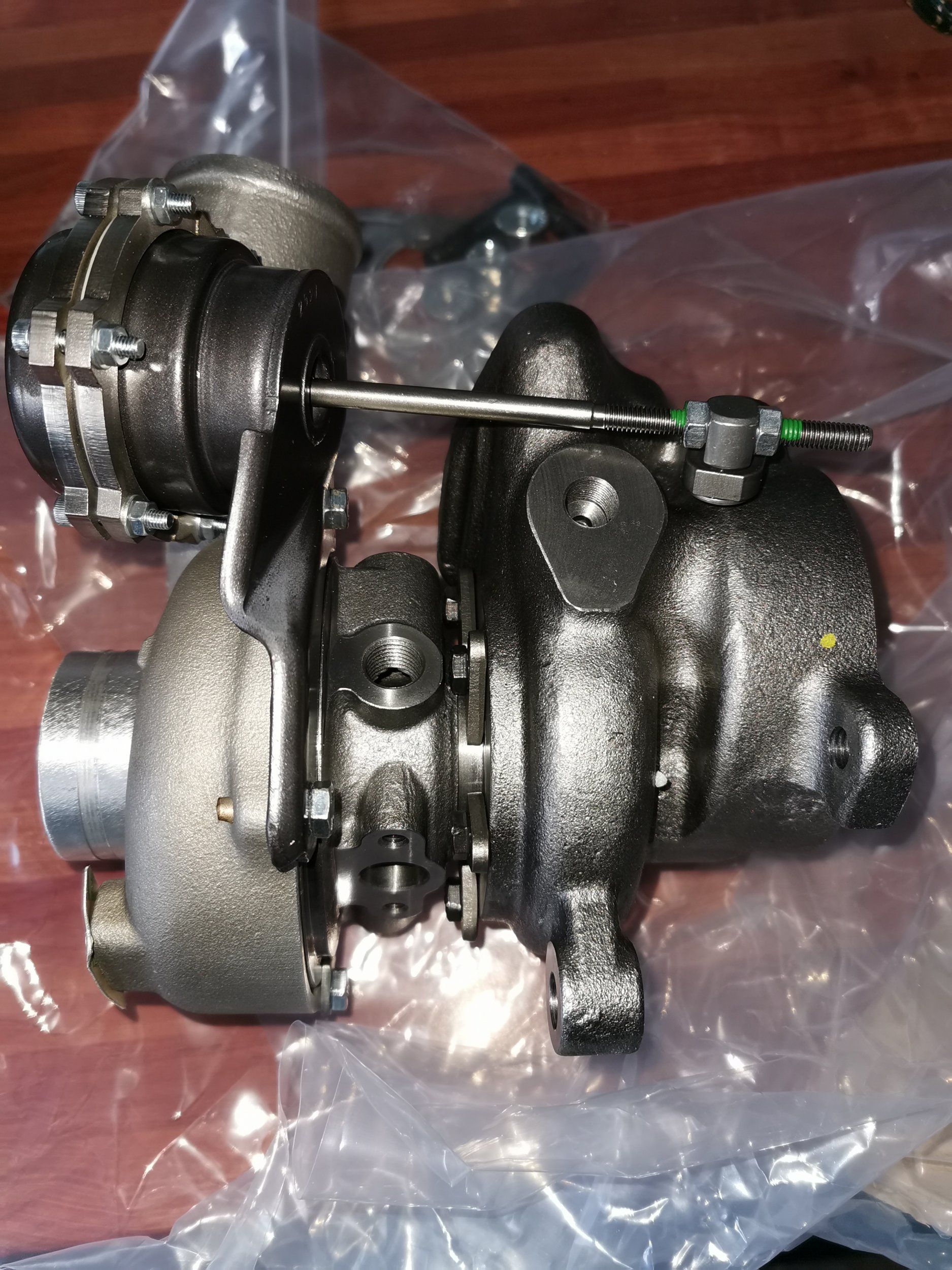

So how do I get this
In here
Unfortunately I've failed already ! - Cannot get the top downpipe to to turbo bolt undone , the O2 sensor is in the way of even a 4inch extension and the manifold is in the way anyway.
I was hoping of taking the manifold off but you cant even do that as the downpipe is in the way :givein:
So an update and a warning - This is NOT a DIY or even an enthusiastic amateur mechanics job !! - You need special tools and the ability to lift the car pretty high and safely .
You cannot remove the exhaust manifold as I was hoping/thought possible/led to believe and therefore cannot get at the oil feed and water cooler union's undone.
As per my other post in General topic's now looking for a mobile mechanic in a hope they will have better luck.
Morale of the story even if you think you can DO NOT attempt this on your own !!.

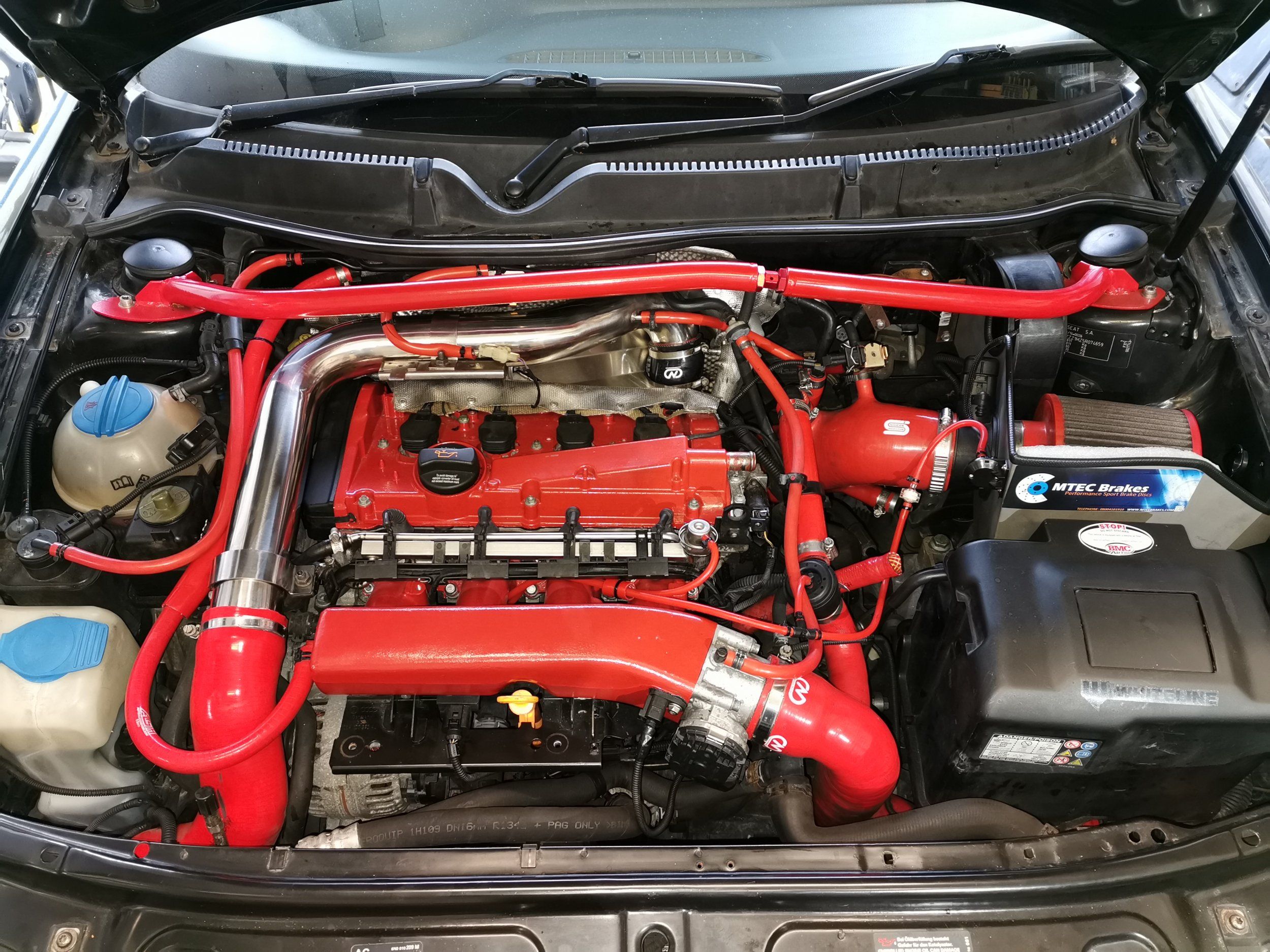

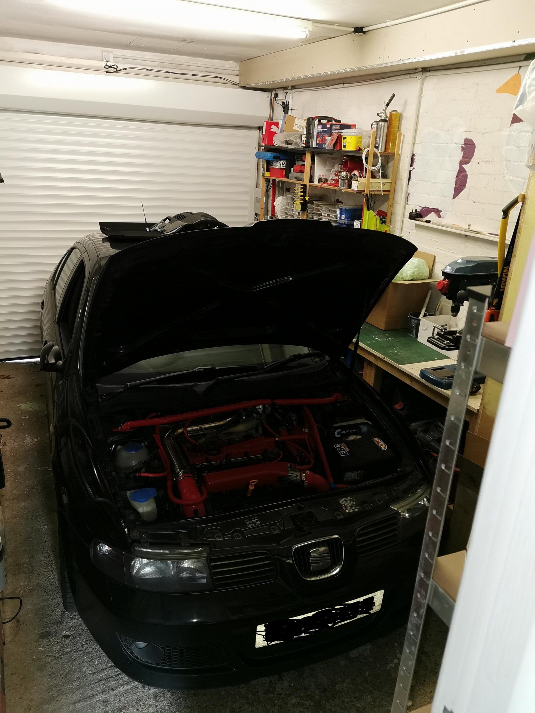

yup - early xmas present from wife n kids. - Took 6 hours in total yesterday - Yes it does quite easily come out the side/top. I have a video but its in mp4 format so cannot upload direct to forum.
Engine bay not finished yet :) - Have a bit more tidying up to do and some more polished stainless to go etc etc - Am going to wait for a bit now to recover stress levels/patience and missing skin.
Starts and runs but not driveable as N75 split in half - Cheap junk "EMC" branded "C" version so not even the right one for the car.
Catch can not fitted because of the above......just cant wait to drive it now - or might just leave in the garage now I know it fits :)
