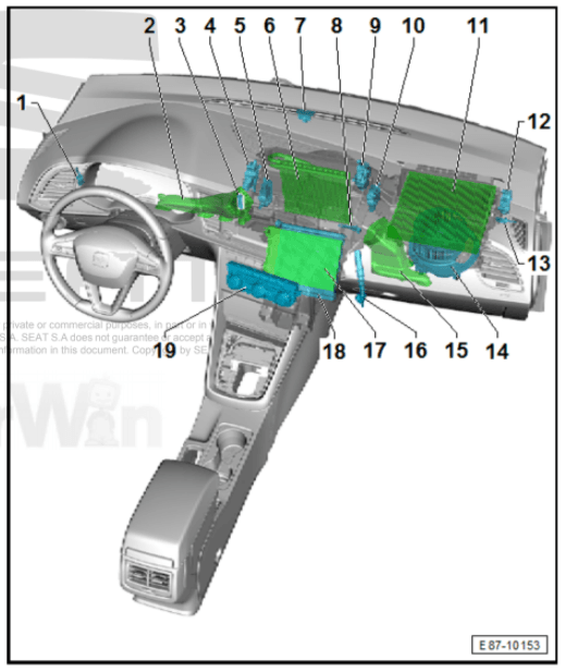

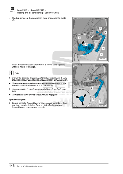

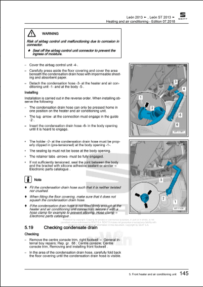

It's not the refrigerant that leaks - its the water from the condensate drain (part #16) i.e. the water removed from the cabin air during the dehumidification process (note, some of the components are reversed in a RHD car, i.e. dust and pollen filter (part #11) but I believe that the condensate drain remains on the driver's side on RHD):

ask them to check the ac drain pipe under the drivers footrest to see if thats the cause
