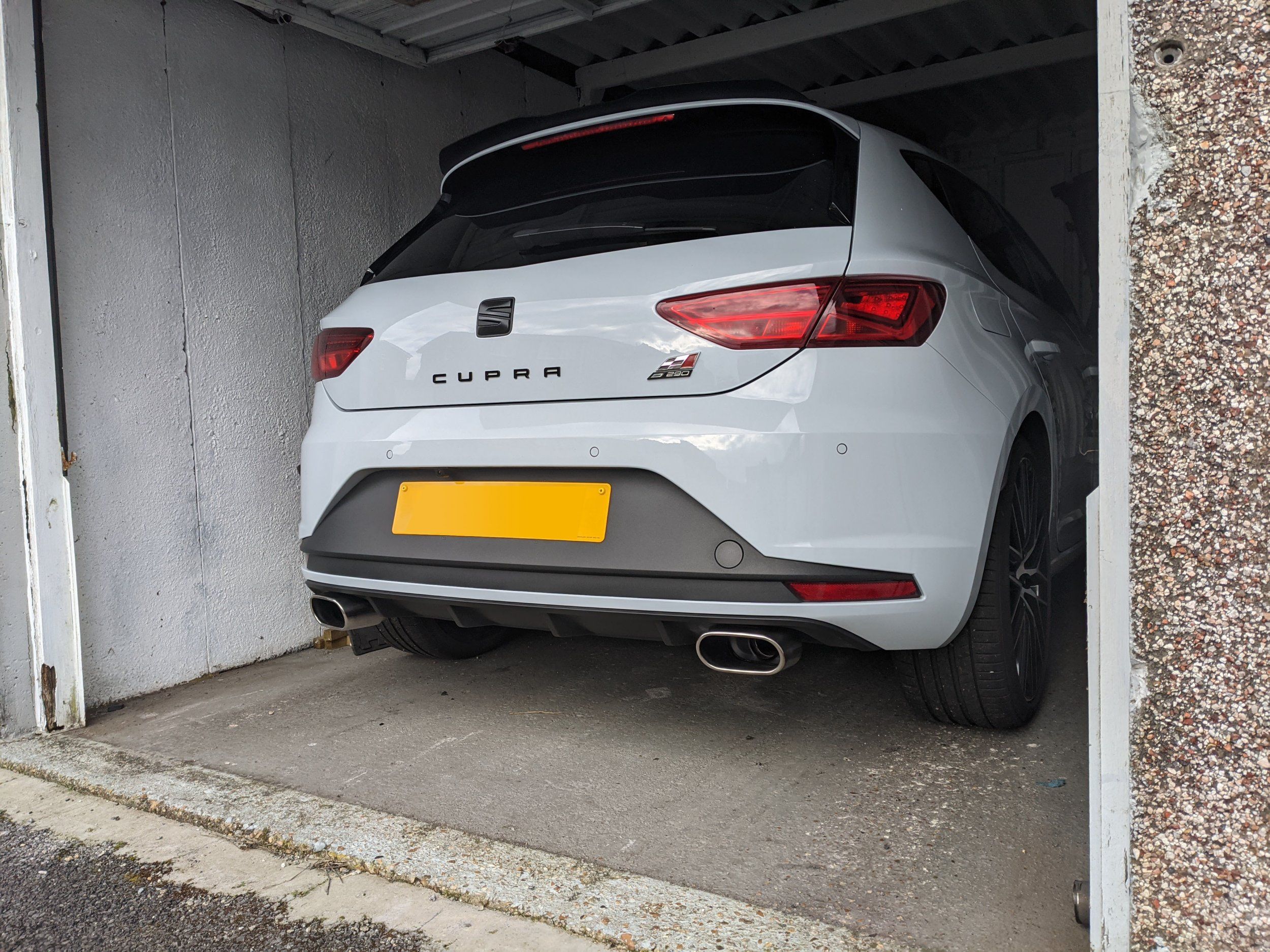

So I was inspired by your "aero kit" posts and I went on to order the rear left exhaust cover (5Q0825206K cover for independent rear suspension) and the 2 front arms covers (5wa407117&118).
I have to report back that none of them is plug n play on a MY2019 Cupra. Actually the arm's covers do not fit at all and nothing can be done on them in order to fit. The overall shape seems correct but the holes for the rivets don't match those of the arm. That's really weird since according to my research all Leons 5F are fitted with the same arms no matter the trim level. I will give it one more go when I get the chance to have the car lifted.
On the other hand the exhaust cover can be fitted but again it's no plug n play. There are obvious workarounds to make it fit and I had to use some hardware of my own and one bolt that also holds the silencer heat shield.
