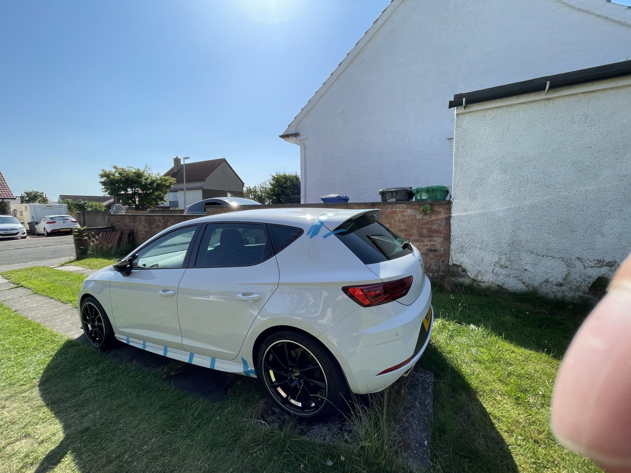

Aero side skirts & spoiler fitted, take the tape off tomorrow then good to go!

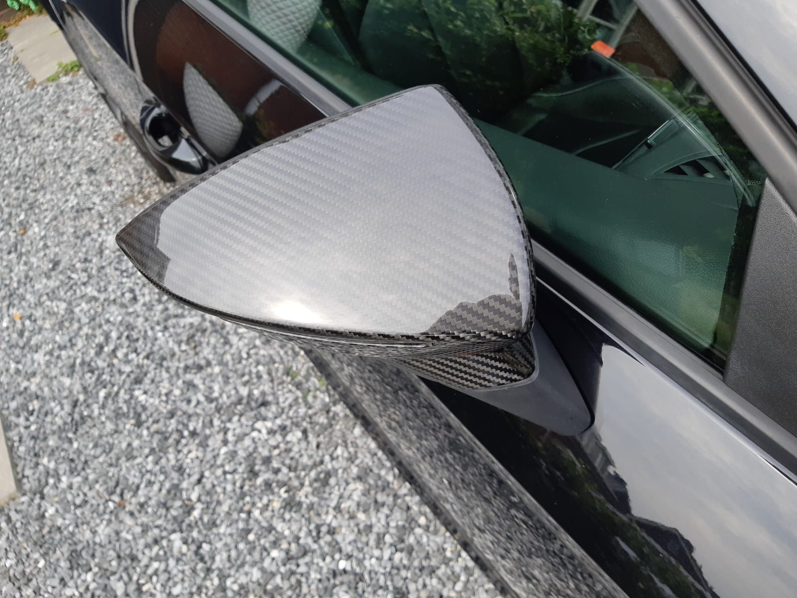

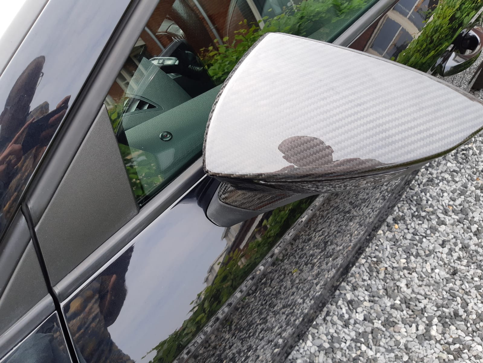

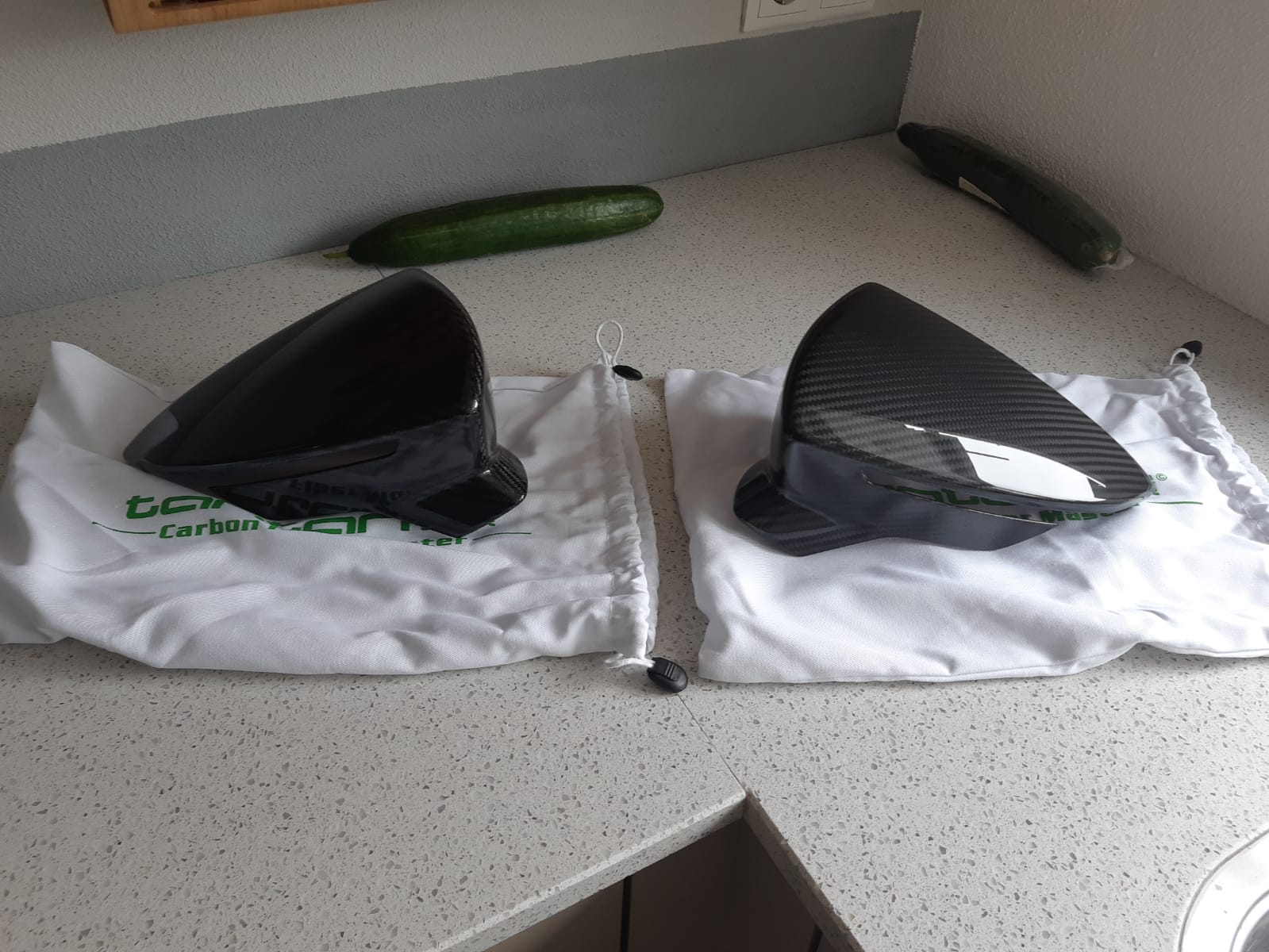

Stick-on fit great and mounted solid.
Have you got a link to them?
Been looking at them for mine but unsure about stick on covers, that said those look really good & look to fit spot on.

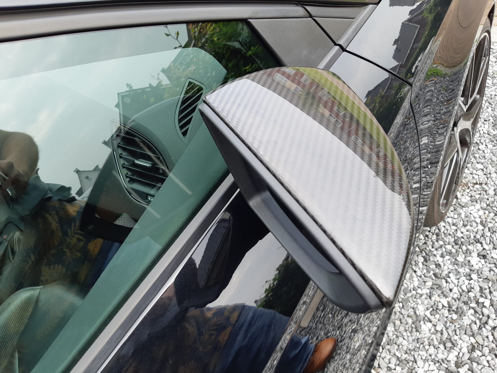

Make sure that the surface is clean and wax free i used some brake cleaner.
Here u can see the rear fitment.

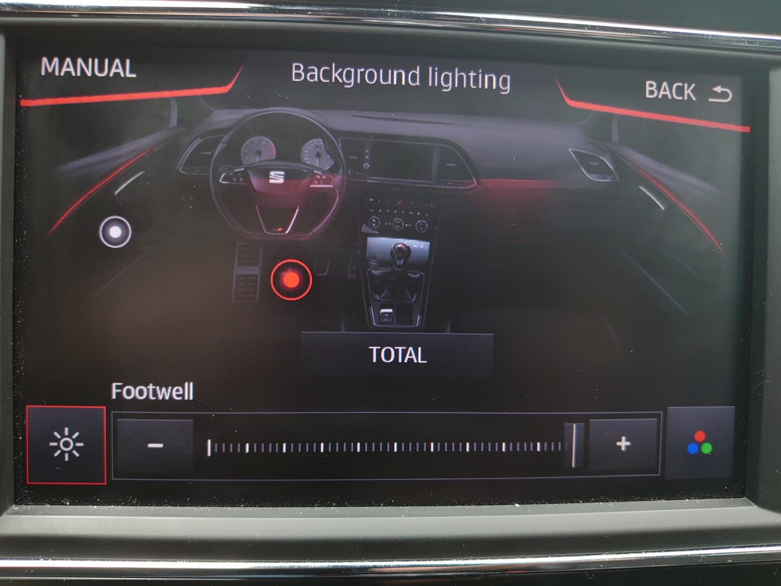

Retrofitted some RGB footwell lights. They can be controlled nicely from the infotainment settings
Don't mind the misplaced graphics. That was an experiment :LOL: Read about the experiment here: https://www.drive2.com/l/581699376527704181/
I need to modify the gca files to add some more zones for future fun, see here:
NB: I still need to install the LEDs in the place where they belong, but connecting the wires was the biggest challenge.
See some additional details about the wirework here:

Damn beat me to it! same as you i've had the parts sitting about for over a year now!
What did you use for the Power supply the original footwell power or did you tap of the exisiting LIN power rail?

I used the + and GND from the original (non-RGB) footwell lights, and took the LIN from pin C29 on the BCM.
After this, I needed to recode module 9, so the Leuchte channel of the Footwells had dimming value 127 instead of 100, otherwise they would flicker when dimming.
