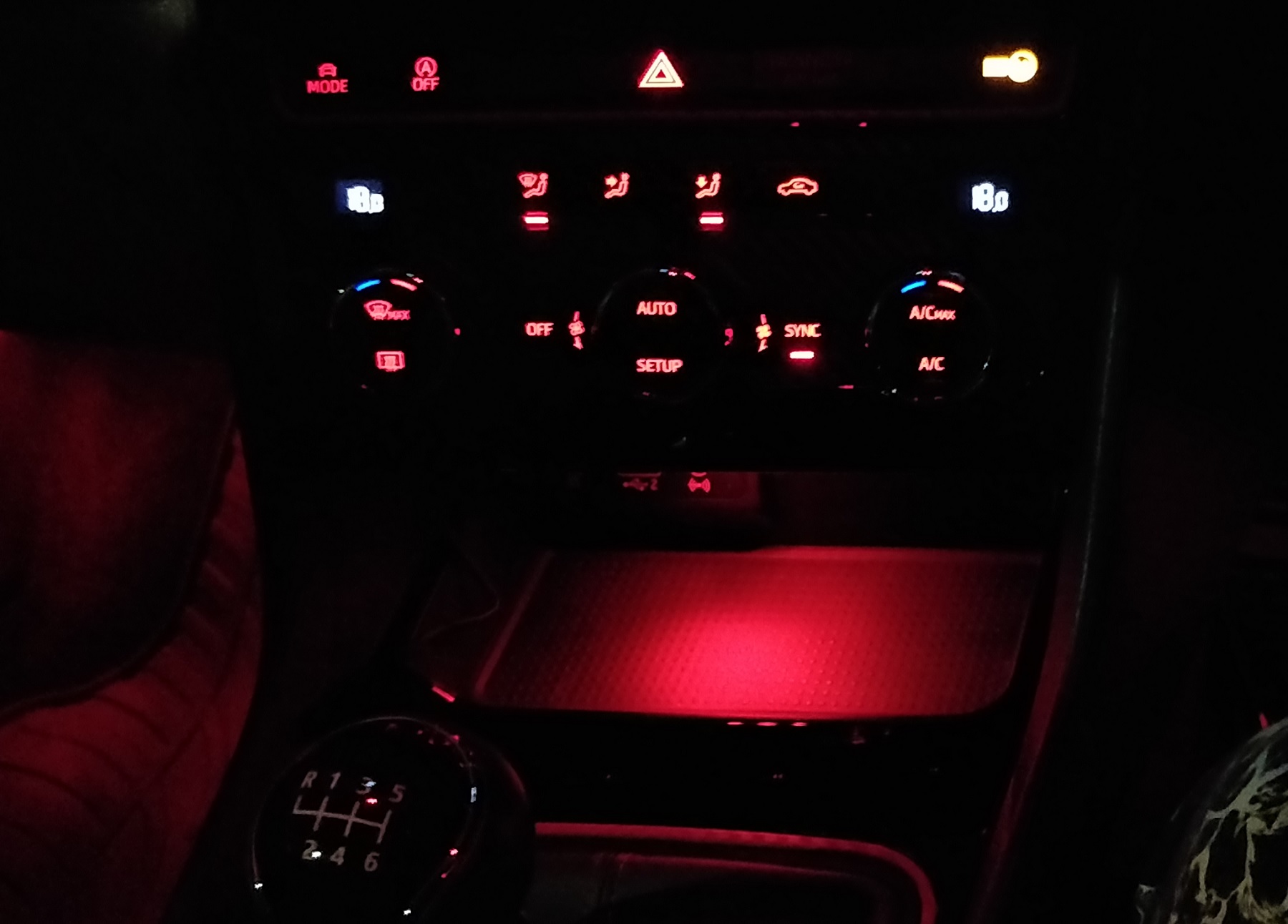

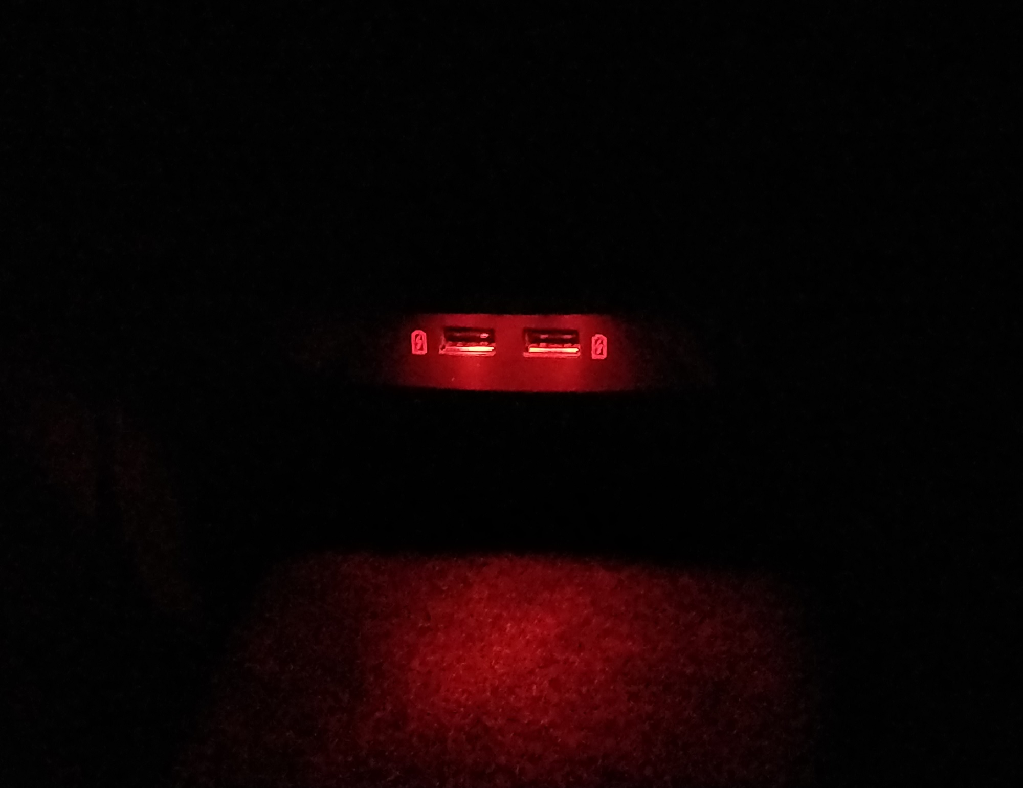

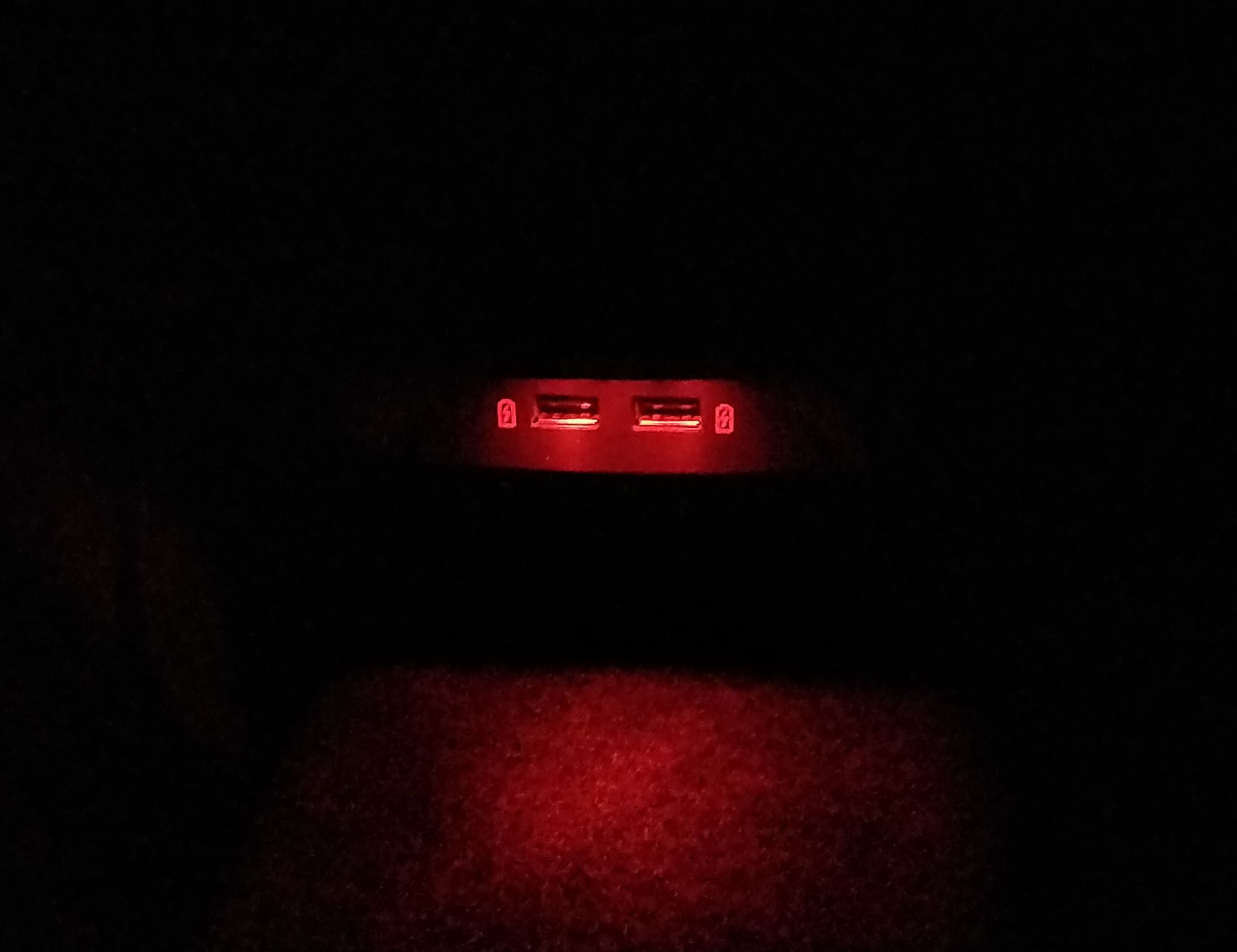

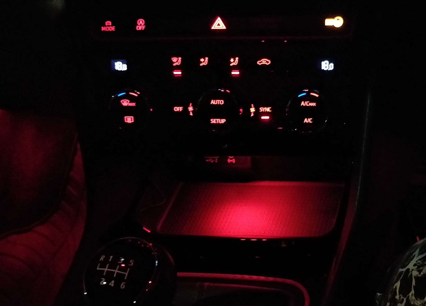

Fitted ambient lighting below air con panel and above rear USBs in centre console....
View attachment 12923 View attachment 12924

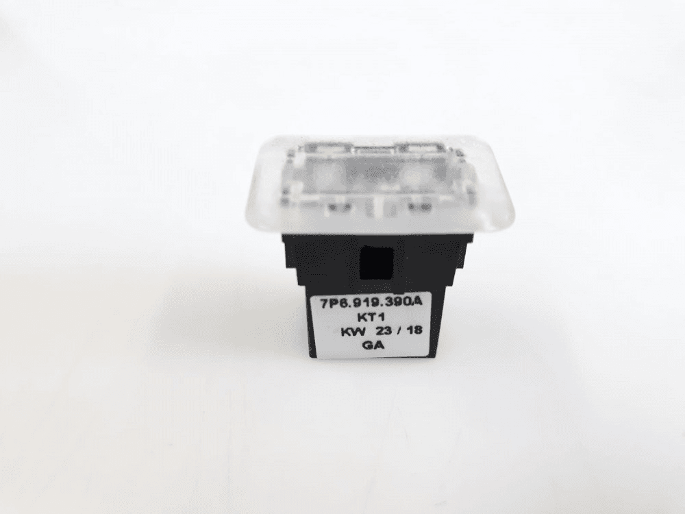

There are two possibilities. Don used some Audis ambient RGB lights (8W0919390A for example) and connected them with doors ambient light. It could work with usb compartment, but there is no space to do this on the rear USBs.

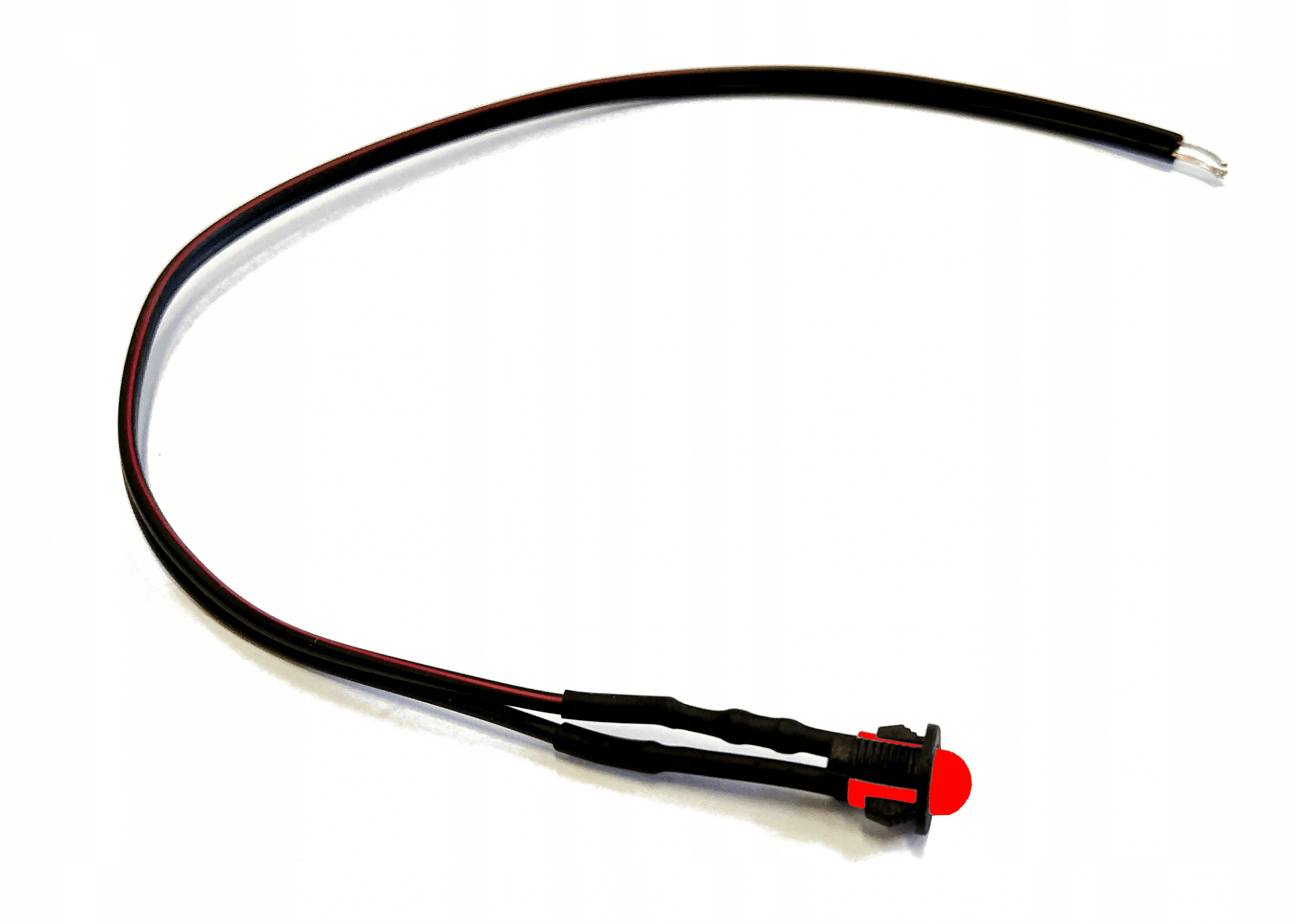

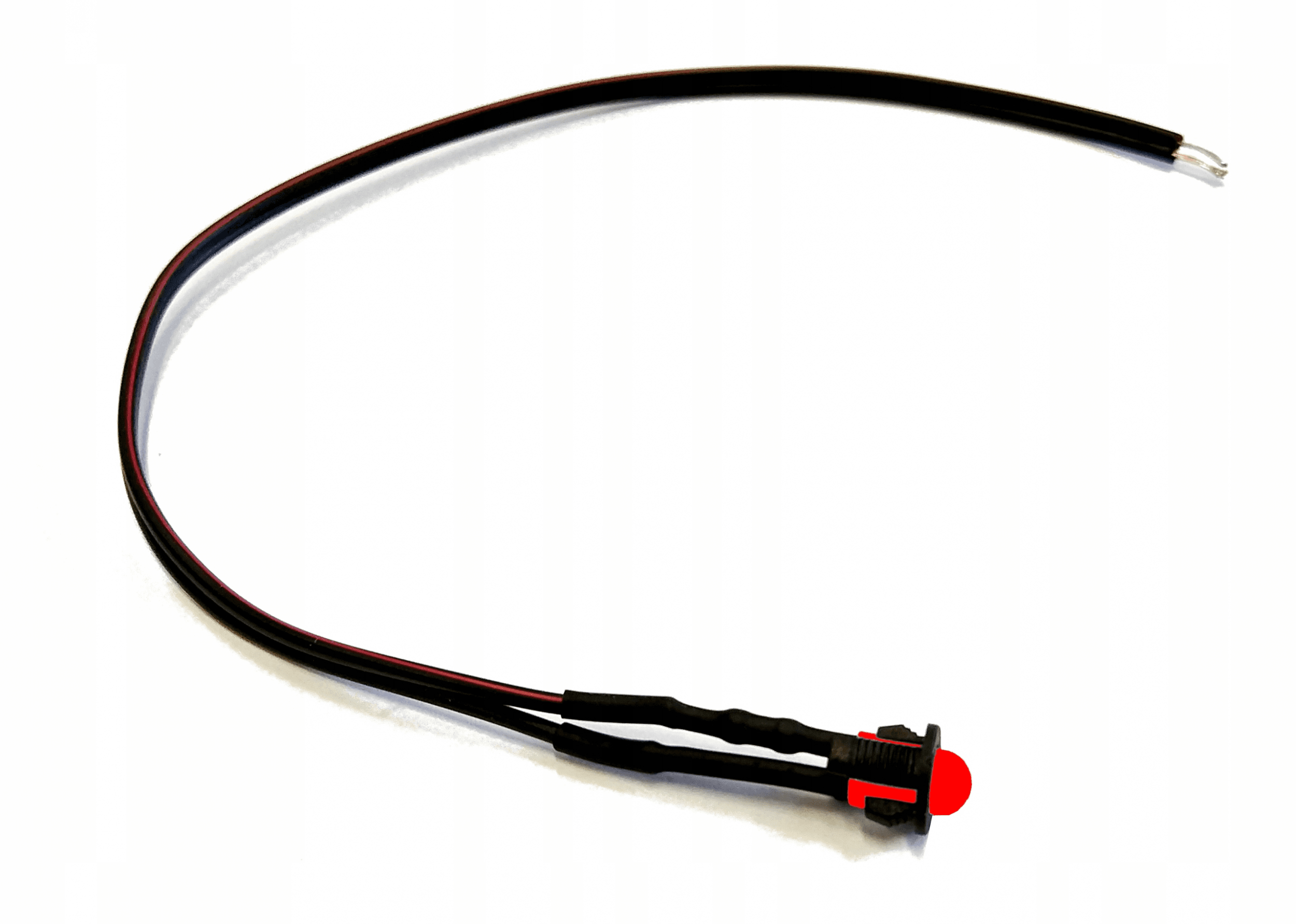

What I think Don did is he just used some "12V red diodes" (regular diodes with resistor) and connected them to the buttons illumination wiring so they light only when it is dark. You can find those diodes online with plastic housing so they can be easily mounted.

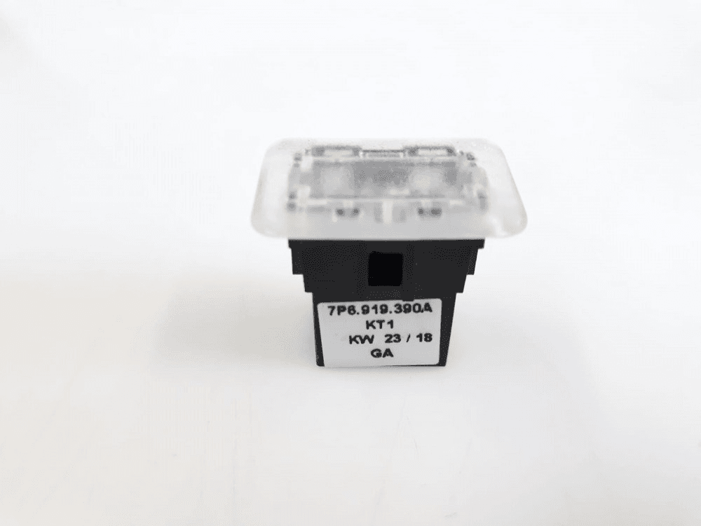

The original light in the USB compartment (which I assume that you have installed) looks something like this and there is no option to replace the "light bulb", it is soldered SMD diode.

Hi. Unfortunately, I don't have the factory fitted light above the front USB connectors.
As @grabania says, I used LEDs (from Amazon) and spliced into the footwell lights so they are dimable.
FYI I've used the same LEDs for the four door pockets, above rear USBs and also the cubby hole just in front of the arm rest. For the doors I used the 12v supply to the window switch illumination and the earth for the window motor.

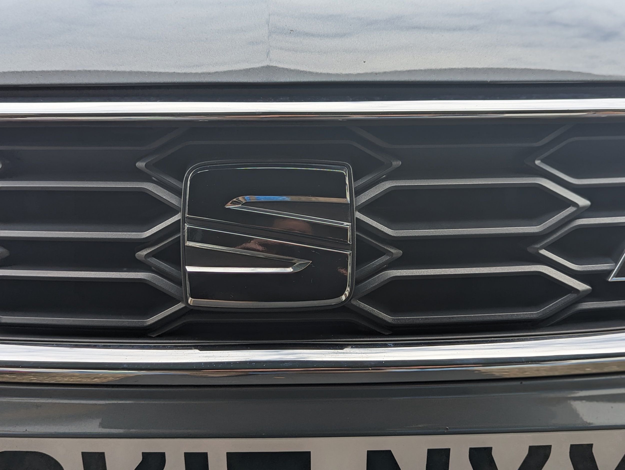

Painted the front Seat badge and Cupra flag black. Ideally wanted a badge-less top grill to match the bottom one. Like the ones available for the mk2 Leons, like below. But couldn’t fine one.

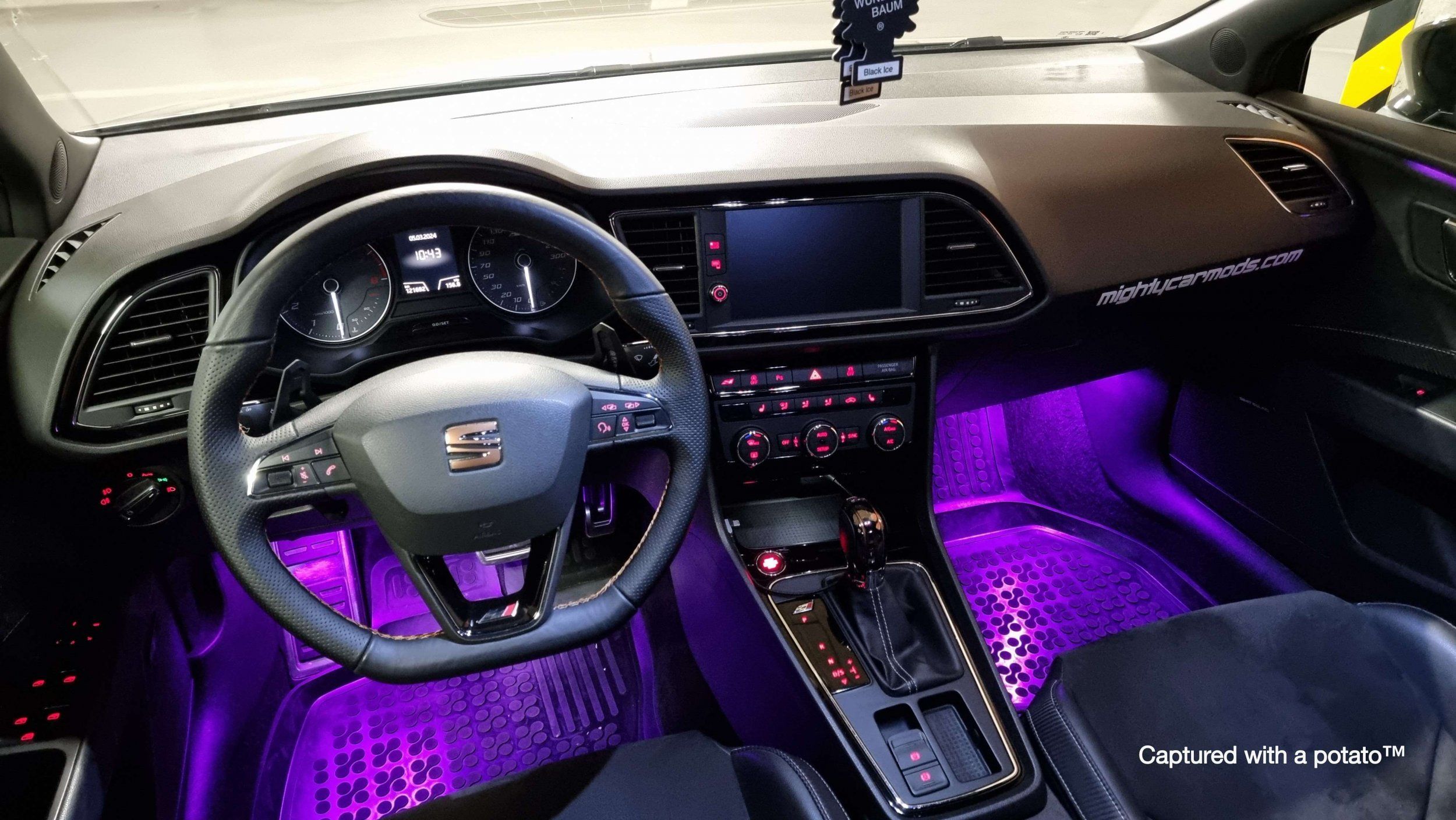

Installed aliexpress RGB footwell lights. If you don't want to spend huge amount of money for OEM solution - https://www.aliexpress.com/item/100...o.order_list.order_list_main.5.64bb1802Ihkitt
Super cheap, surprisingly well built and packaged, fitted in 5 minutes. :)
Looking good! Does they change color when you change color of the ambient in the doors? Or you just plugs them to the original connector and manually change their color by "touching" them?
In my car I've installed some time ago Audi OEM lights (https://www.seatcupra.net/forums/resources/retrofit-rgb-footwell-leds.100/), but installation is a bit hard and it's quite expensive. I am just curious how those AliExpress one works
I went through this guide quite some time ago and told myself - NOPE. I'm not gonna do that. :D
Yeah, you have to touch them but it's no big deal for me. Surprisingly both lights are synchronized so you have to touch only one of them to change the color.

You installed only front lights? Not under the front seats for the rear footwell? Are these dimmeable via de MIB screen?

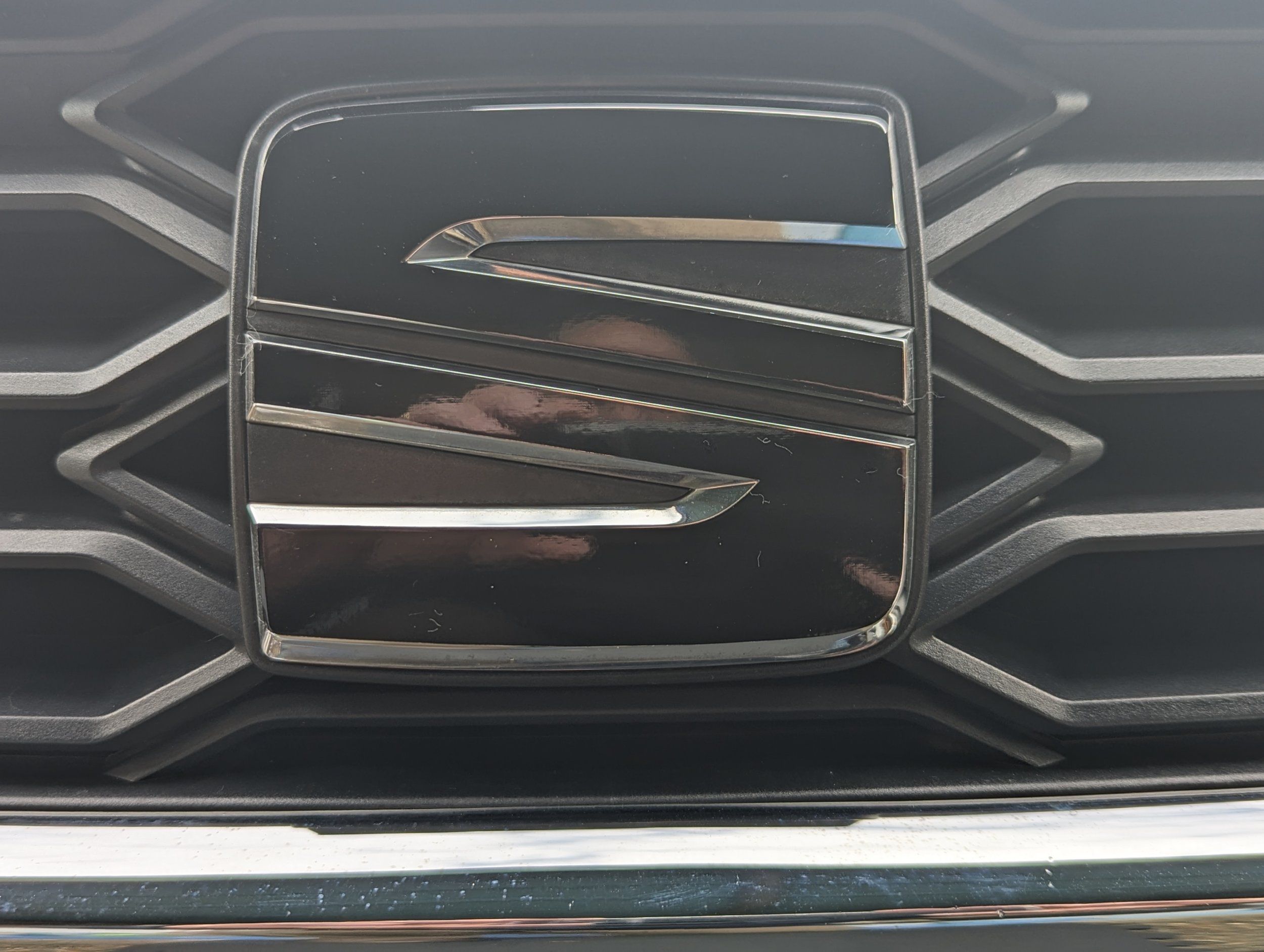

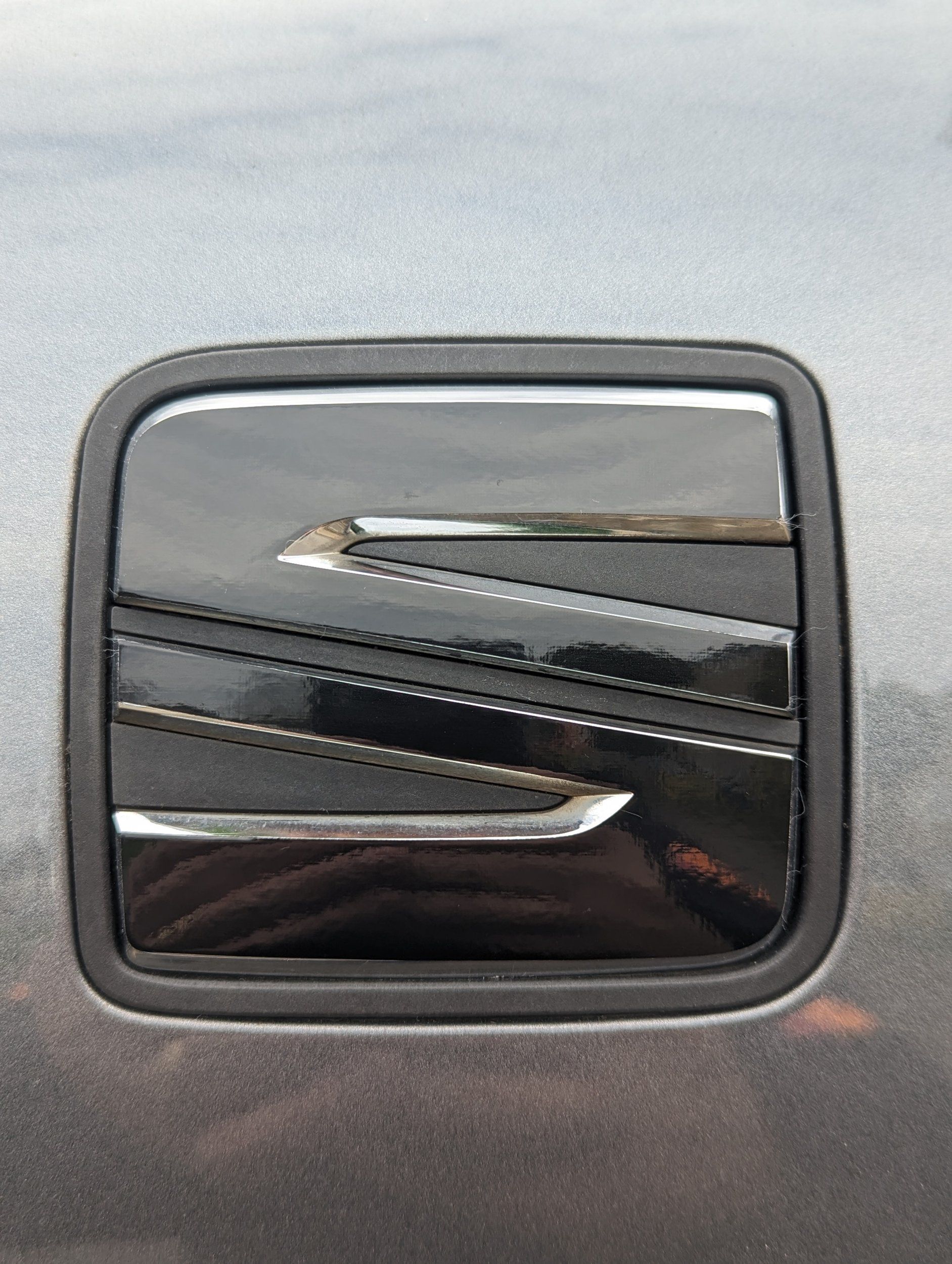

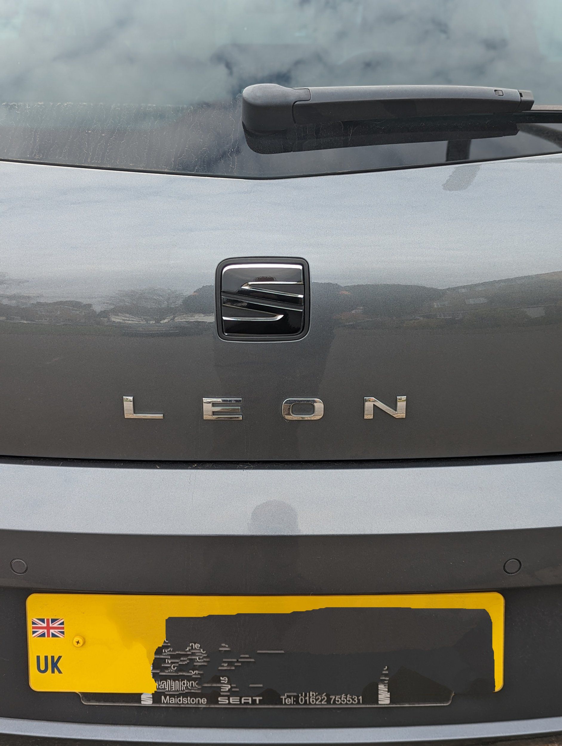

Today I fitted front and rear gloss black vinyl badge overlays.. Just what I wanted and quite pleased with the results ?
