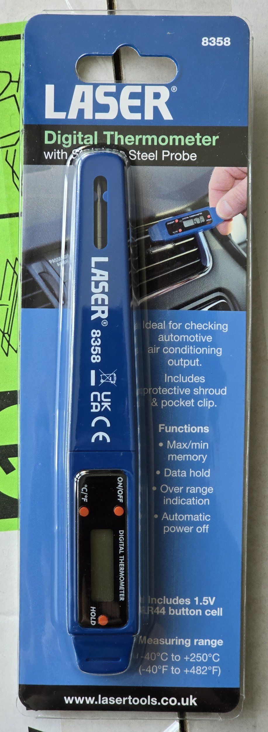

I bought a digital thermometer recently to check my A/C temperature, anyway I tried it today, with the A/C set to LO, and the temperature in all the dash vents was 7.9 degrees C, the outside temp was 33 C, it may have gone lower, but I didn't want to wait any longer for the reading to creep down more. Not bad seeing as I've never had it regassed since new, nearly 9 years old.

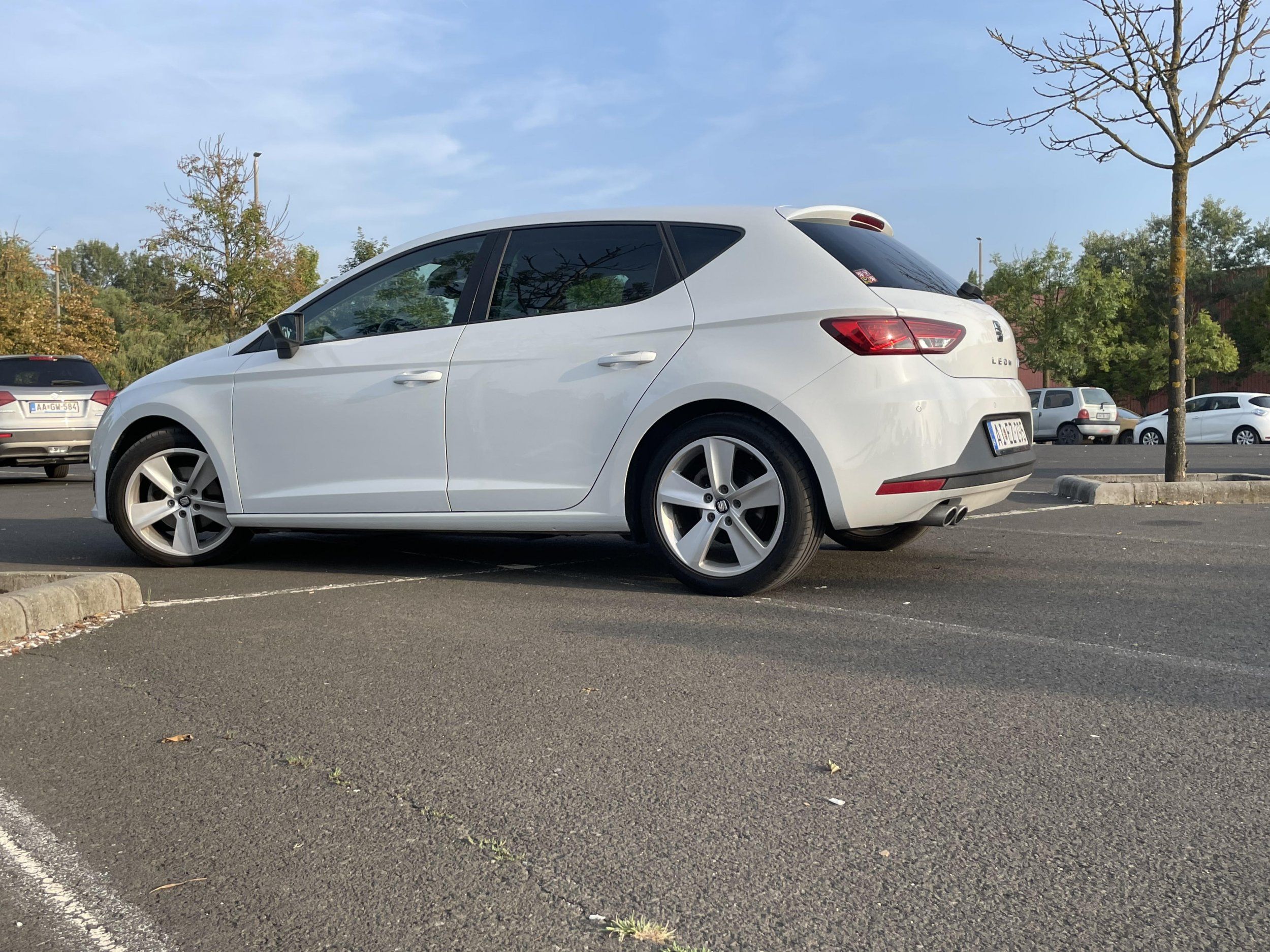

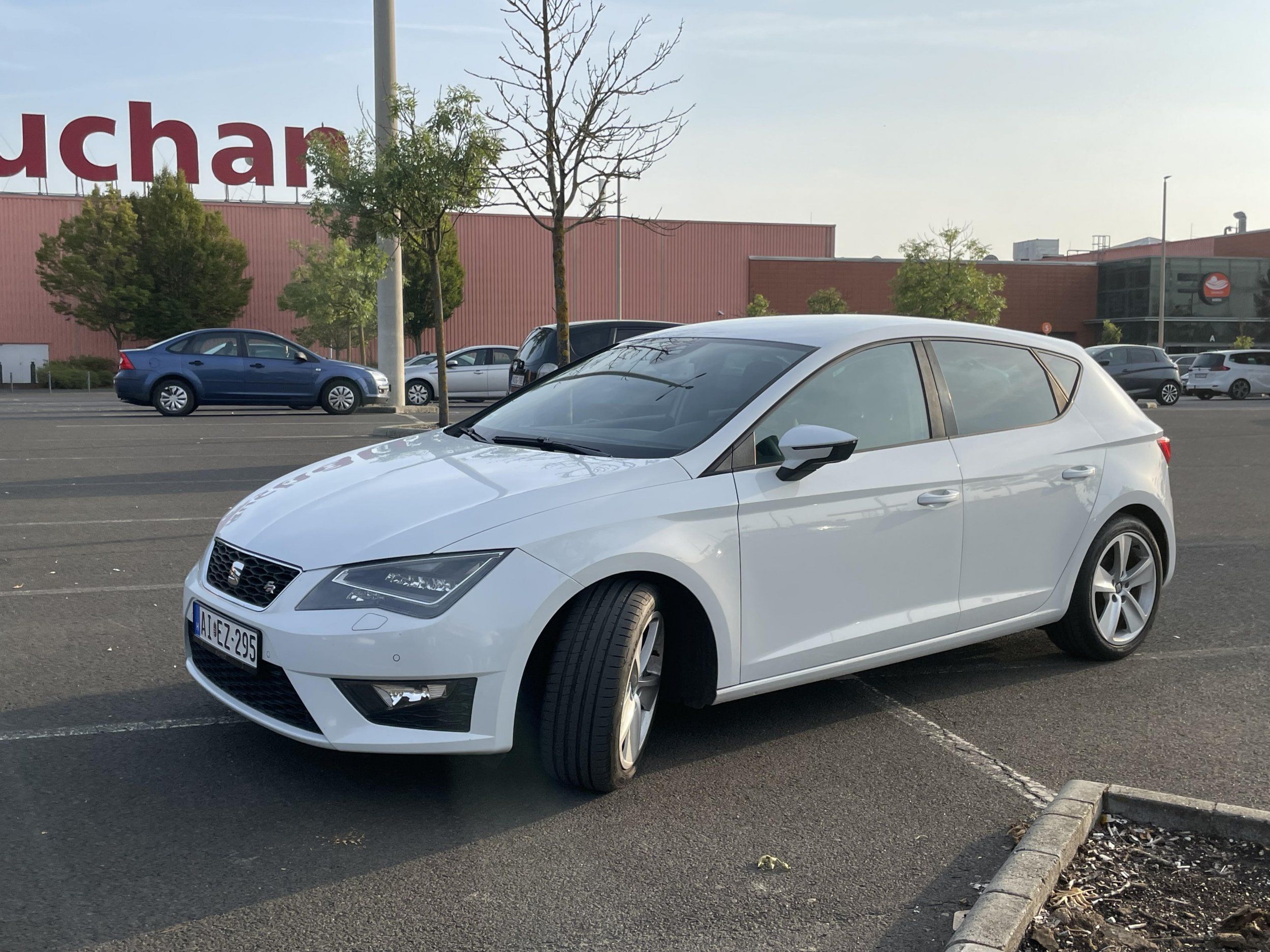

Hello, dear forum members, this is my newest pickup, and my first Seat (I've mostly used to Fords).
I'm from Hungary, and it's good to have such a large forum online. Today we parked like a real jerk (only for the photo).

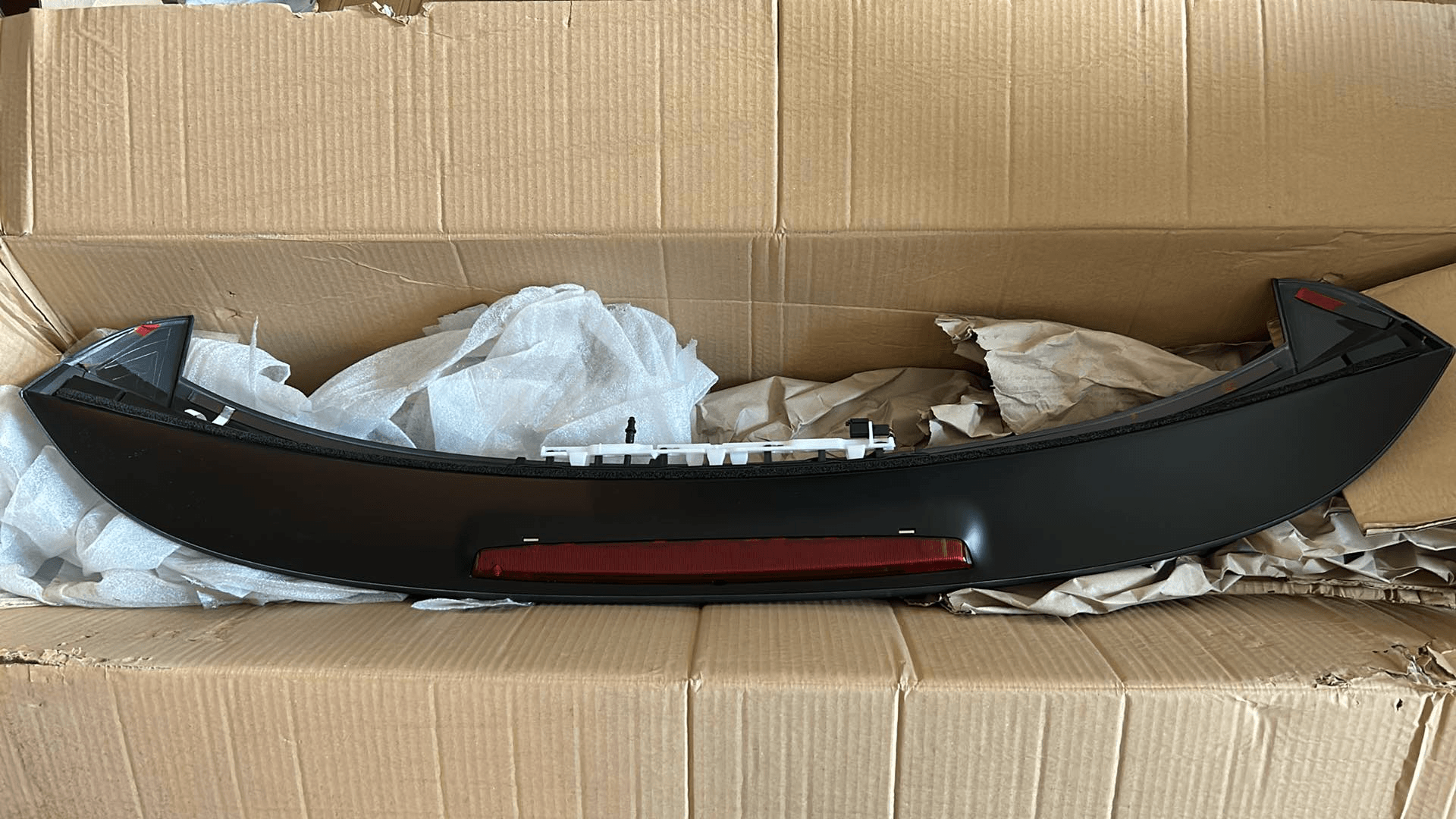

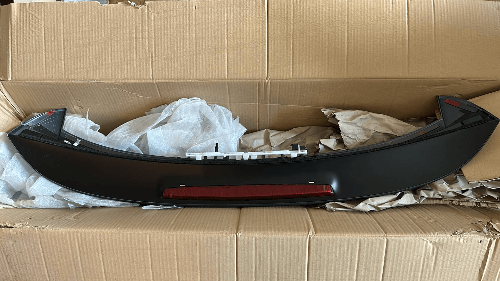

I've finally installed Cupra rear spoiler on my Leon! It was lying in my storage for about a year so it was about time for finishing this mod. It is still secured to the car with tapes so it is looking a bit off, but already it looks so much better! Can recommend this modification to everyone, although it's not the cheapest one.
How was fitting/ how does it work do you take the normal one off or does it go on top also does the original brake light fit into the spoiler? TIA
What do you mean by "you take the normal one off"? By default there is no rear spoiler on MK3 Leon unless you have Aero bodykit. Mine doesn't have it and Cupra spoiler is attached on top of read lid.
Original third brake was removed and Cupra spoiler has some kind of scaffolding that is pushed to the third brake hole and has its own light. Spoiler is attached using 3M tapes (visible on a photo) and I believe with some windshield adhesive. I wasn't installing it on my own so I don't know to much details.
Reactions: RyanL299
Yes that’s what I meant the thing at the top I have seen one for sale but it doesn’t come with the brake light so I didn’t know if the normal one fits in and in the description it says it has a small crack behind the brake light that you can’t see when the light is in

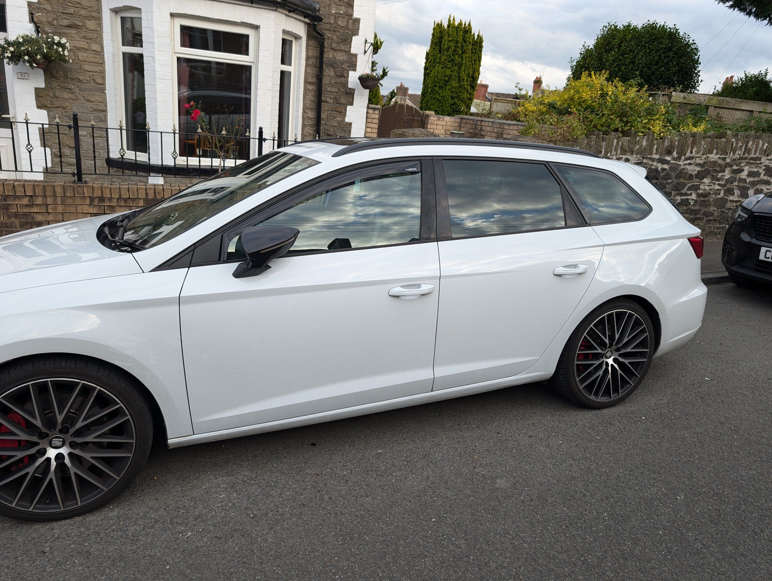

Fitted Climair Dark Sports front Wind Deflectors. Rears due on Sunday.
My experience: The fit is millimetre perfect, tint level perfect, severe reduction in water ingress with the window partially open, no additional noise up to 70mph (well, none that I can hear over my music at low volume, nothing I can pinpoint with music off) so they are worth every penny.

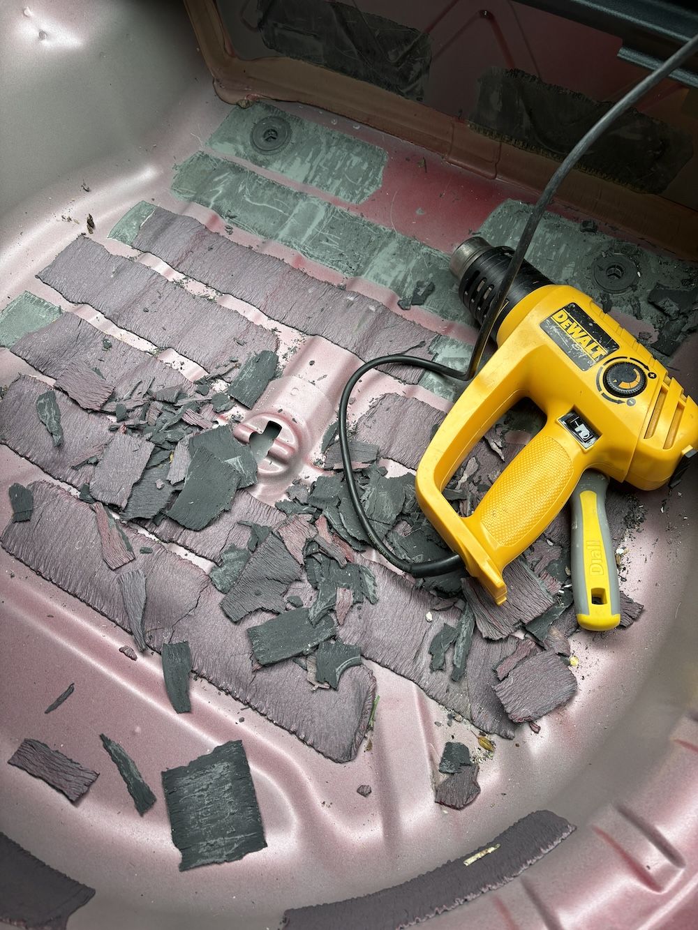

Also finished off the boot, having ordered the spare wheel well and boot floor liner. Can't remember if I'd posted the work in progress fitting Dodomat SQ sound deadening material earlier this year, if not, here ya go!
Removal of the original sound deadening material, as a lot of it was already peeling off the bodywork:

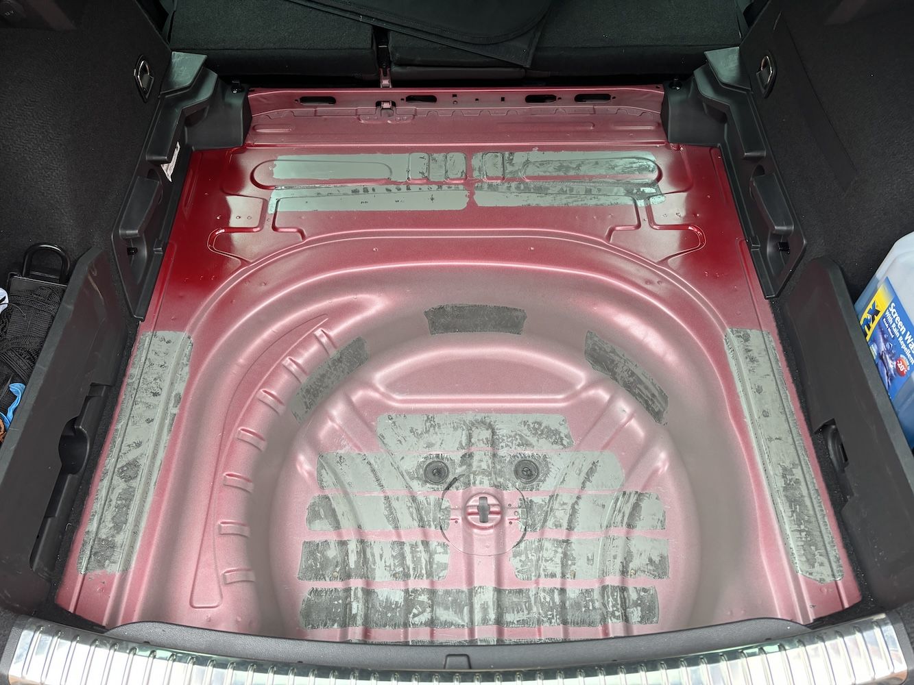

Bare metal:

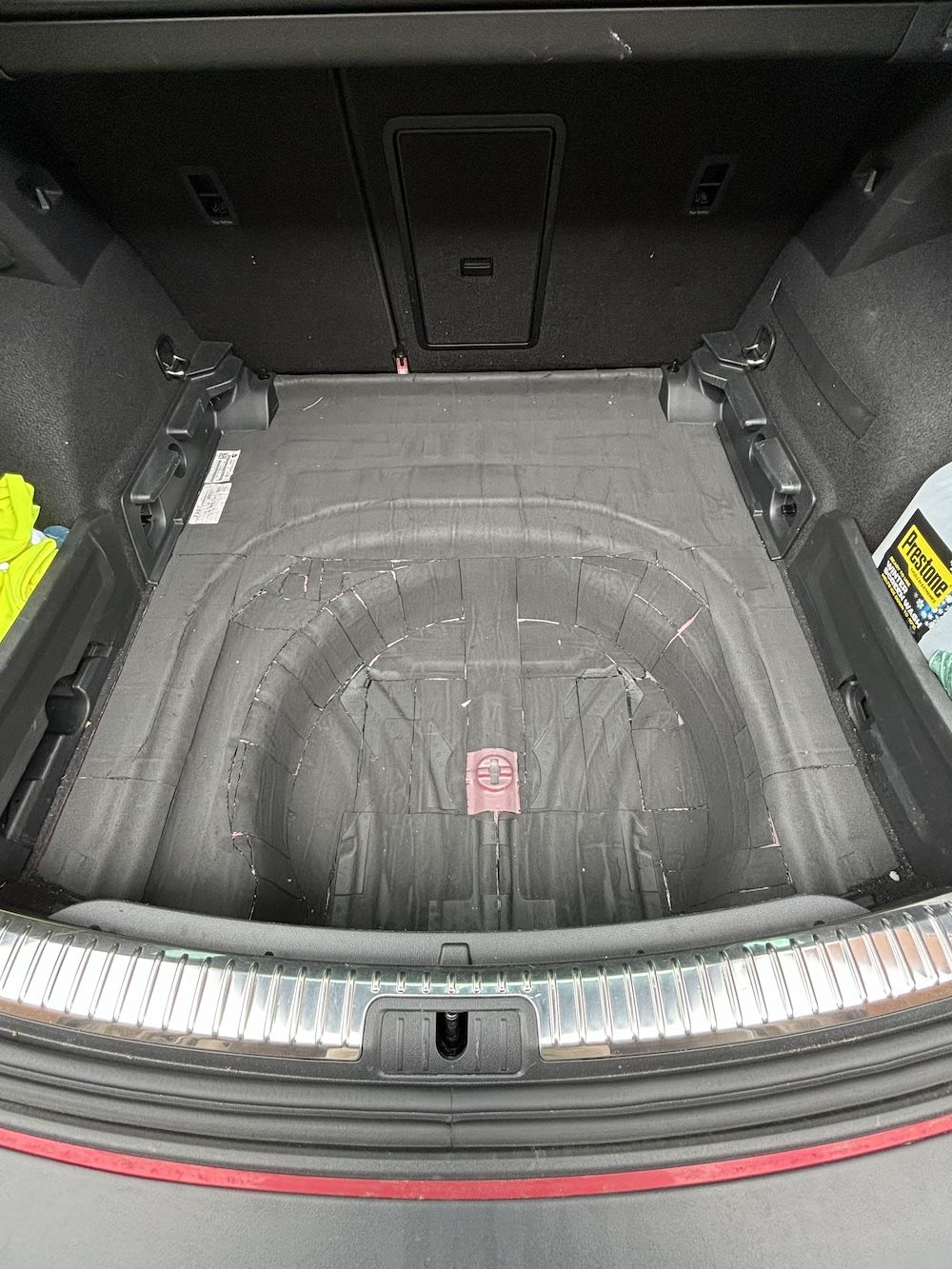

Dodomat SQ in place (been like this for a couple of months, and the toolkit tray had stick to the exposed bitumen!):

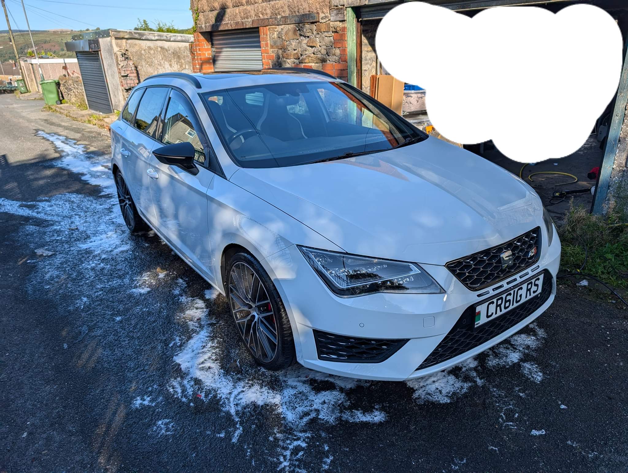

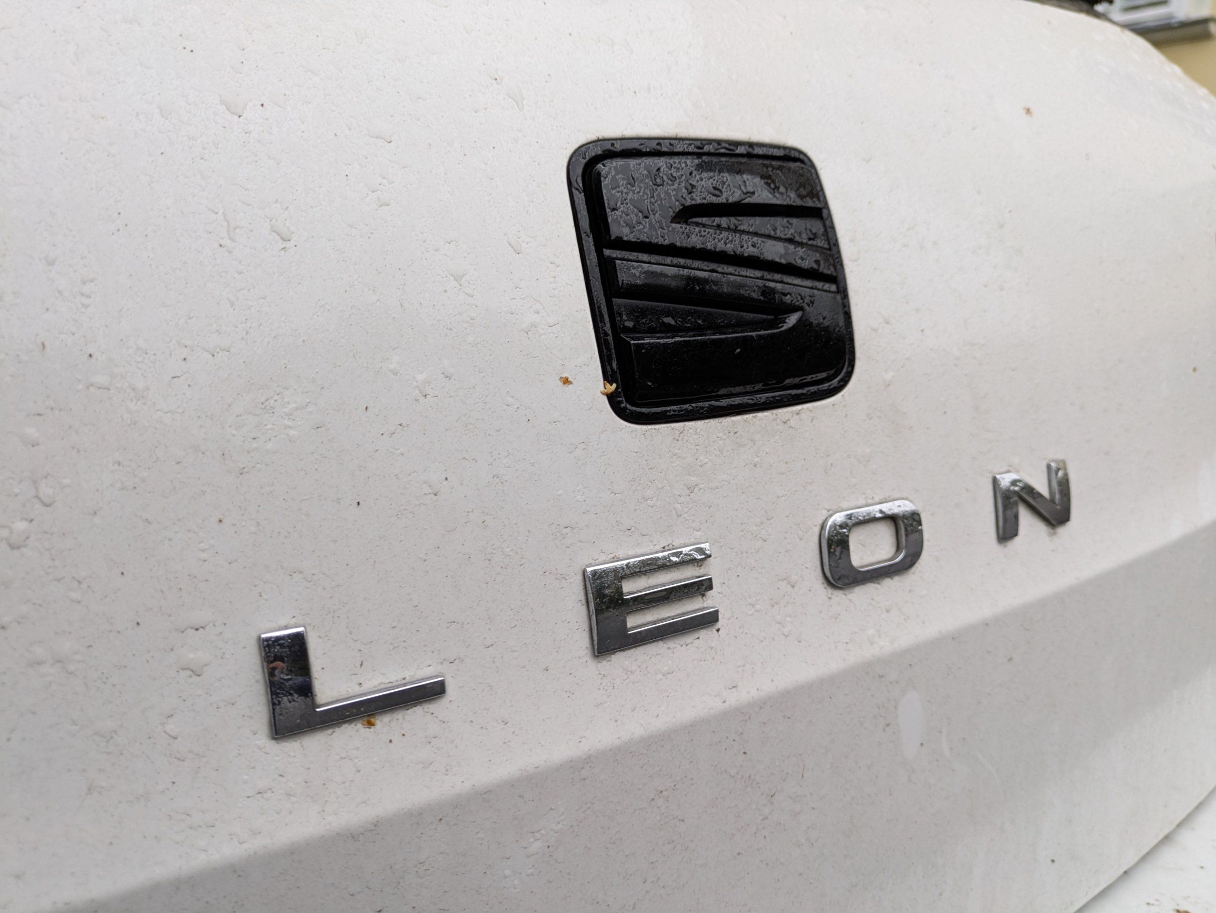

already a few days ago, also consider removing the writing
