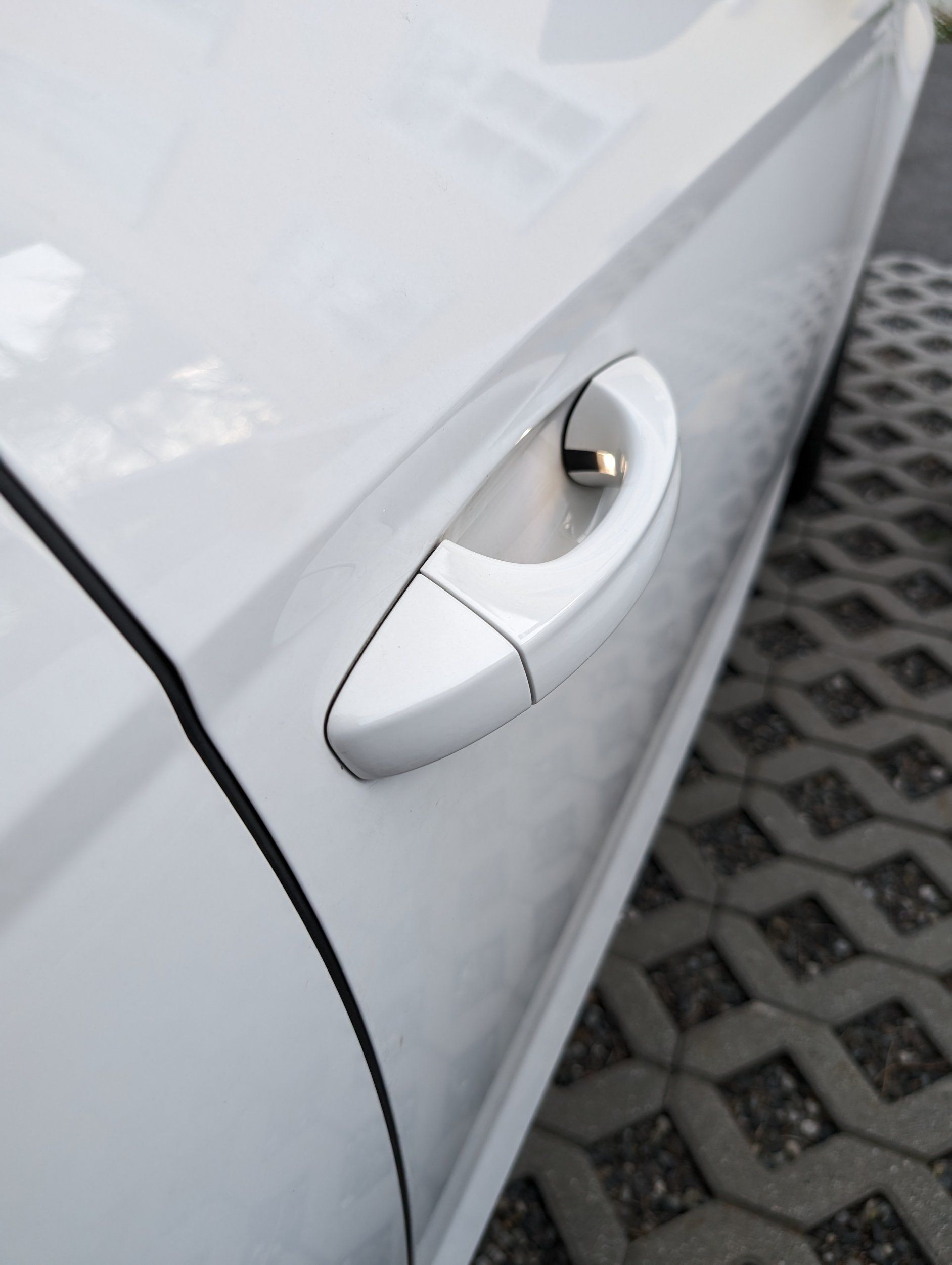

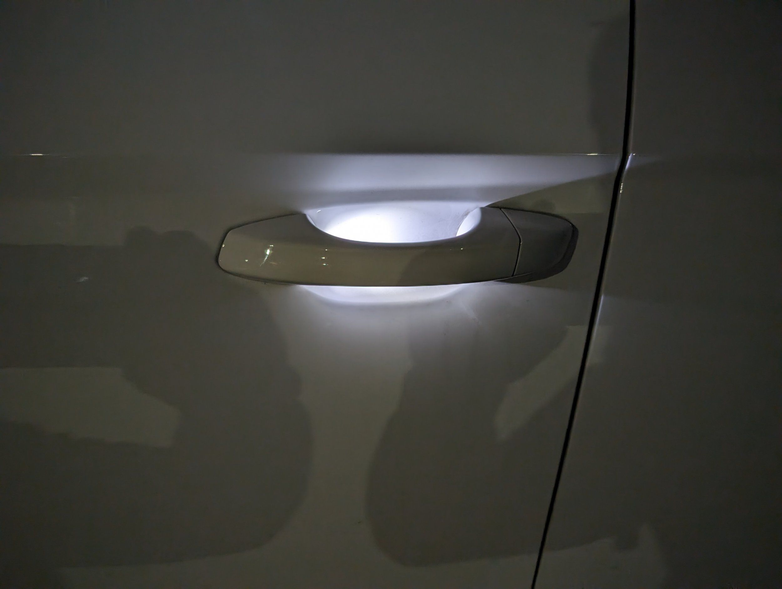

So... I've ordered those handles and here they are. They were packed very well, better than anything that I've ordered from AliExpress in the past. Stiff box with a lot of tape and bubble wrap.
They weights 5g more than OEM handles without Kessy. I've measured them and looked at them from every side and it seems that they should fit in the Leon. Their black paint is different than Leon black paint and I suppose the same story will be with white ones.
After connecting the light to the 5V power supply it happily started to glow. Light can be unscrew with Torx screwdriver without any issue. The 3C0973704 connector fits perfectly.
There are few marks and PN on them which indicates that they actually might be OEM parts for Chinese market. We will see, I hope that soon I will be able to update this topic with new information.

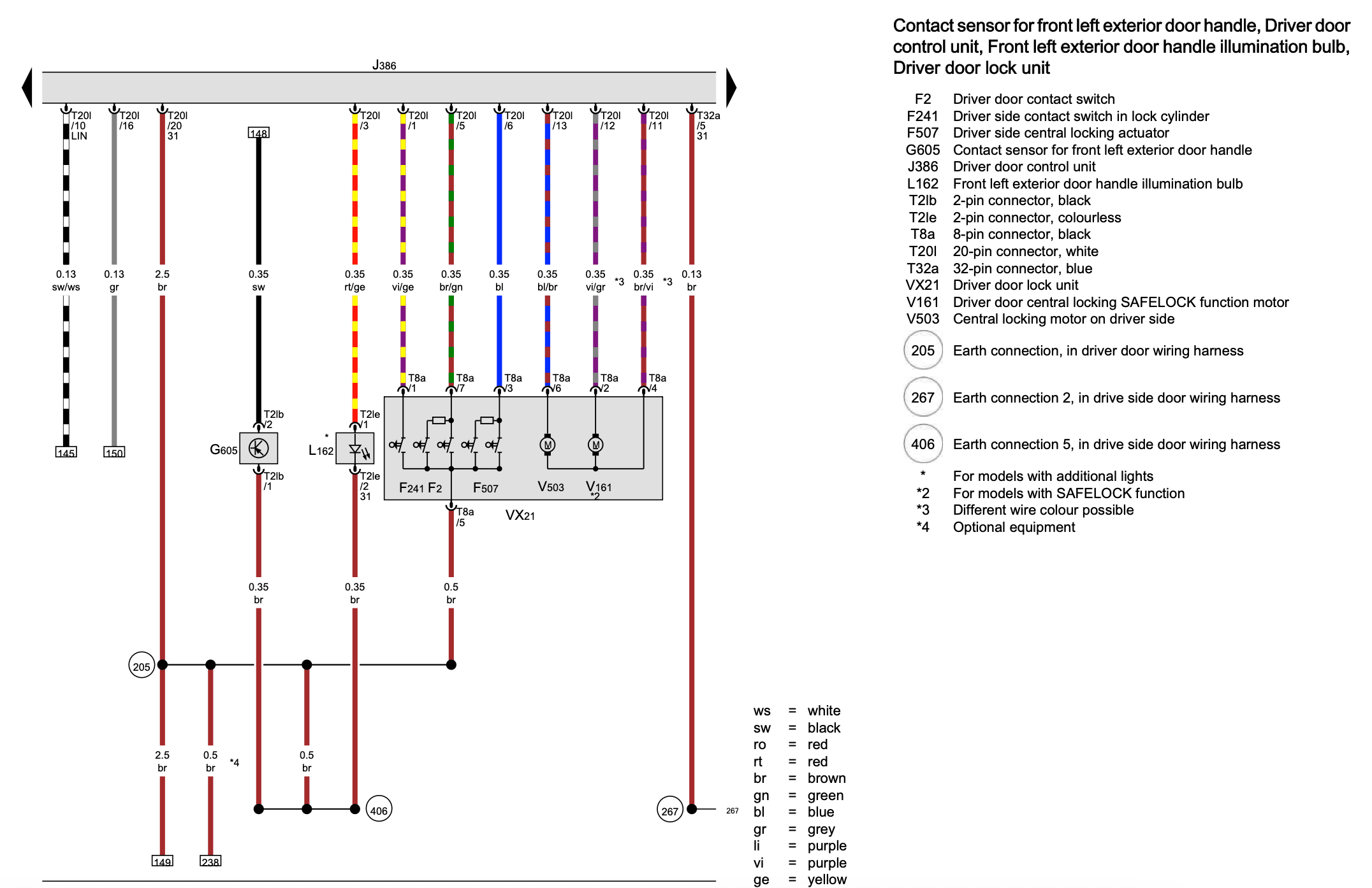

Found wiring drawing from Golf8, looks like it should mach Leons door modules if compare pinout and functions...
@cairus, what drawings You used for this?
  • Retrofit_Background lighting_UD1_UD2.pdf
Reactions: Craig.
the connection is made via the ambient lighting
Pin 1 / 16 Poliger Stecker= +12V Türsteuergerät
I've found Audi A4 wiring diagram and it looks much simpler for front doors. I am going to test plus signal from T20l/3. I believe there is a separate adaptation in door module(s) for outside door handles illumination
Reactions: Slavixs

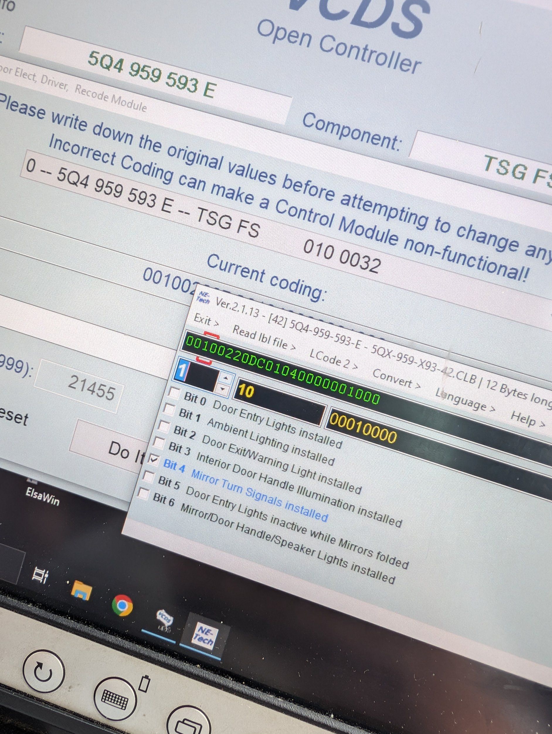

ahh ok, but door control modules have pin for this lighning and in codings also there is "handle light" option! ;) I will try this, like it should be when I will install handles.
p.s. I ordered all 4 kessy with lights. Will add kessy also for rear doors.
EDIT: I checked coding and it says "Inside door handle light" so not shure light is inside handle or it means interior handle :D

Why not just wire and code Byte 1/Bit 0 same as Golf Mk7 wing mirror puddle light? That way the function will operate correctly, or am I missing something?
Reactions: Slavixs
Because handle lights are not puddle lights, I just would like to do it correctly, where it should be, if its possible of course. Yes it works that way also, but if there is special output on module for handle light, and also if there is coding bit, I rather use correct way then.
p.s. bit 6 looks interesting on Your picture
