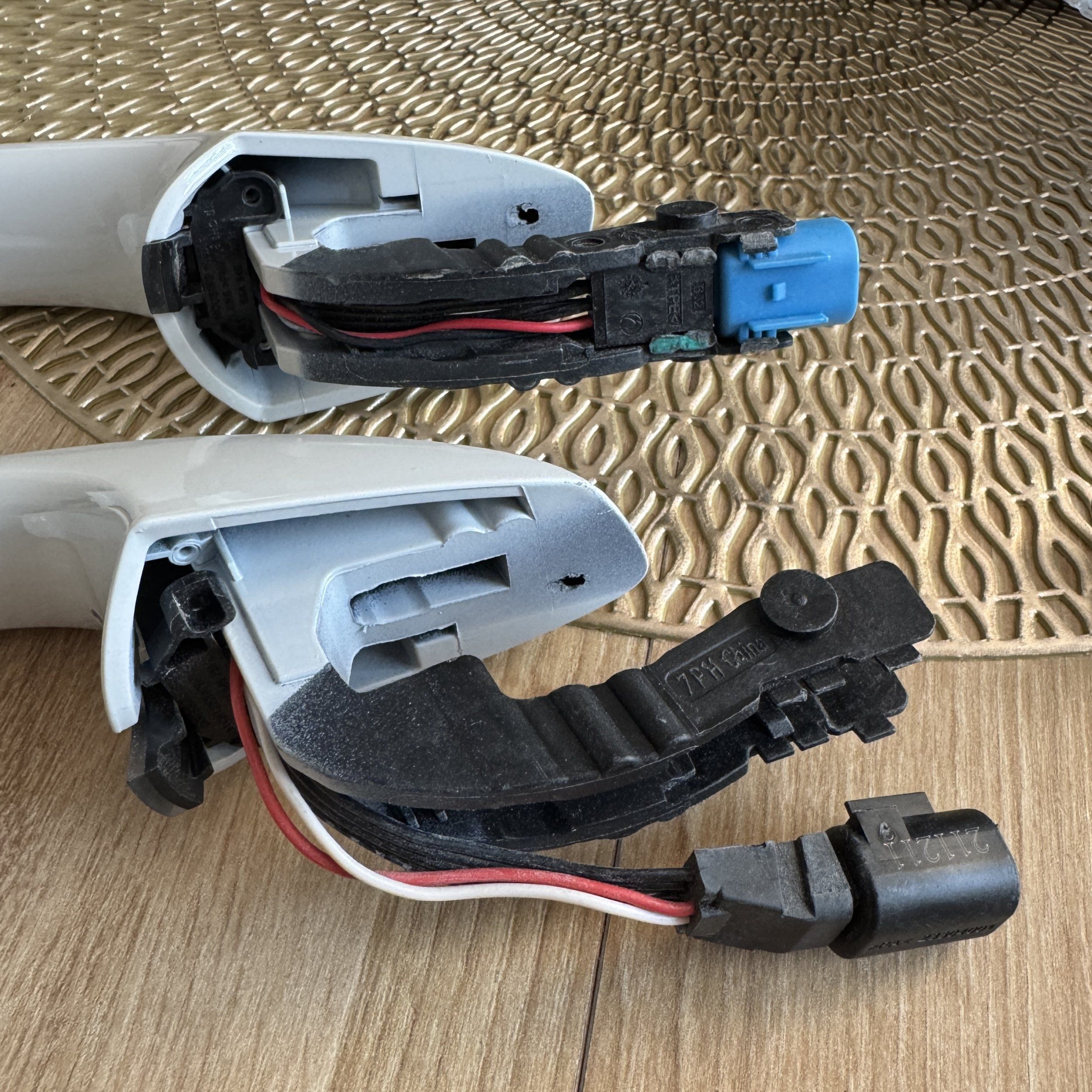

I've ordered Keyless version with cables and asked seller to paint them white. Package was definitely worse packed that previous one and was beaten up during shipping. Fortunately handles are fine, but manufacturer did some mistakes.
First of all connector in one handle is loose. It is held by some plastic tabs that needs to be melted to secure connector. This one can be easily removed so probably I will fix it by simply melting those tabs using soldering iron.
Secondly every light is missing screws. I can only guess that they removed lights for painting and forget to screw them after. They are nothing fancy so I will be able to screw them by myself. However I've contacted seller and we will see what they will reply.

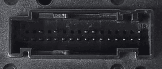

Since I've ordered Keyless version of handles for my friend (because he has Keyless) I've been investigating whether it is possible to activate Keyless handles in the rear doors. Short answer? Yes! Long answer? It depends...
There were two Keyless modules installed in the Leon MK3: 5Q0959435X or 3Q0959435X (from 30.07.2018). Main difference between those two modules is the amount of pinouts (32 vs 40). I've investigated wiring diagrams to determine which pin does what and I've found that 5Q0 modules does not support rear door antennas. Unfortunately my friends car is from 03.2018 :cry:
As far as I can determine from wiring is that 3Q0 modules has two main advantages above 5Q0:
- they supports rear door handles Keyless antennas/sensors (pins 3/4/13/25/28/29)
- they supports electric trunk lid (pins 2/16)
5Q03Q0
Im lucky, I have 3q0 module, And the handles is at the painting right now! :)
