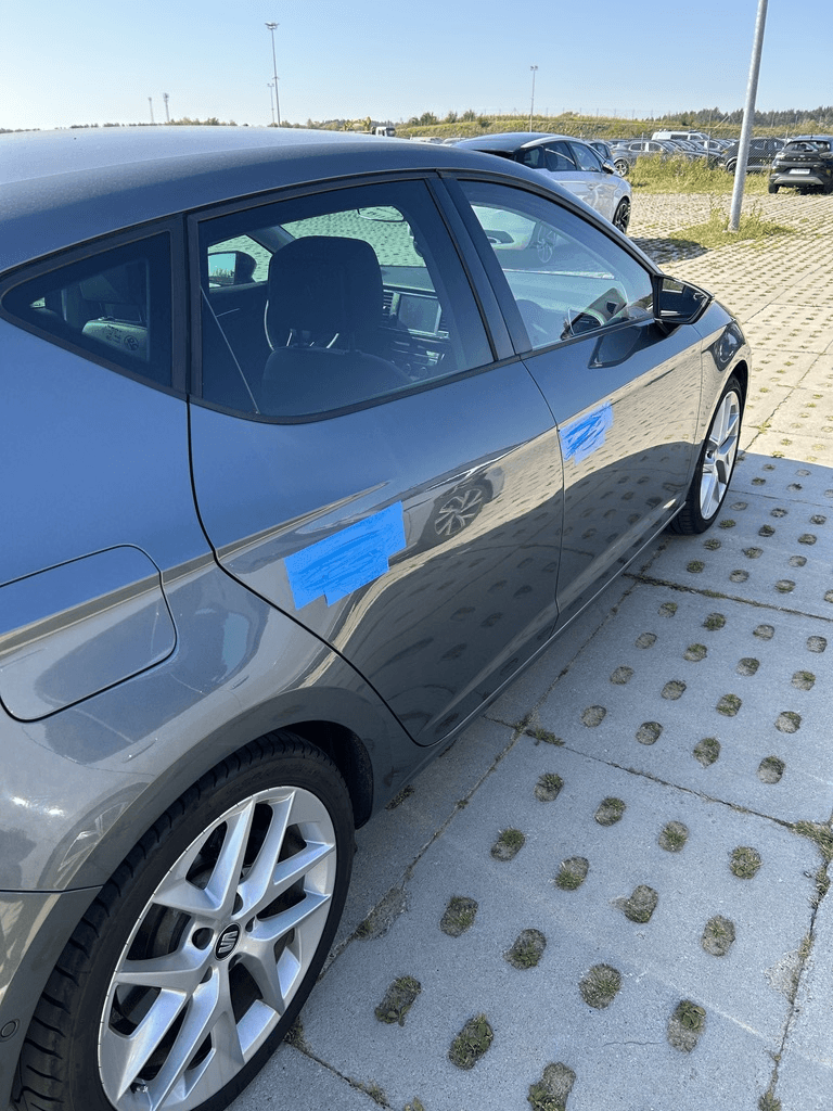

Today I've received info from painter that in order to reduce differences in color I have to deliver to them "lock" covers. Funnily enough the door handles became loose after removing those covers from passenger and rear doors. FYI T40207 tool (or bent rod) is required to remove them. Here's how my car is currently looking while waiting for new handles :D
Looks better without, always thought the handles stick out a bit too much

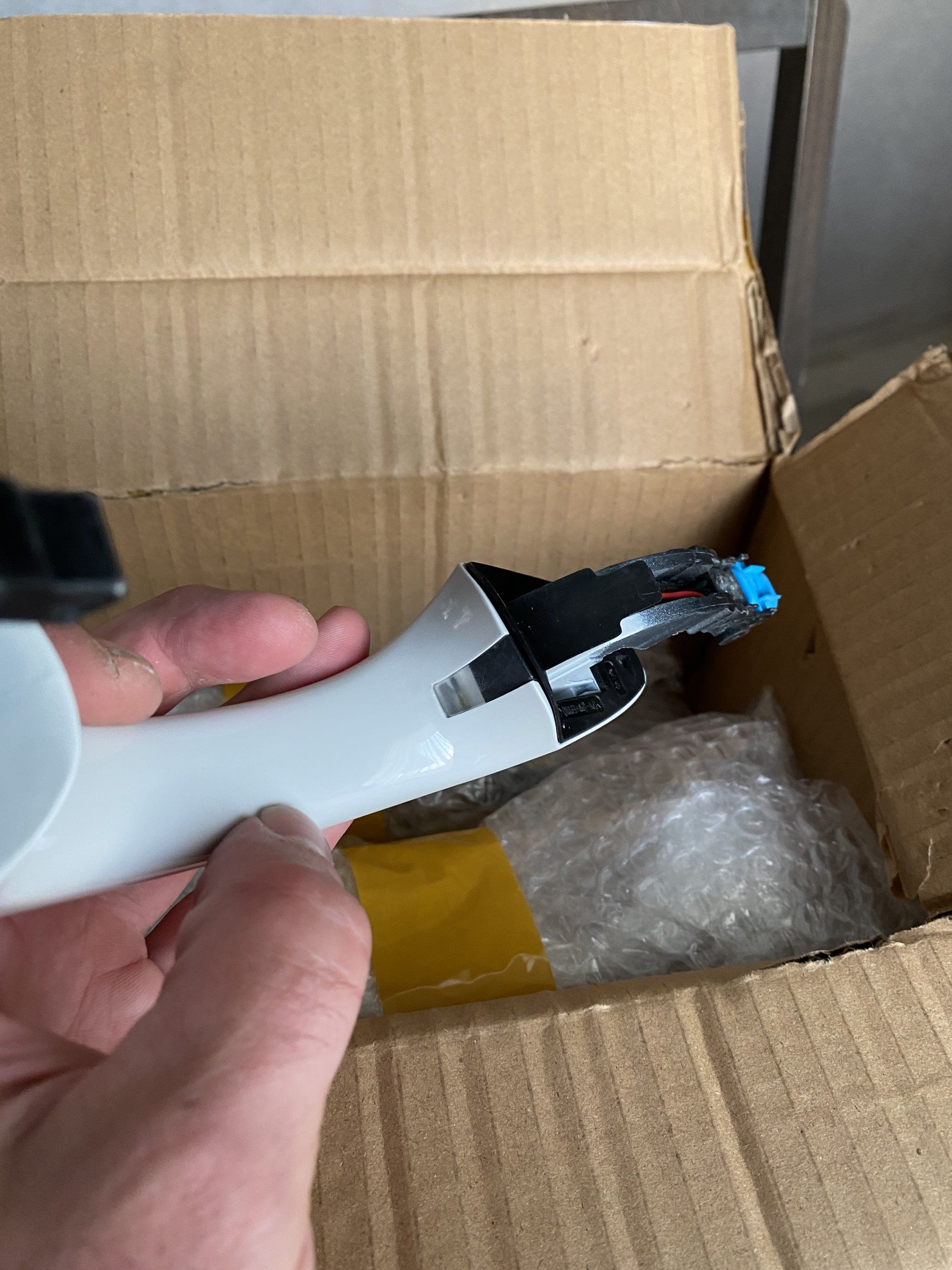

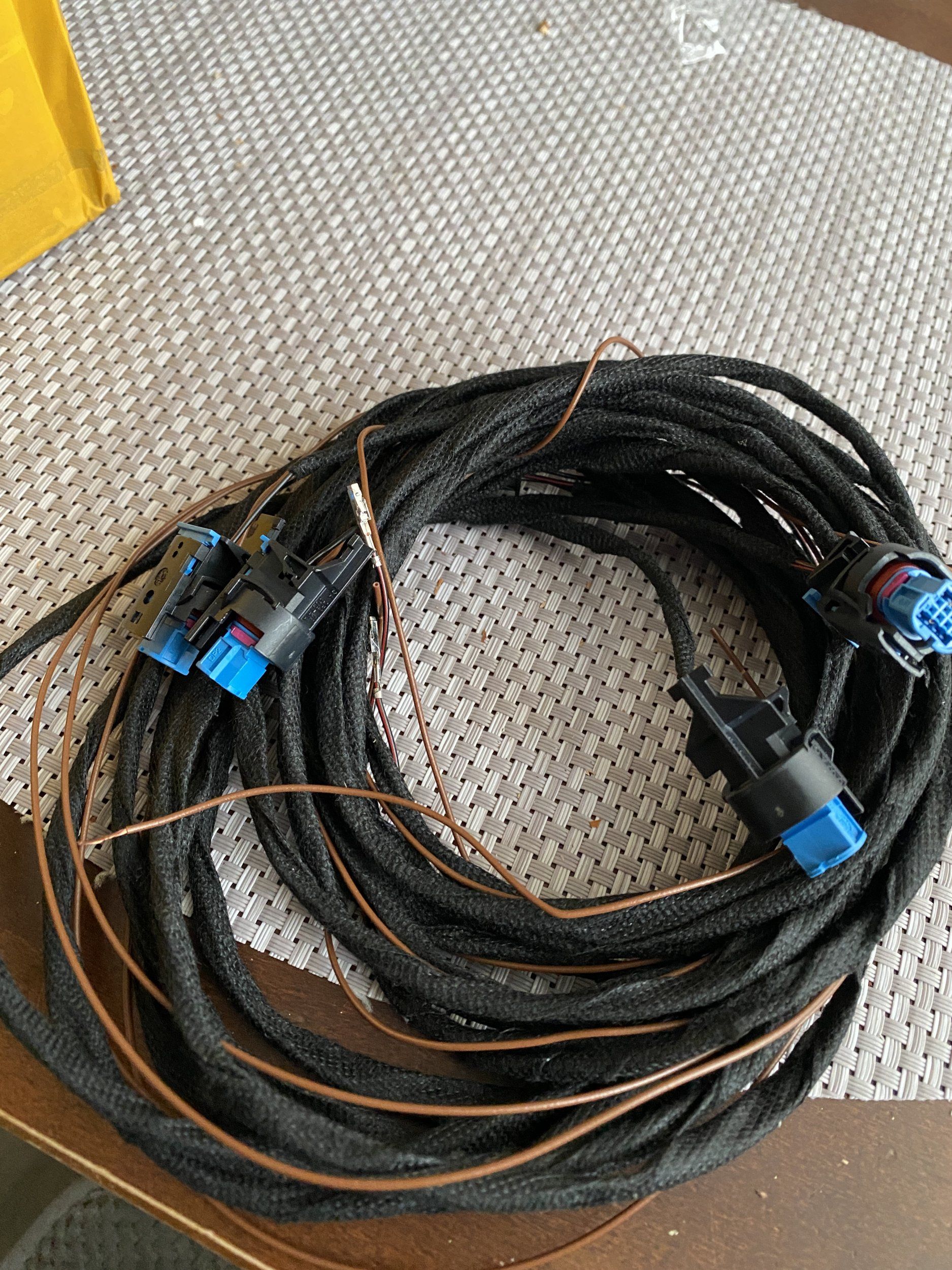

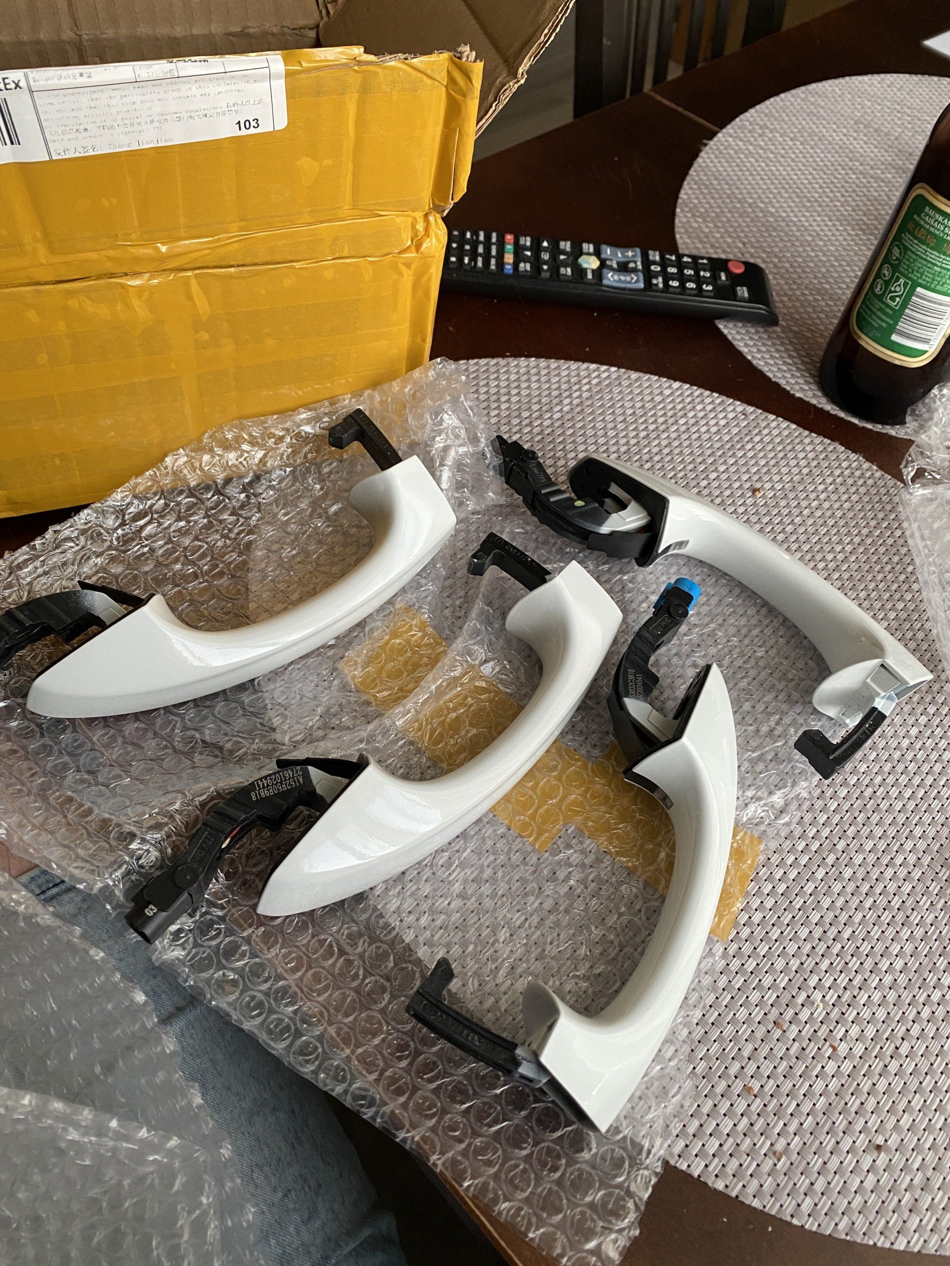

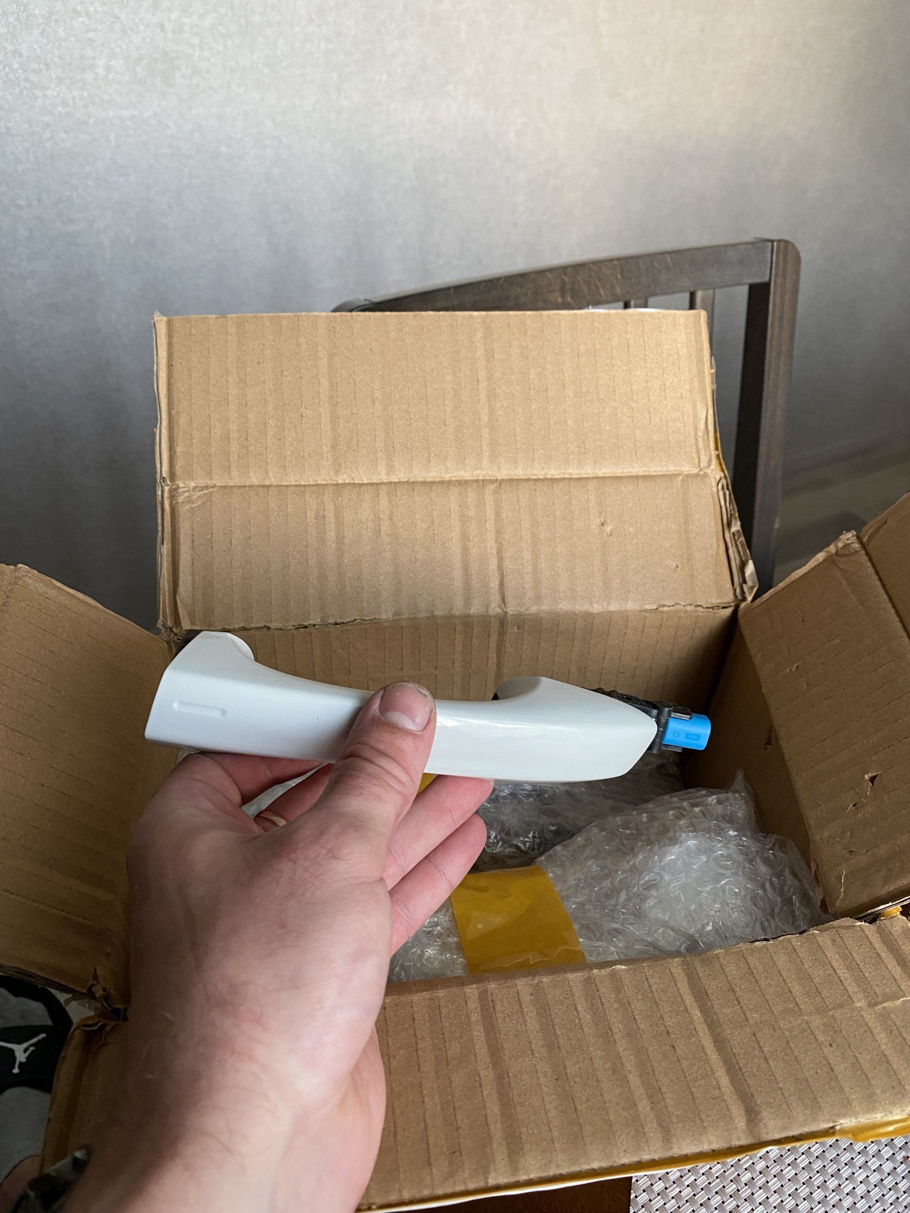

So received handles with light and kessy... unfortunately I need to repaint them, they are white but not metallic white as my car is. So will install them after repaint someday...
Ordered together with wires for light, for kessy I will pull extra wires to rear doors.

I see that handles has two colors of connectors (blue and black) however wiring has only blue plugs. Are they fitting to each other or driver handle (with blue connector I suppose) has different plug than others? Also it would be awesome if those plugs has some PN on them so we could confirm that their PN is indeed 3G0973708.

Blue connectors fit black plugs, I tried on both colors it get on... But the pinout in both colors are different.. Even Chinese provided wiring for lights are ok for blue connector handle but not ok for black ones... But I will redone everything as it should be to get it working.

So, I have the grey connectors on the handle, the black connector with red release on the wiring harness. Article number connector on the wiring harness 3C0973704
