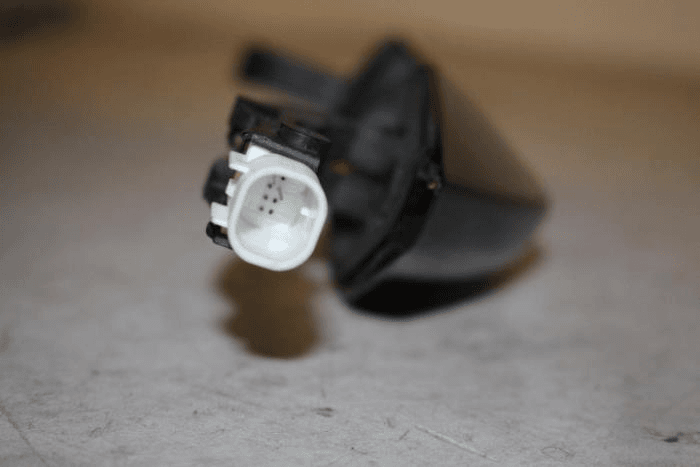

4-polig. Warte eine Minute, überprüfe 8-polig

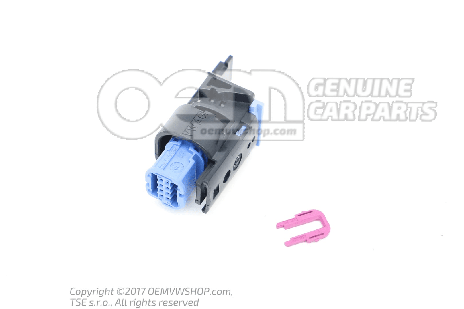

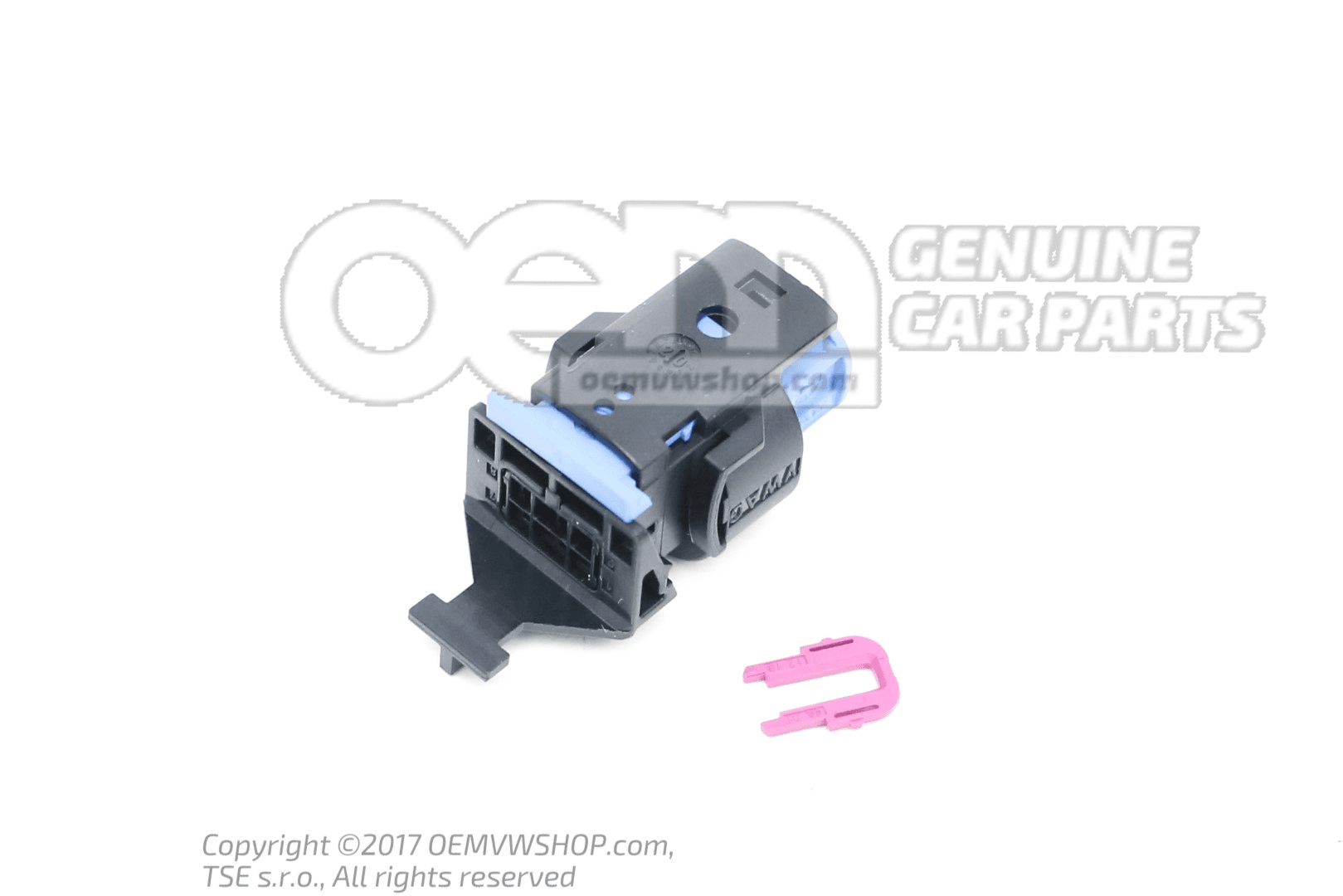

Few minutes in ETKA and I think that I found it. The most promising one is 3G0973708 (blue), but there are also 3G0973708A (white), 3G0973708B (gray) and 3G0973708C (violet) variants. ETKA says that 3G0973708 is used in Skoda Enyak for Keyless and its door handle (8Y0959121) indeed has 8-pin connector
Edit. Skoda Enyak and Octavia probably uses 3G0973708A (white) which would match color of a connector in the door handle.
This is good info for the 8 pin connector

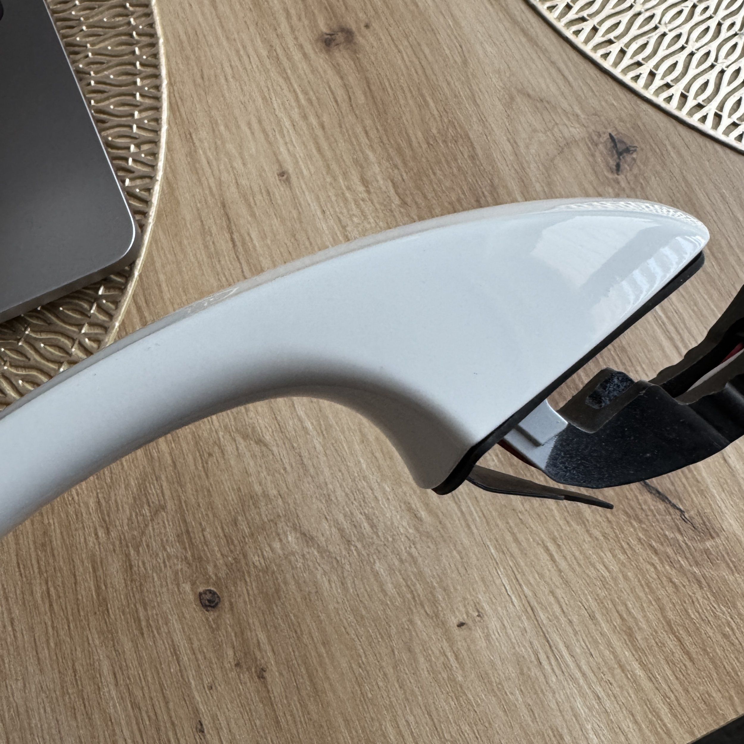

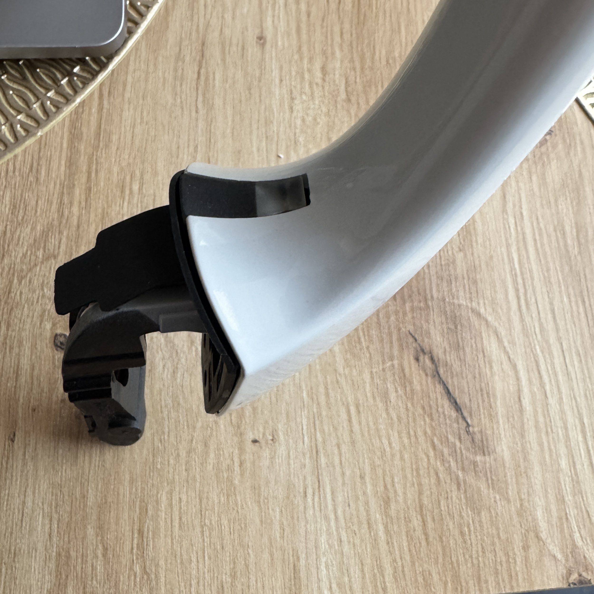

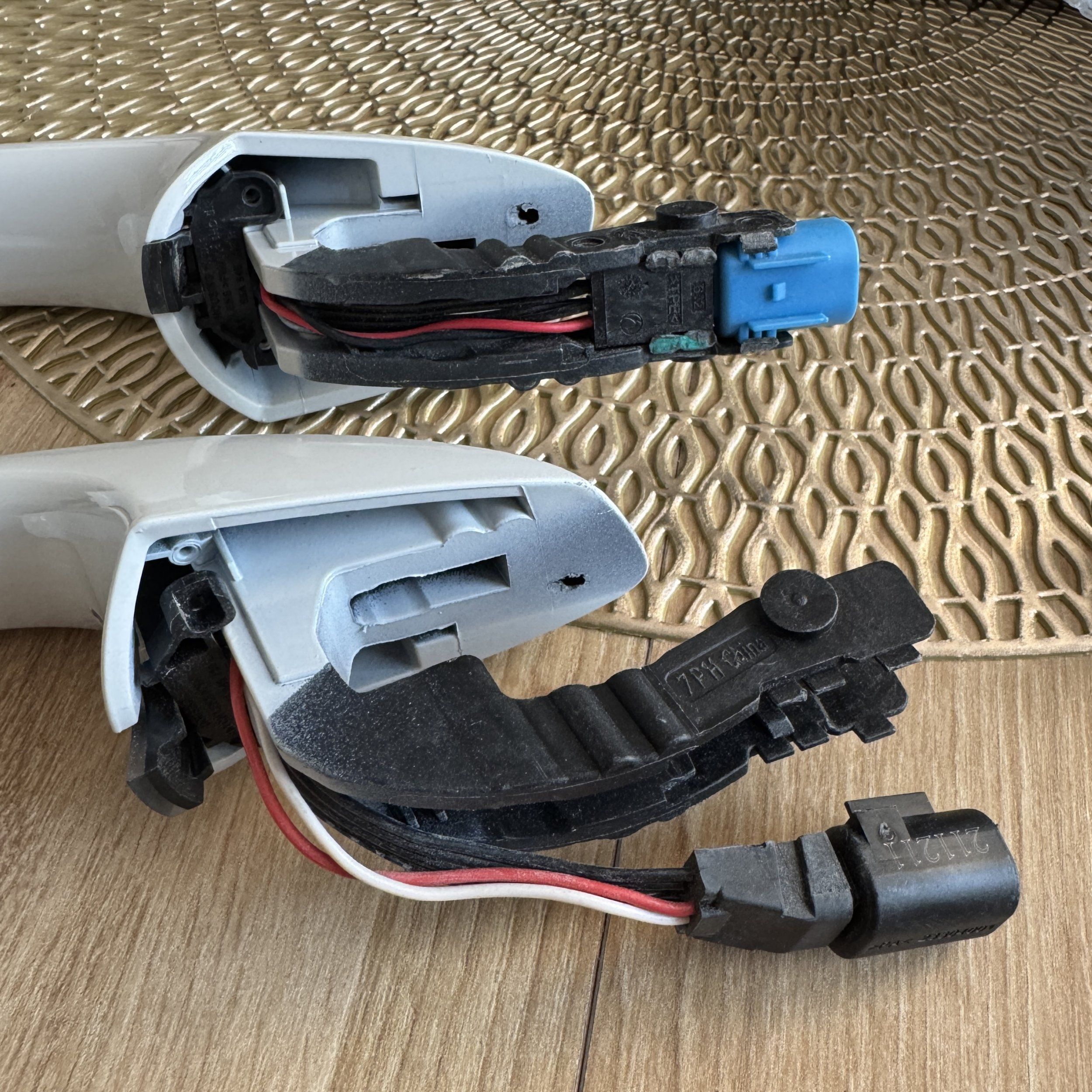

I've ordered Keyless version with cables and asked seller to paint them white. Package was definitely worse packed that previous one and was beaten up during shipping. Fortunately handles are fine, but manufacturer did some mistakes.
First of all connector in one handle is loose. It is held by some plastic tabs that needs to be melted to secure connector. This one can be easily removed so probably I will fix it by simply melting those tabs using soldering iron.
Secondly every light is missing screws. I can only guess that they removed lights for painting and forget to screw them after. They are nothing fancy so I will be able to screw them by myself. However I've contacted seller and we will see what they will reply.

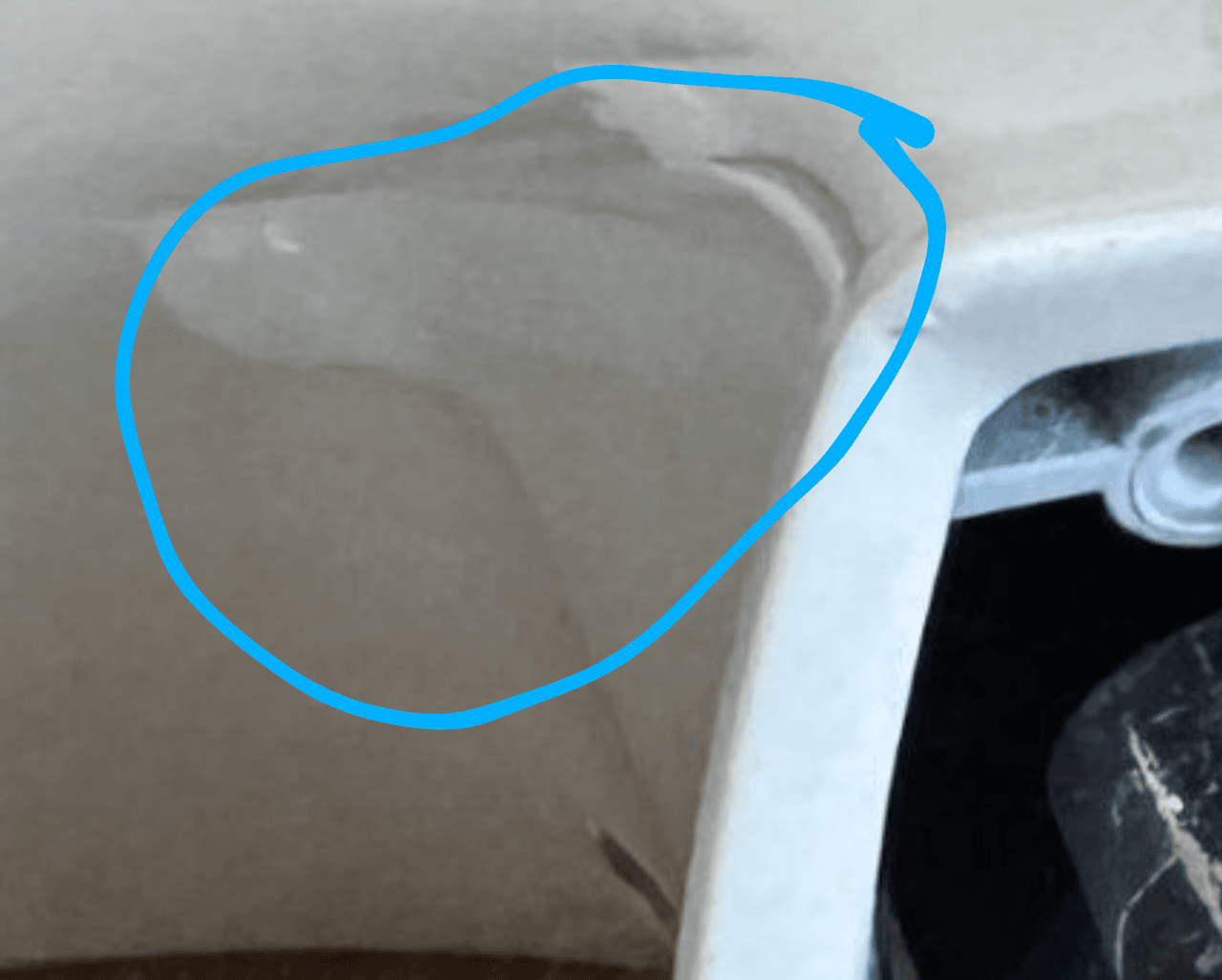

But you don't want to tell me that you are happy with the paint job?
I think you misunderstood me. It's about the paintwork. It looks terrible in the marked area...
