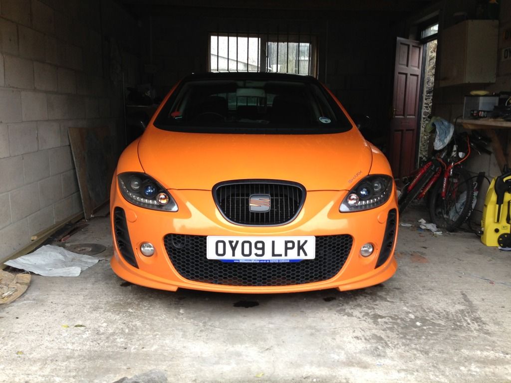

Here is a picture of mine with HID Kit 5000k pure white perfect match with the DRL leds
Light output wasnt great and nowhere near as good as my factory projectors on the audi =]

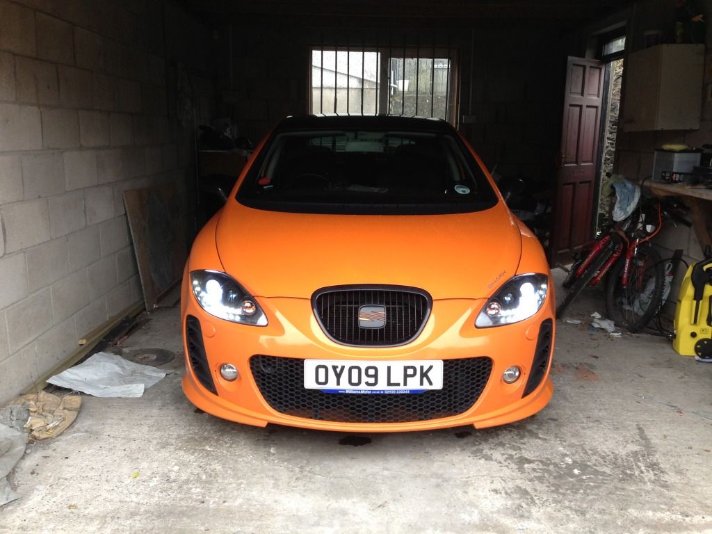

Here is a image of the light output on the aftermaket projectors on the leon
Looks like my beams where slightly out, must of been the night after fitting them, got them alligned at mot centre though

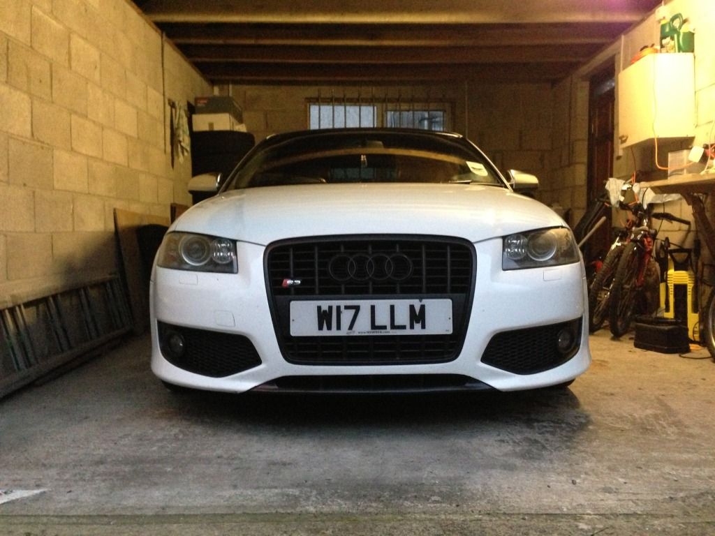

Thanks guys I do miss my old Leon, was definatly a 1 off! Took it to Audi international and had so many admirers lol
Here's a picture of my new car if anyone's interested
Will
