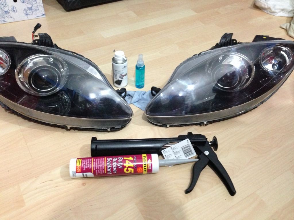

Got some Air spray to clean out whatever dust is inside, also some cleaner spray to leave a streak free finish to the reflective housings and projectors :)
Willz17
Jun 27, 2012
524
South Wales
Rob I have almost completed 1 headlight, this butyl sealant stuff is going everywhere and is sticky as hell!
However does it matter if I leave small gaps? As I can't seem to get the original black bits back into shape? I assume I can use the butyl sealant afterwards to fill in any gaps?

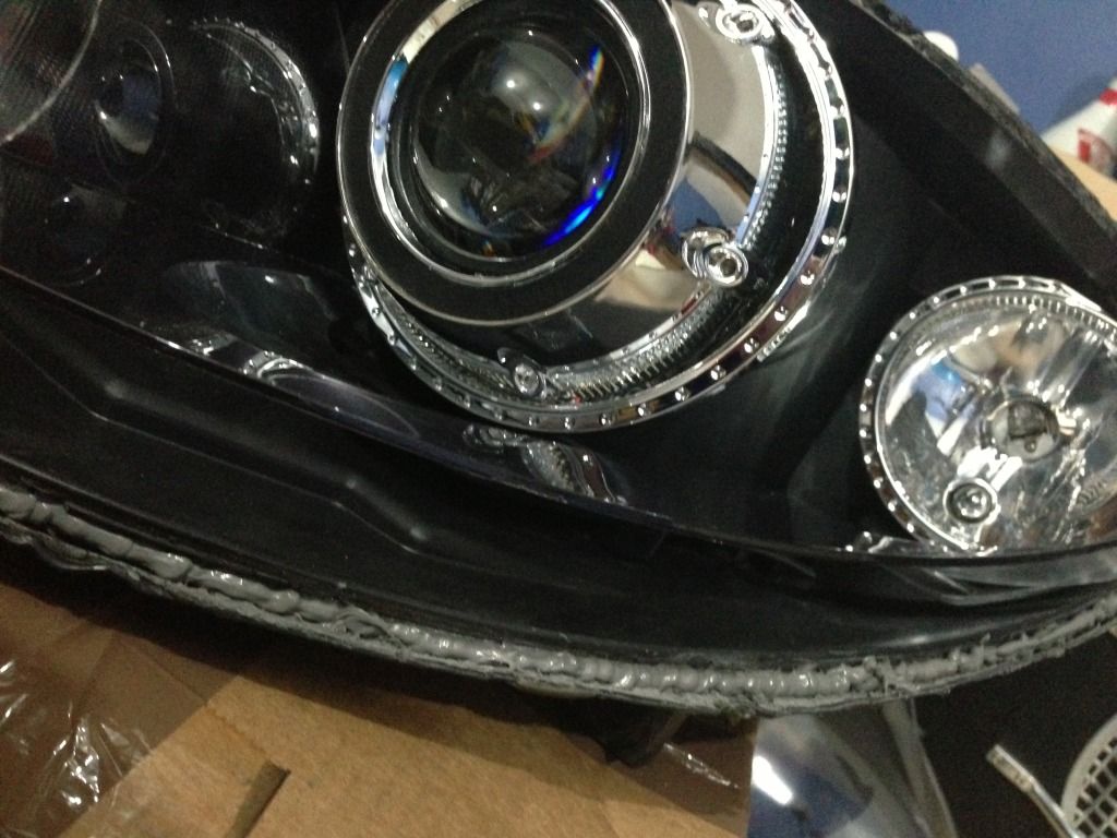

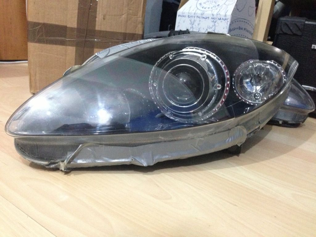

Ok so that was a right mess of a job but got there in the end!
Managed to burn myself with the sealant sticking to my hand after heating it up on the housing!
So here's a picture of the 1st one!
Used duck tape to secure it whilst cooling down!
This is the headlight still split with butyl sealant in the gap ready to be sealed
Think I will use more butyl sealant to fill in the gaps later on
Although I could leave the duck tape on since they won't be visible when fitted?
Will

Will, don't leave the tape on as it will look rubbish! Lol. You can apply some butyl in the gaps after to tidy it up and stop any moisture. On another set I did I applied a layer of black silicon to make it look tidy as the butyl I applied had already done its job in sealing....the black silicone just matches he headlights better.
Apart from that the lights are looking good!...I'll use clamps to hold the lights together but duct tape is just as good!
