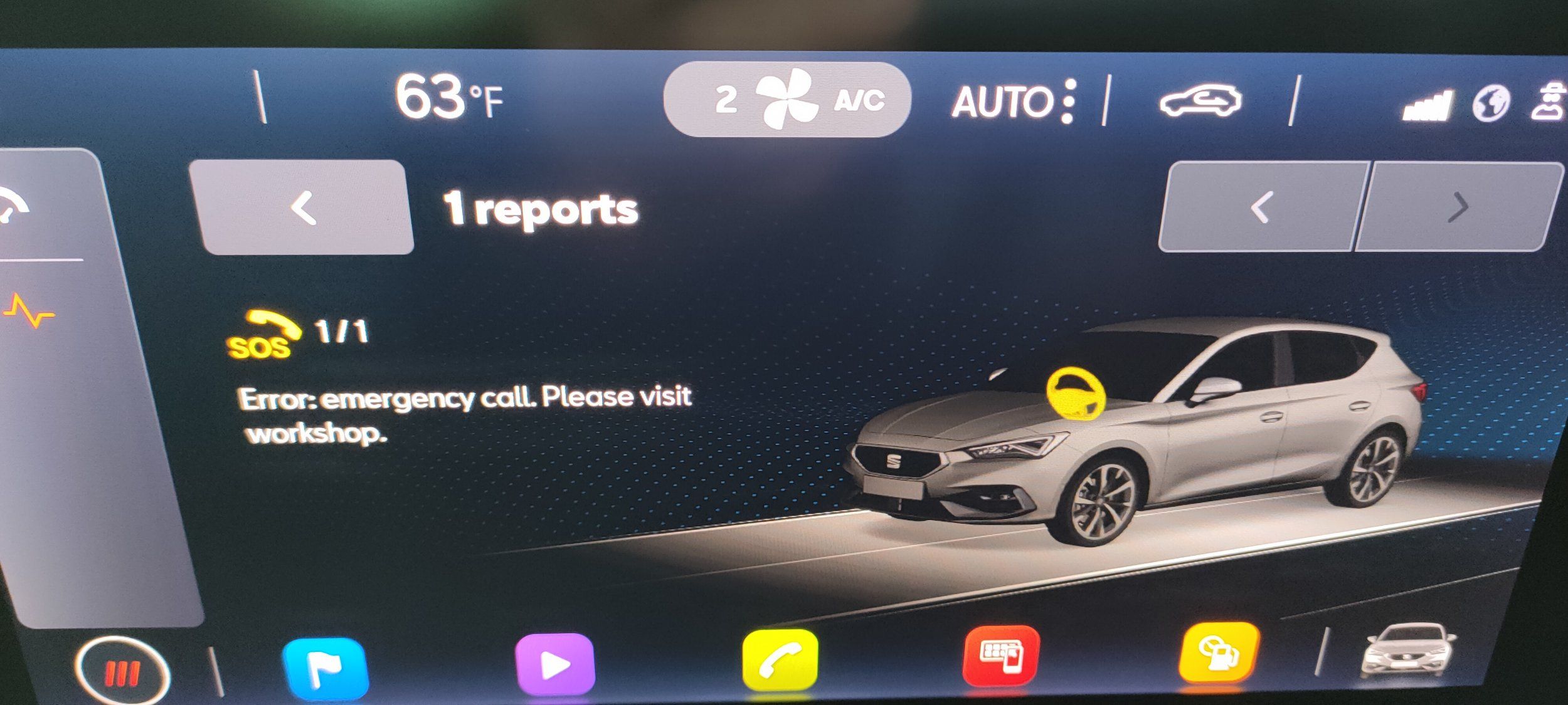

Hi guys.
While parking up my 2020 Seat Leon 1ltr TSi SE Dynamic earlier today I got a notification chime and a symbol that suddenly appeared on my Instrument cluster screen. It's says that there Is an SOS emergency call error? I've tried to get rid to It by scrolling through the settings etc but to no avail. Is there any way to remove this notification myself or does the car have to be taken back to a main dealer?
Cheers lads ?
Ps : I'm guessing that this SOS emergency call error symbol Isn't anything to worry about and won't effect the cars driving In any way?
Press and hold the SOS button for 20 seconds. The system will reset.
After the reset, it will try to make an emergency call, cancel it on the screen.
