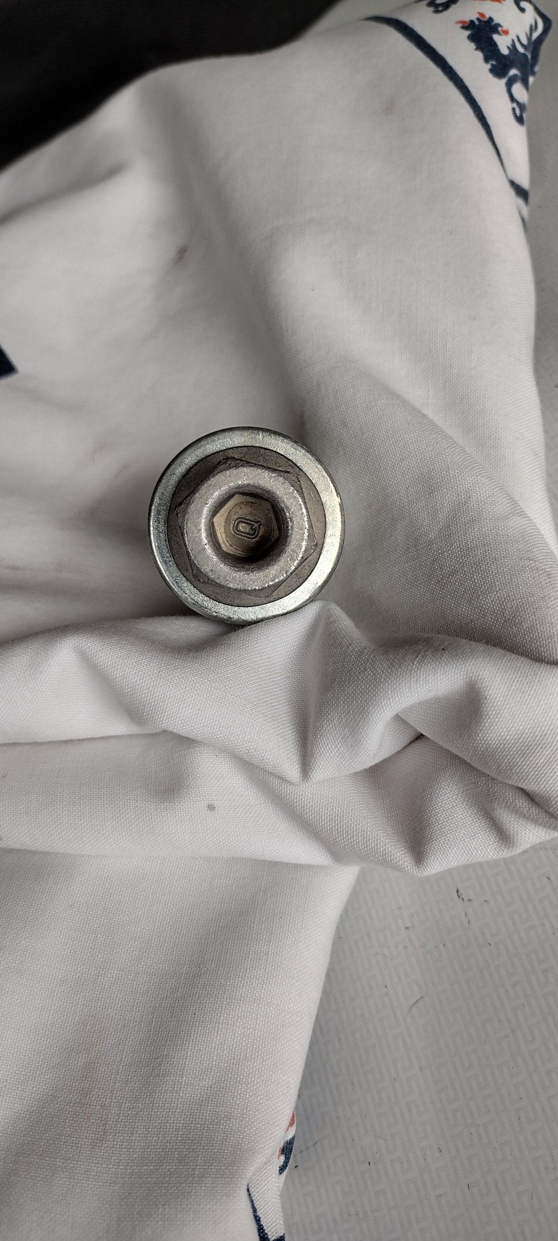

As per the information in the owner's handbook, I today went to make a note of its serial/code number.
But there's nothing on it at all - seems a bit daft if you need another.
At least it fits!
There won't be a serial number, but there will be a letter stamped on the top of the key. That corresponds to the parts system and dealer master set, it can be ordered through that method.
Reactions: Loadmaster748
Also if things go pete tong you can take a picture of the locking nut and order key online, I have done that in the past.
Or bin the blooming things and replace with a proper lug bolt.
That way you stand a better chance of not shearing them off when the tyre place has windy-gunned them back on at about 3000 NM
I'll check again, but I'm certain that there were no markings at all on mine.

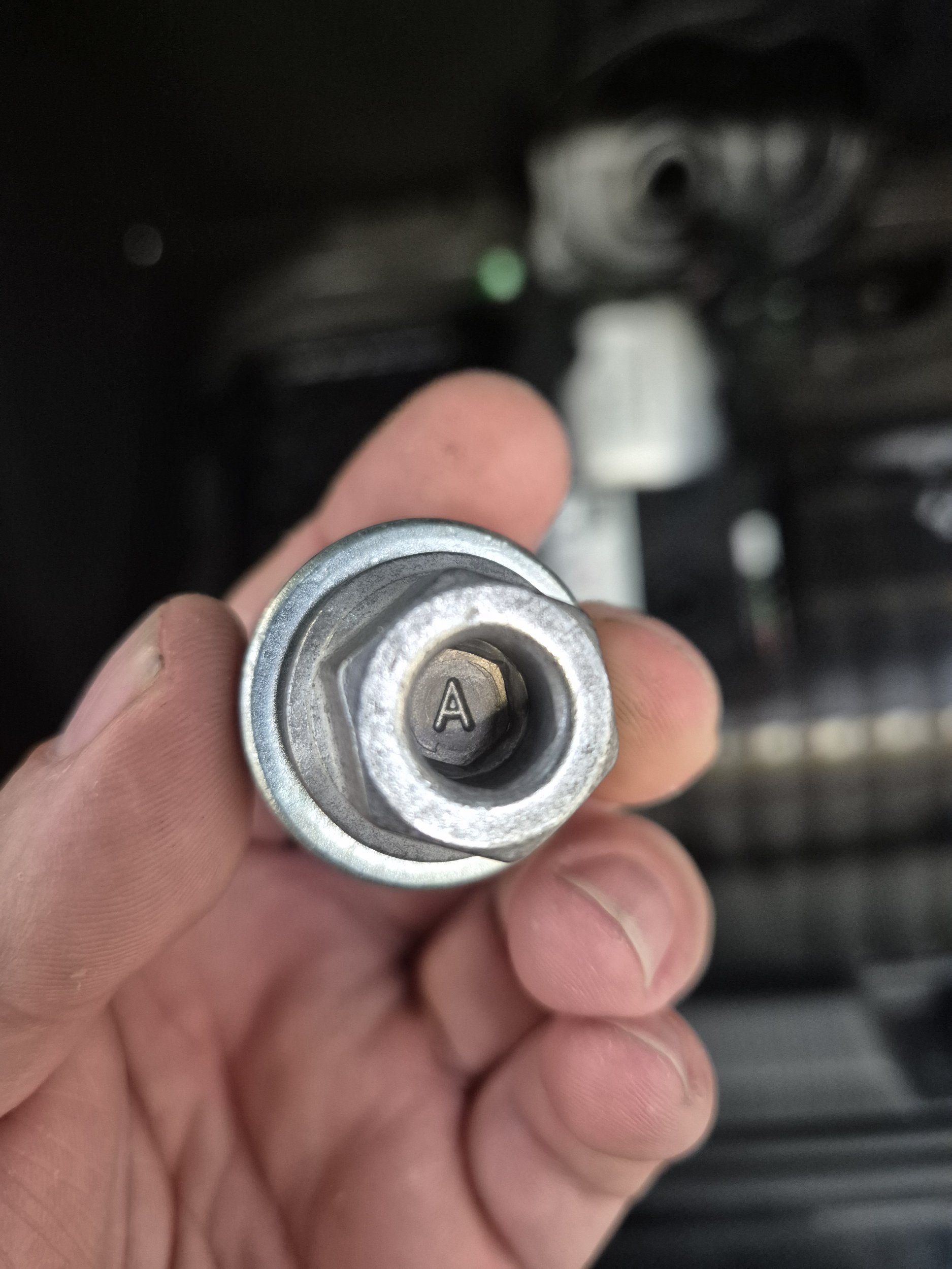

Ahhh...
There I was previously looking for a multi number code and it's just one letter! Mine is 'Q'.
