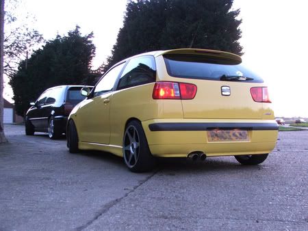

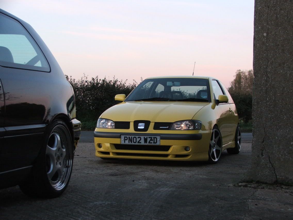

Do you have a picture showing front wheel and arch level. Very interested to see how much gap there is.. maybe I am going to be in luck myself :)
thanks
I wanted a wide stance anyway, but had to use 20mm spacers to clear the Brembos :D
Here's a piccy.
ibizacupra
Jack-RIP my little Friend
Jul 25, 2001
31,333
19
glos.uk
adjusted the gammer correction now.. brighter and cropped.
The wheels stick out of the wings dont they?
You said ....
"I'm running 7.5x16 with 20mm spacers on the front and 30mm spacers on the rear"
20mm per side front spacers and 30mm per side rear spacers.. Is that right? on ET36 rims in 7.5J x 16
