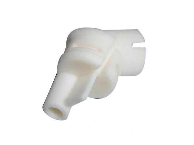

Where to find location water drain valve ? And where to sit this is part number ot part 6Q1820120. My miss and when i on air conditioning from right pasanger leak... Srry for English...

@Ant1Lamer, are you asking about the coolant drain tap/valve on the radiator, or the condensate drain valve for the Air Conditioning plenum, if it the drain valve for the Air Conditioning, it will be found under the bonnet/hood against the firewall, quite low down maybe on the left hand side of the centre of the car - or maybe the right hand side of a left hand drive car like you have, and also maybe covered by the sound proofing covering.

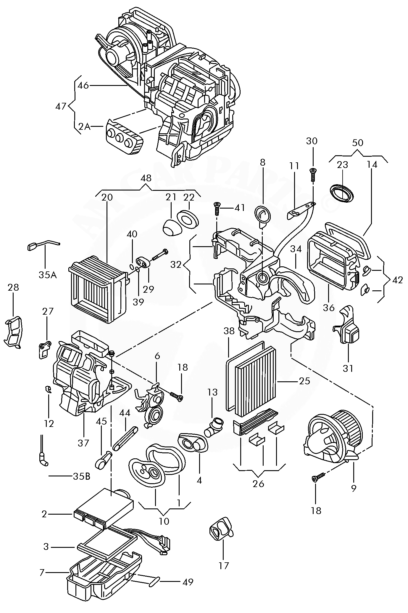

this, nuber 13 chek in google this part number 6Q1820120 condensate drain valve for the Air Conditioning

Yes, it passes through the fire wall/bulkhead and what you should be able to find under the soundproofing will be the rubber part that valve fits into. Someone with a newer version of Ibiza/Polo/Fabia discovered that the rubber part was incorrectly fitted and was blocking the flow of condensate out of the air box, so water was escaping into the cabin instead of being allowed to escape outside of the cabin.
Edit:- item 13 fits into items 4 and then item 10.
