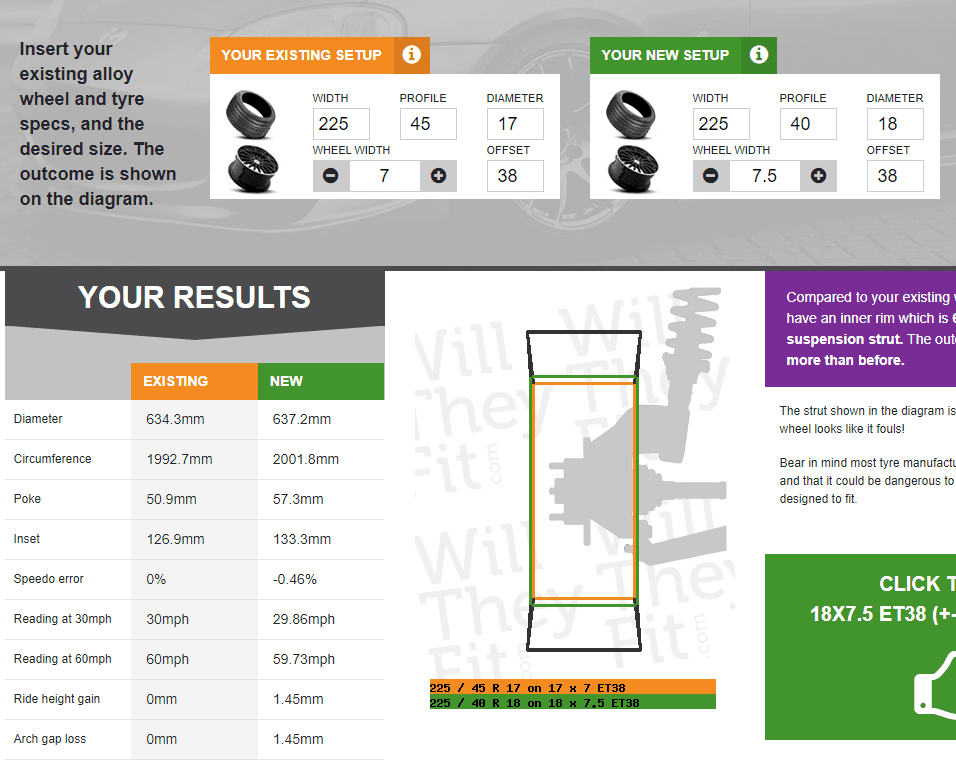

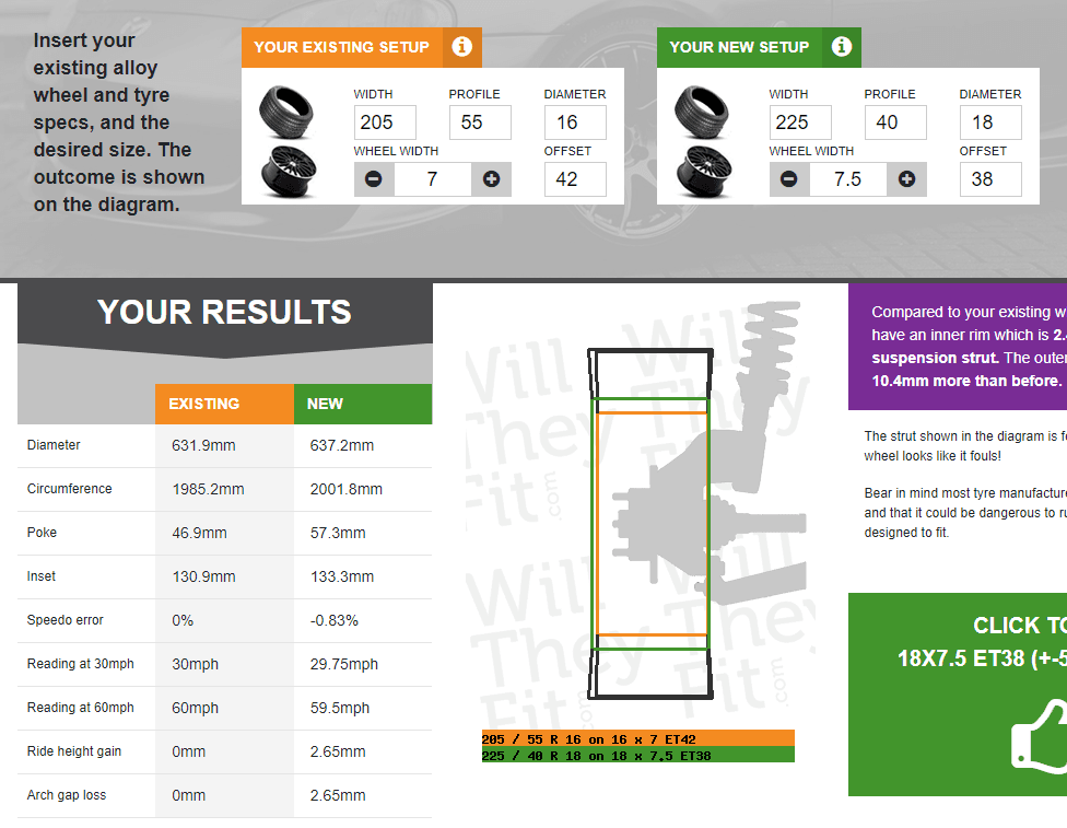

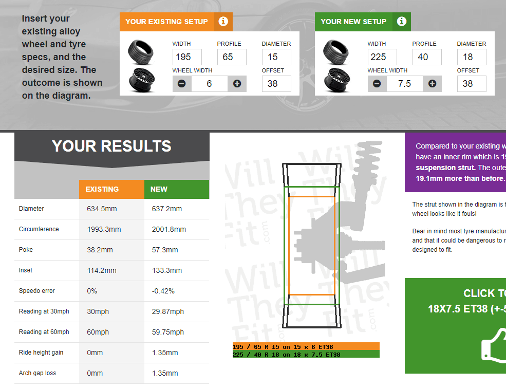

Attached screenshots show difference of 18" wheels with each smaller size.
Tire sizes, wheel widths and offsets entered are actual Leon Mk1 values, gathered from parts catalog and sources on the net.
