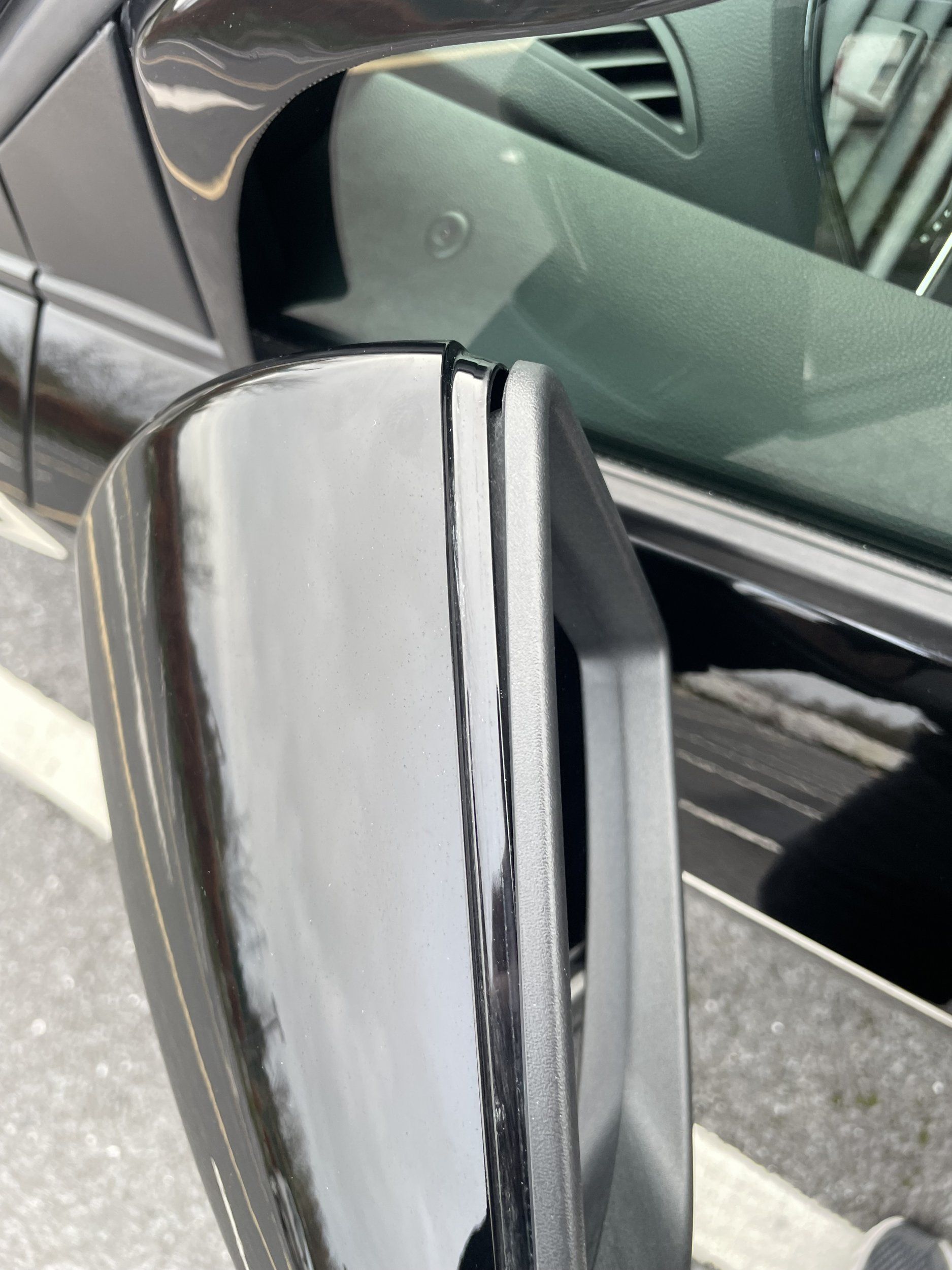

Hi all, picked up my new 2019 cupra 290 yesterday and noticed the wing mirror like this, I’m scared to force it back on in case it breaks does anyone know if there’s a clip it should hook onto of some sorts? I don’t want to go back to the garage if its an easy fix, but also don’t want to break it🤣 thanks in advance

If I remember correctly, there are at least 3 clips for the cover. If you apply some pressure along the top and the top corner nearest the glass it should clip back in.
The 2nd half if this video shows the clips:
And this one is quite good at showing the stage I just described:
