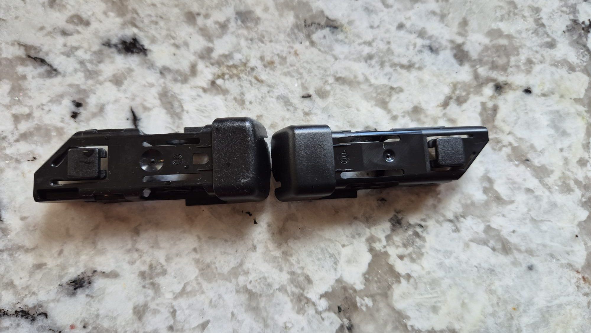

So, after 8 weeks with the smeary stock wipers I took the decision last week to replace them with new Bosch Aerotwins - Halfords were doing an offer so I thought I'll change them...
So being a smart a*se (or so I thought) I noticed they were selling them as a pair at a considerable discount compared to buying seperately...coded as A864S so I bought them for a few pennies over £20.

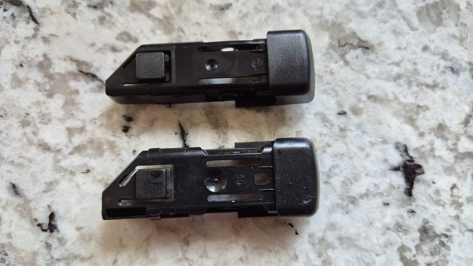

I hadnt bothered to fit them until today and it was just now I realised the fitment clip on the Cupra ones is a few mm larger than the Bosch one - as seen in the attatched images! So I was thinking its back for a rather embarrassing exchange and more money...
But fear not LOL, a simple 2 second eureka moment and I pinged the clips off the old wipers and fitted them to the new Bosch wipers and presto - problem solved!
Anyhow just thought I'd share this rare piece of wisdom on this otherwise boring day! :ROFLMAO: :ROFLMAO: :ROFLMAO:

Nice fix, but bad that Halfords sold you the wrong ones for your car in the first place.:confused:
would have said on the back of the box what they,
i think the newer shape has a different connecters front and back. lucky you were able to take the old connecter off :)
