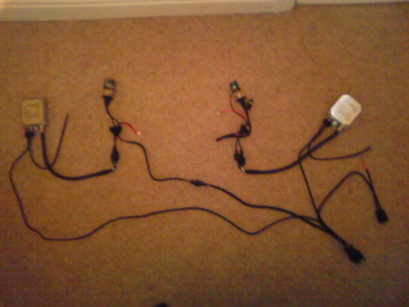

aimes can you put a pic up of your xennon kit and all th wiring clearly layed out :thumbup:
ive worked out that the red and black spade clips go in the connector that goes onto the bulb inside the headlamp itself but im still stuck on where the harness interlinks into the xennon kit

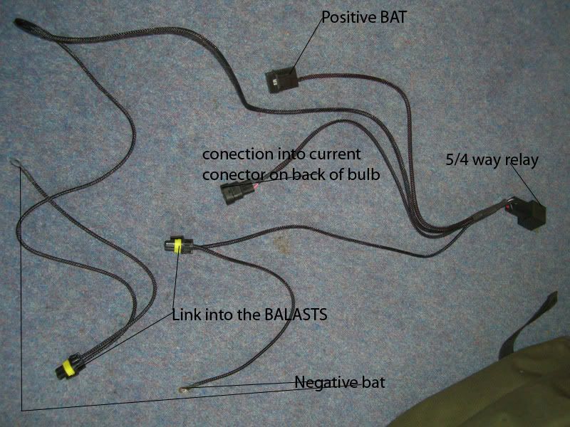

Looking at the pic the harness looks like the designed has no concept of electronics. All the harnesses i have made/used have been fused in the connections from the power from bat and on the connections to the ballasts.
it should also have a H7 connection on the connection into existing headlight.
The negative terminals coming from the ballasts are a bit strange as well, it looks like they are expecting you to connect this to the body work??????
well here is what I make of it.
^^ nice try monk that pic isnt great tho and what you point too as positive battery is a fuse holder. but there should be a red connector comingoff that with a positive connector on the end of it (check my pic below) but this is what i make of it along side my xennon kit
the two (red/black spade connectors) wires that are near the hid bulbs plug into the *U* shaped connector inside the headlamp that origionally plugs onto standard bulb.
as using this *saftey relay harness* we are runing the power directly from the battery instead of round the whole electrical system you dont need to plug 1 of the connector coming off the hid bulb and just use 1 of them
1 of the black earth points needs to be earthed (very good BODY earth) and the other black point needs to be bolted to the negative on the batery
ifyou get it out and have a hard think it actually becomes VERY SIMPLE and i recon il have this working and all wires hided ect in 20mins :D all i need now is my car!
