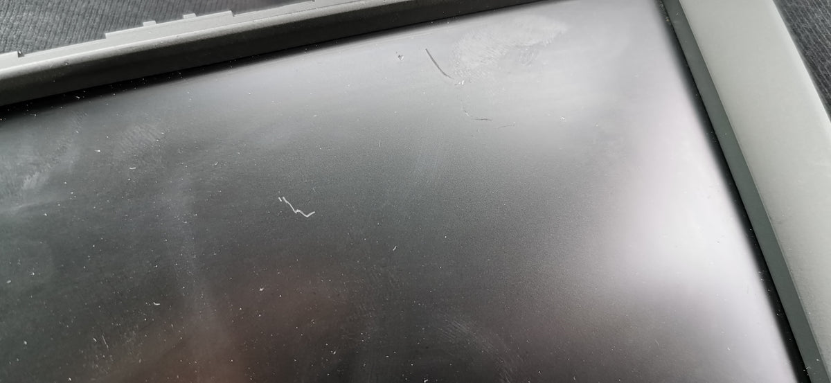

Hi All
the sat. nav in my 2019 Leon has started acting very weird.
I will set a route and start following it and then I can hear clicks ( like someone is touching the screen) and things will change- for instance a n address marker just popped up and asked if I wanted to navigate to it. then the existing route stopped until I pressed the little car icon on the right.
Its just like a ghost is touching/playing with the screen!
It did this about 3 times in a 10min journey.
Any ideas on what could be causing it?

It sounds like the touchscreen might be damaged, but I'd start with rebooting the infotainment system. Press and hold the power button, and keep it pressed until it powers off and then it will come back on, then release the power button.

This has happened to me too. I found that the screen had condensation on the front and after drying it off, it was fine.

It seems to be a common problem caused by condensation on cold mornings. Had it on two out of the four Leons we've had. I think giving the screen a wipe with some sort of screen cleaner might help but I'm guessing.

I wiped the screen before I started the car ( it wasnt damp) At first it was very unresponsive to the touch, then after 2 min it stared to do its random switching !!!

Dealer has come back to me saying that that have found some who will replace the digitiser but wants the car for a few days.
This is a huge pain as they are over 100m away.
I am tempted to say that I will remove the unit myself. Presumably the car is still driveable without the touchscreen?

It's a bit of a PITA to remove the facelift screen, it can only be done by removing the vent assembly and operating the spring loaded lugs that secure the screen to the surround.
