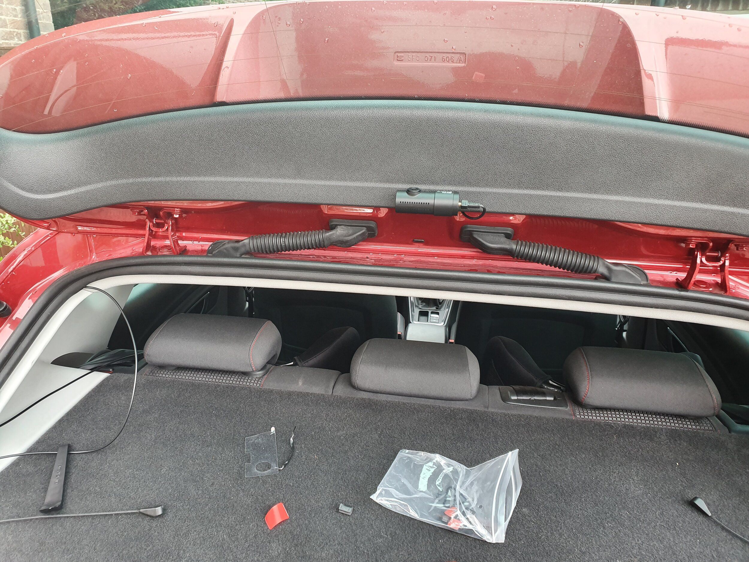

To begin with, I started with the rear cam as this is the longest part as you have to route the wires along the car to the front window screen. I also opted to wire the cam in through the cable routing for the boot lid, so that when the boot is opened, the cam stays attached to the boot and moves out the way. I've had a cam fitted to the roof lining before with a previous car and found it got in the way whenever I need to put the seats down and fill the car with stuff.

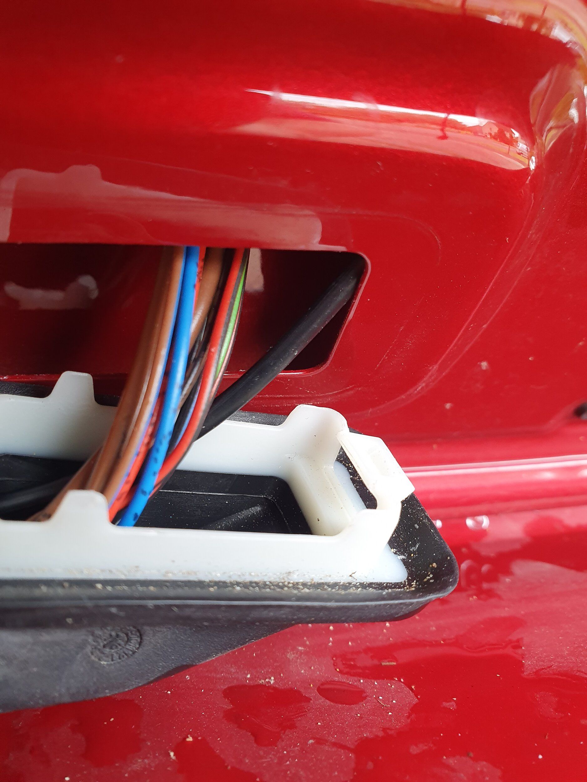

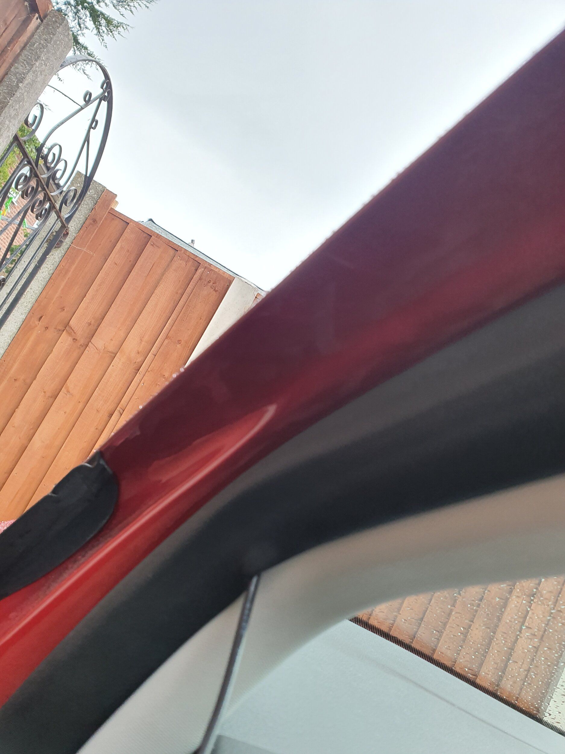

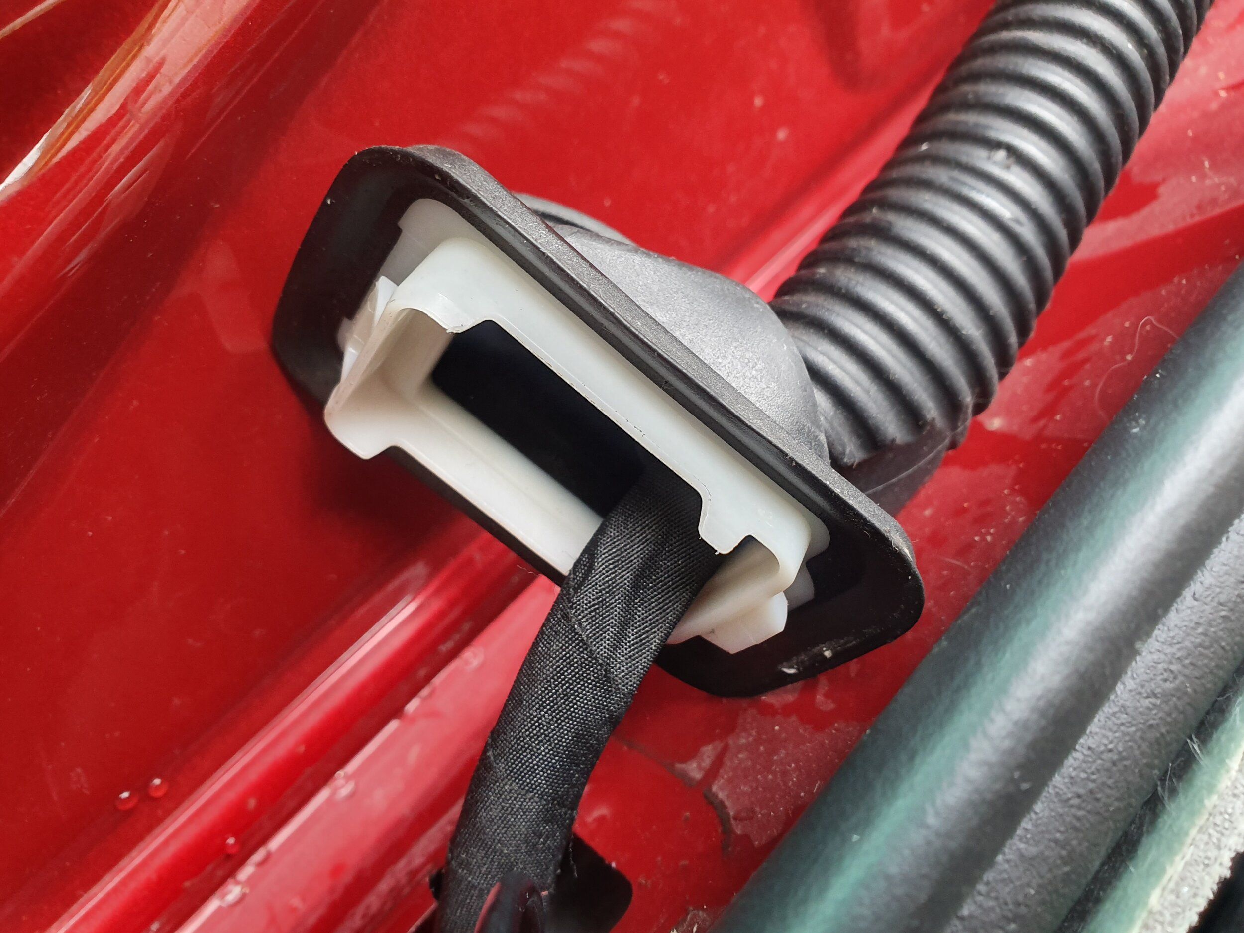

First off, I un-clipped the rubber boot that routes the cables between the chassis and the boot lid. These are held in place with a plastic clip on the inside. Be careful not to damage the tabs on the sides of this clip, as the pressure it holds the rubber down which prevents water ingress into the roof lining. I used the nearside (Passenger) one to feed my cables through. I used a flat bladed screwdriver to pop the clip up and out of the recess it sits in:

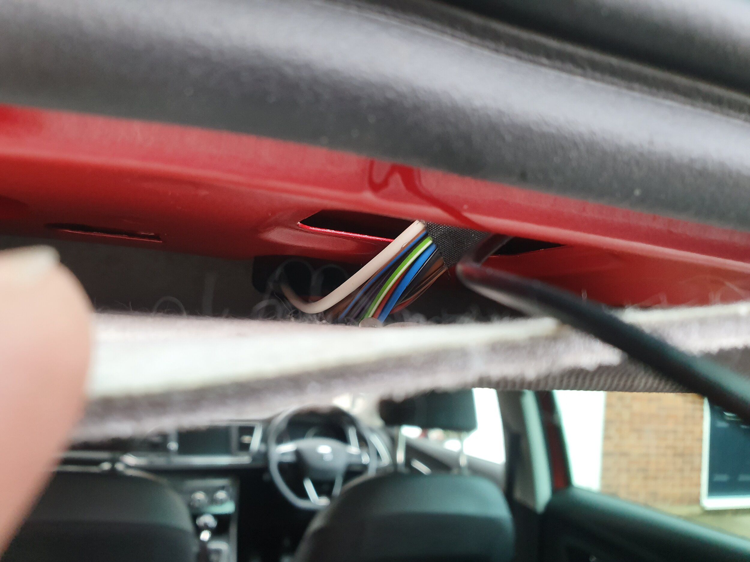

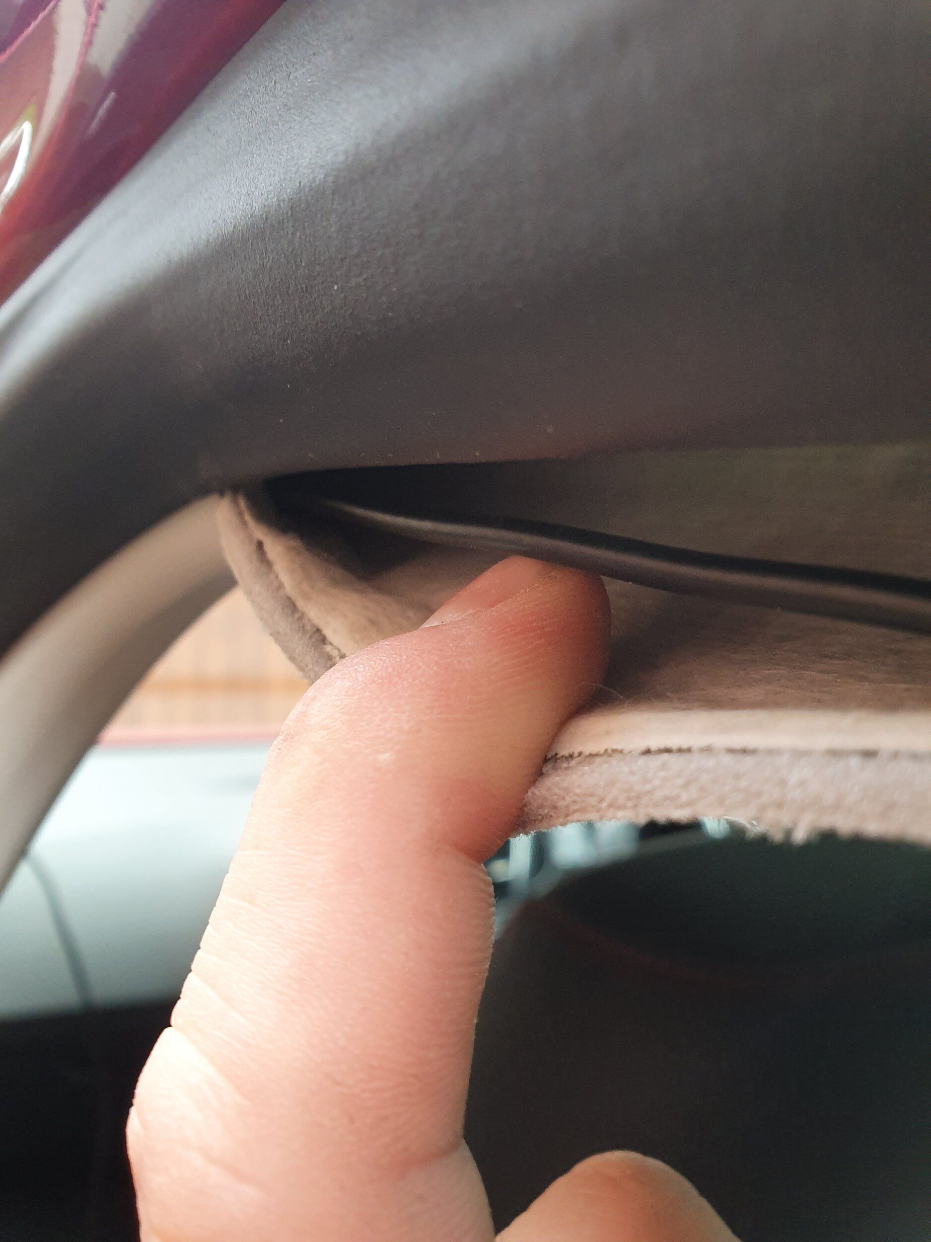

Next, I pulled down the rear of the roof lining so I could insert my cable. It tucks in under the seal for the boot and easily pulls away. You don't need to put it way down, just enough to be able to get the cable into the hole underneath:

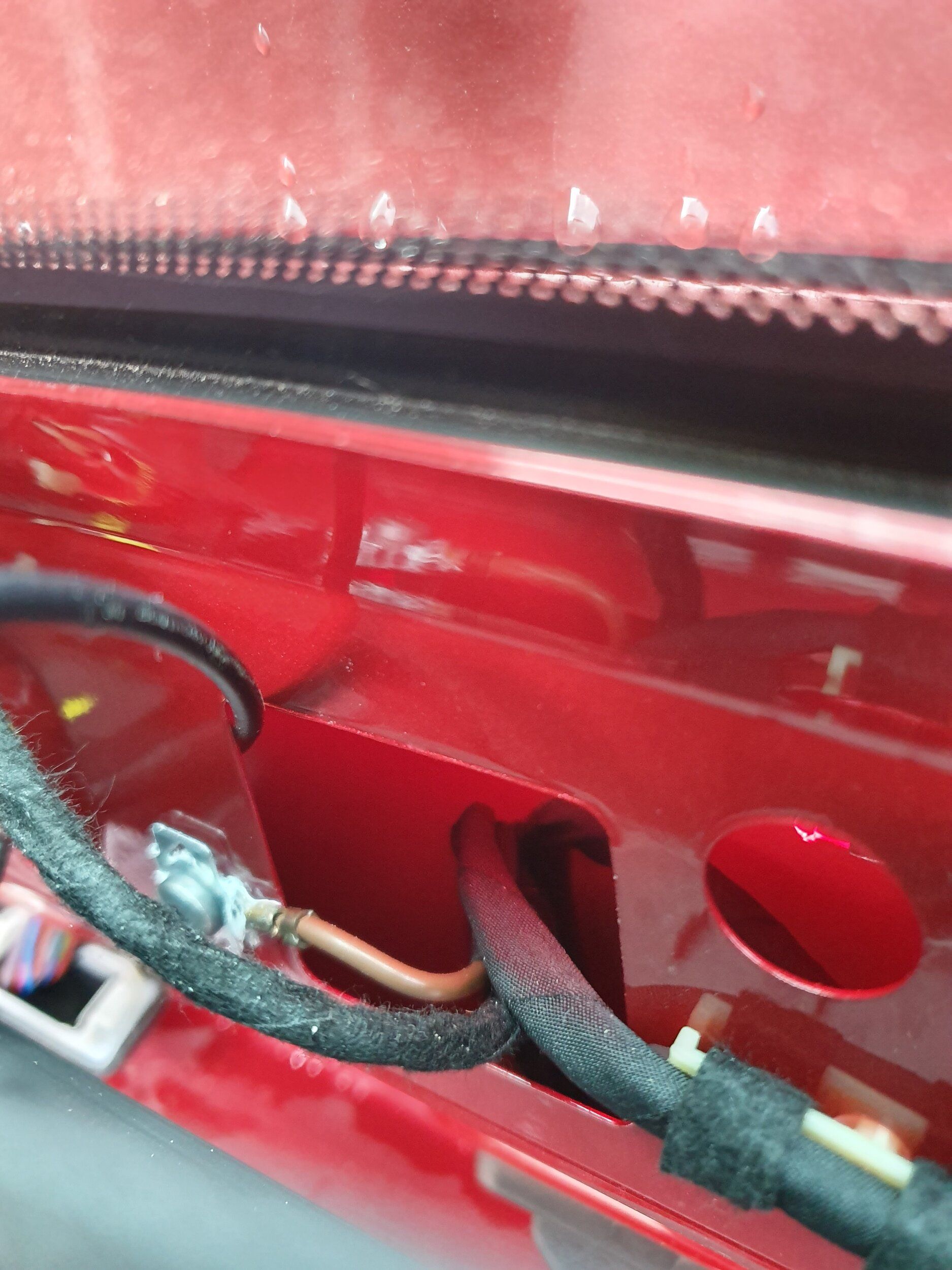

Then, you need to feed the cable through this hole, and out of the hole you uncovered when you un-clipped the rubber boot housing the boot lid cables:

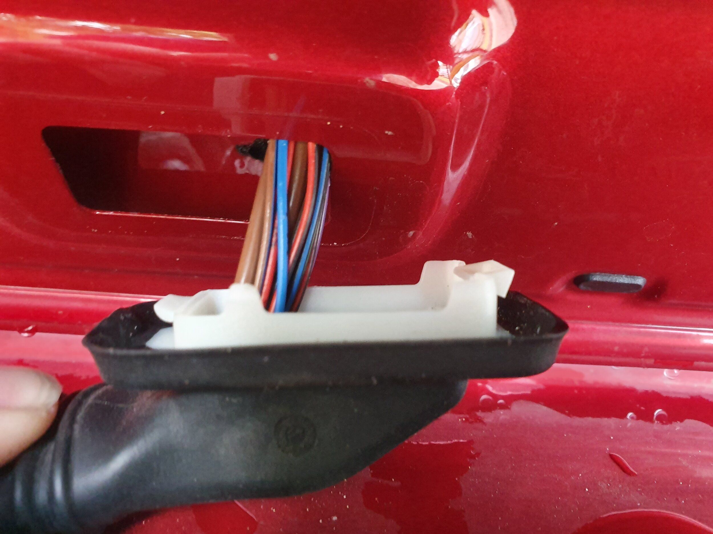

Now you can un-clip the rubber boot from the boot lid. It's the same process as the end attached to the car body. Again a flat bladed screwdriver can be used to do this:

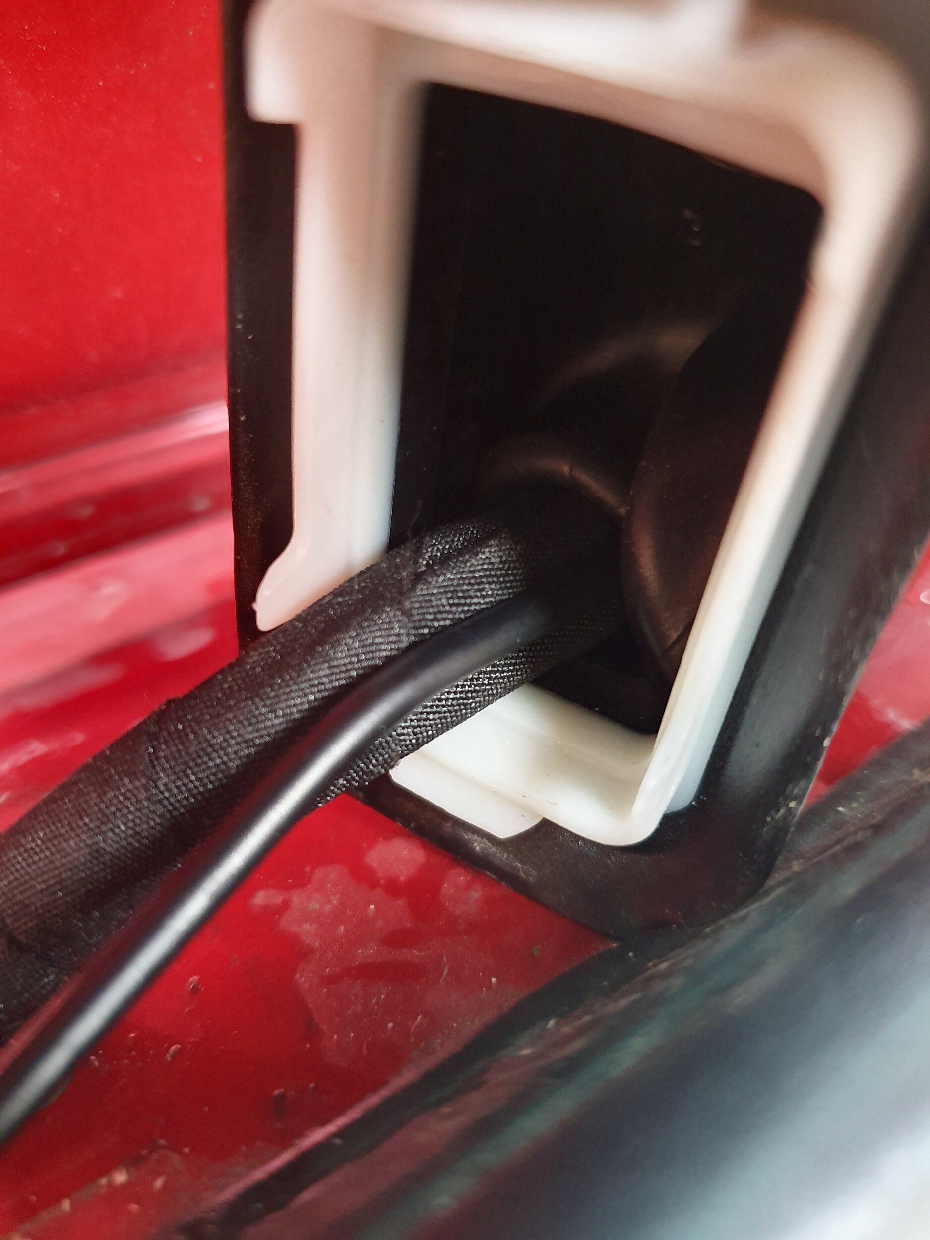

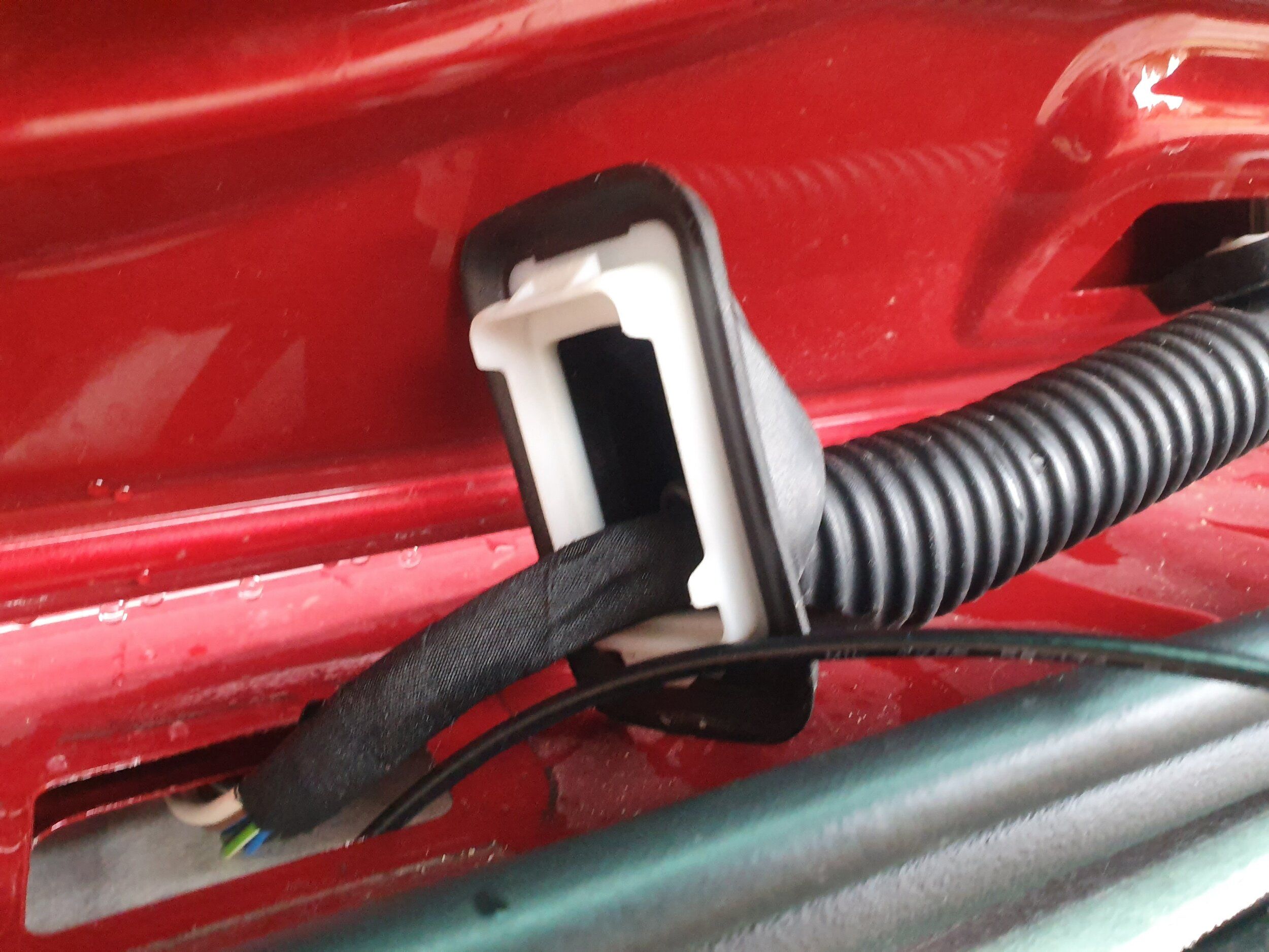

Next, you have to feed the cable into the rubber boot. At first this can be tricky as it is a tight fit and takes some time and patience, but it can be done, trust me. I found it helpful to grip the cable from the outside of the rubber boot and slide it up, stretching the rubber as I did it, while pushing the cable in from the outside. Let go and repeat until it pop out the other end:

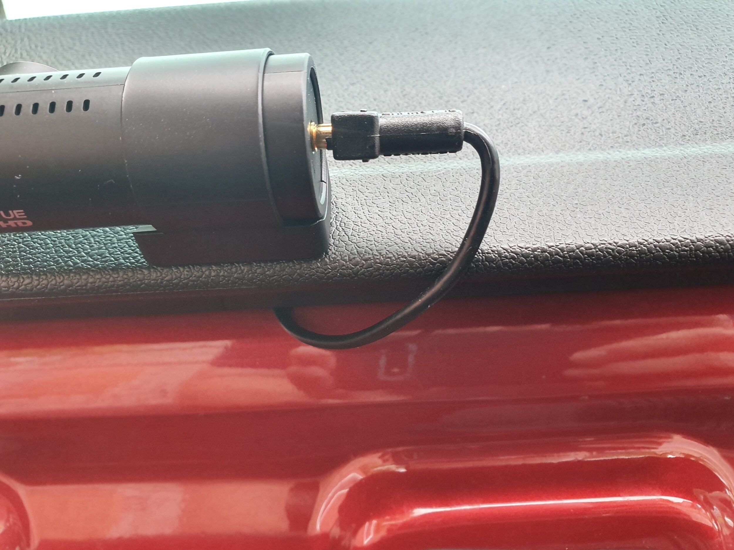

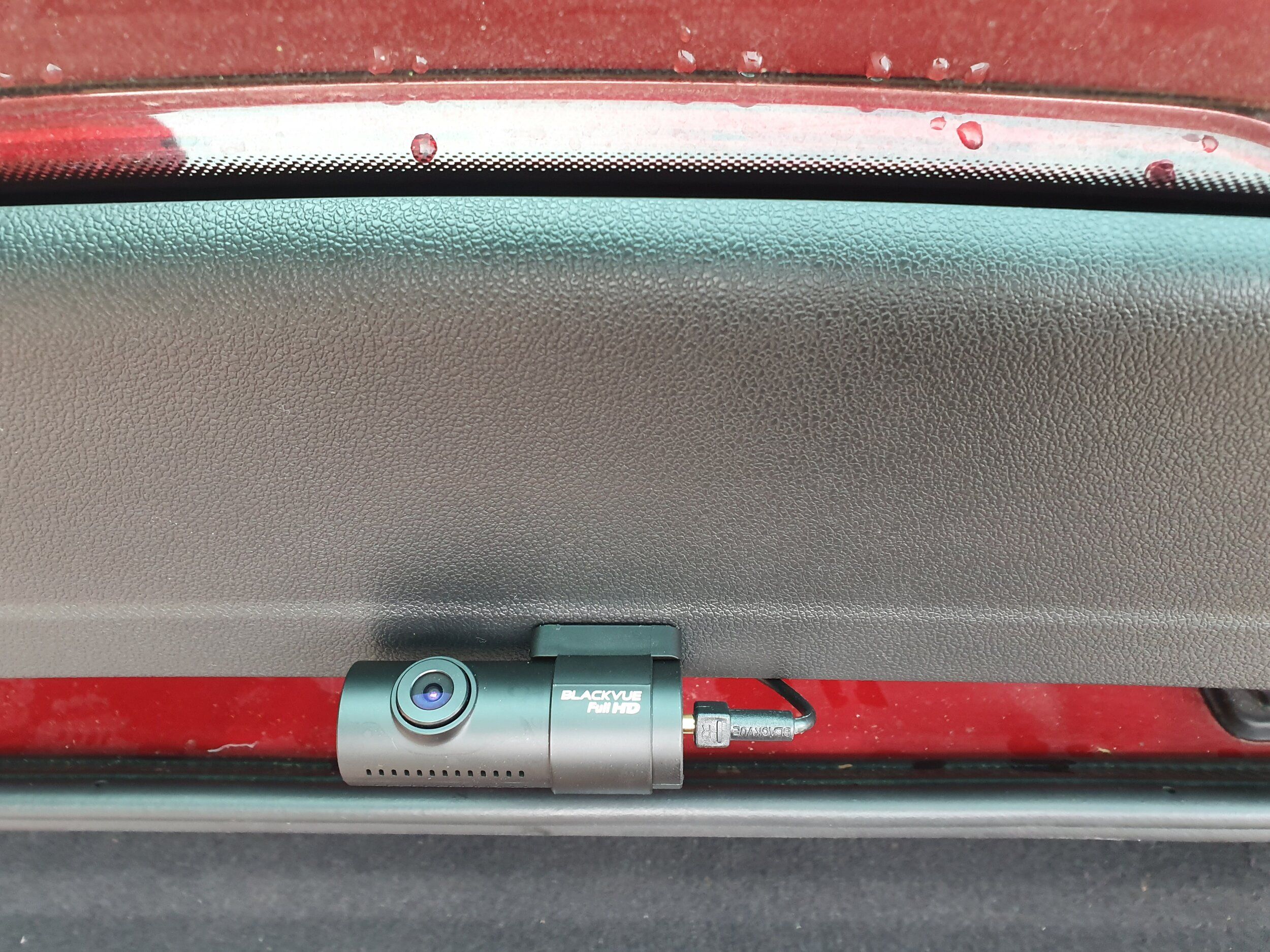

Once this is done, feed the cable out to where you want to position the camera, mount the camera to the plastic trim and refit the trim, hiding the cable beneath it. The trim will simply push back into place; you may need to bang it to get it to clip back in fully; I did:

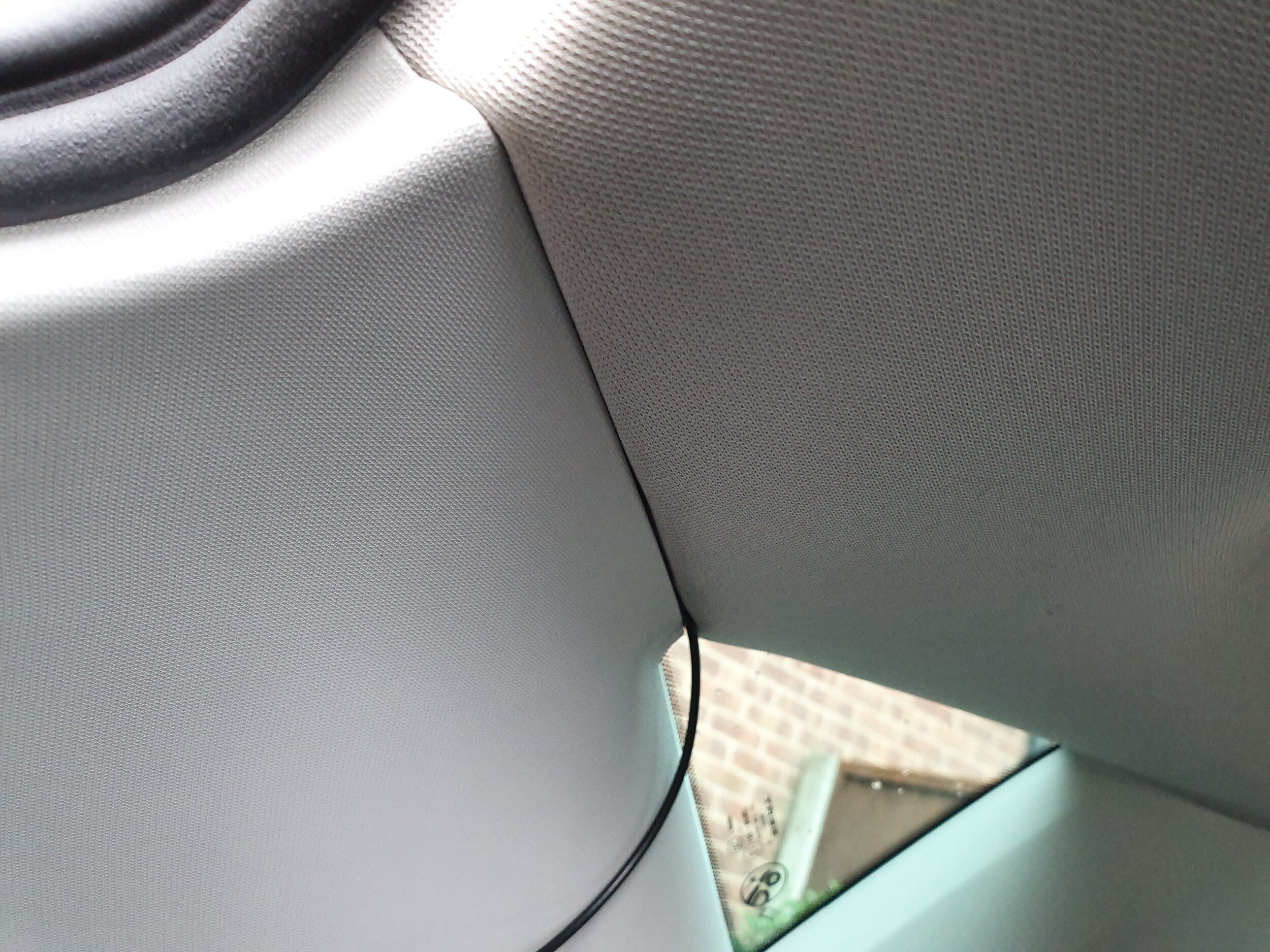

The next task is to route the cables from the rear to the front. To do this I used a trim removal tool provided with the dashcam kit, but a clean flat blade screwdriver with also suffice. You can see I have already begun to route it along the edge of the roof lining:

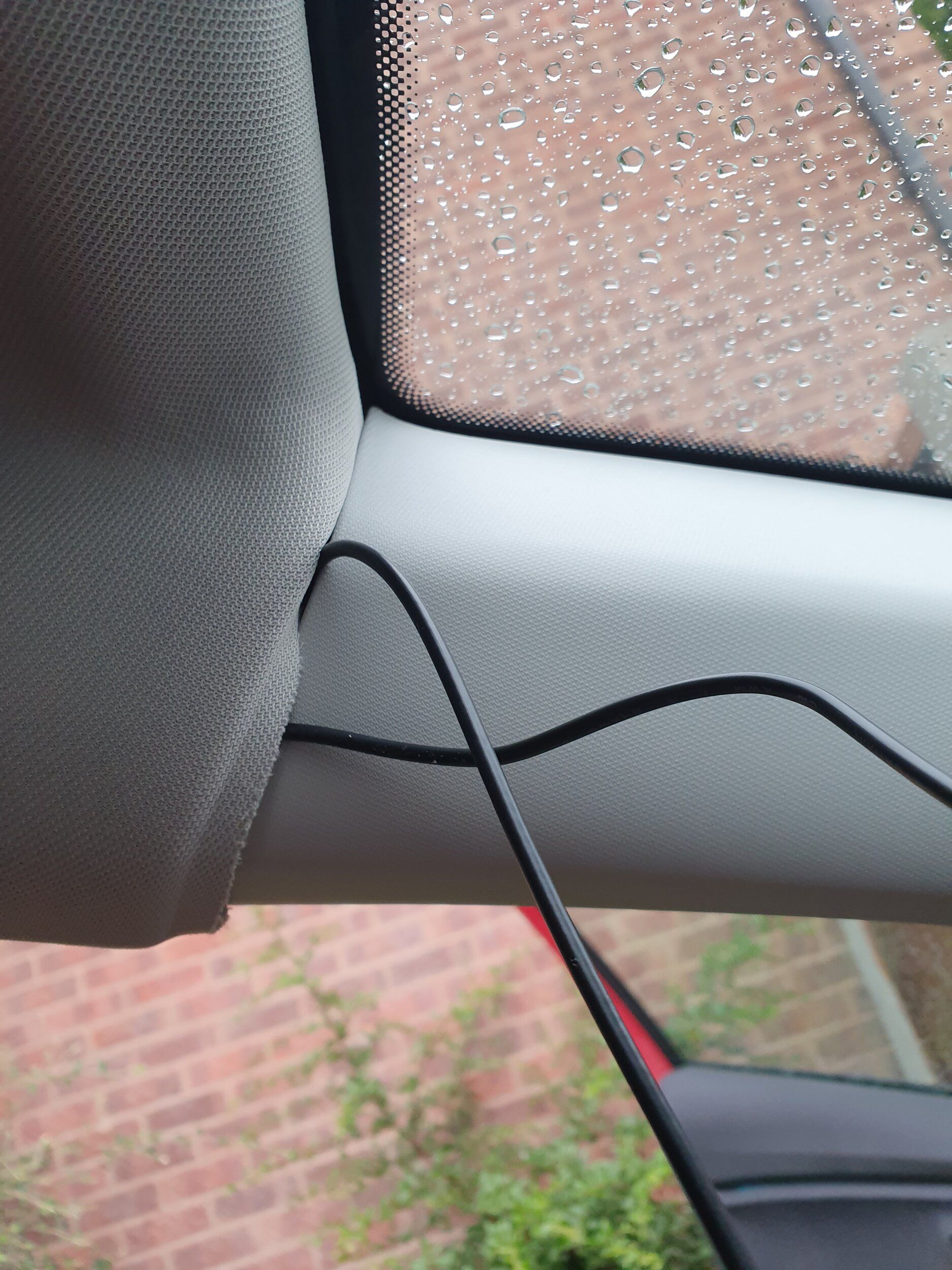

Now you just need to basically push the cable into the gap along the roof lining and other trim parts. You can use the trim tool or screwdriver to help push it into the gap, but be careful not to damage the cable. When you get to the rear door, you can again pry the lining down from the door seal and push the cable underneath to tuck it neatly away:

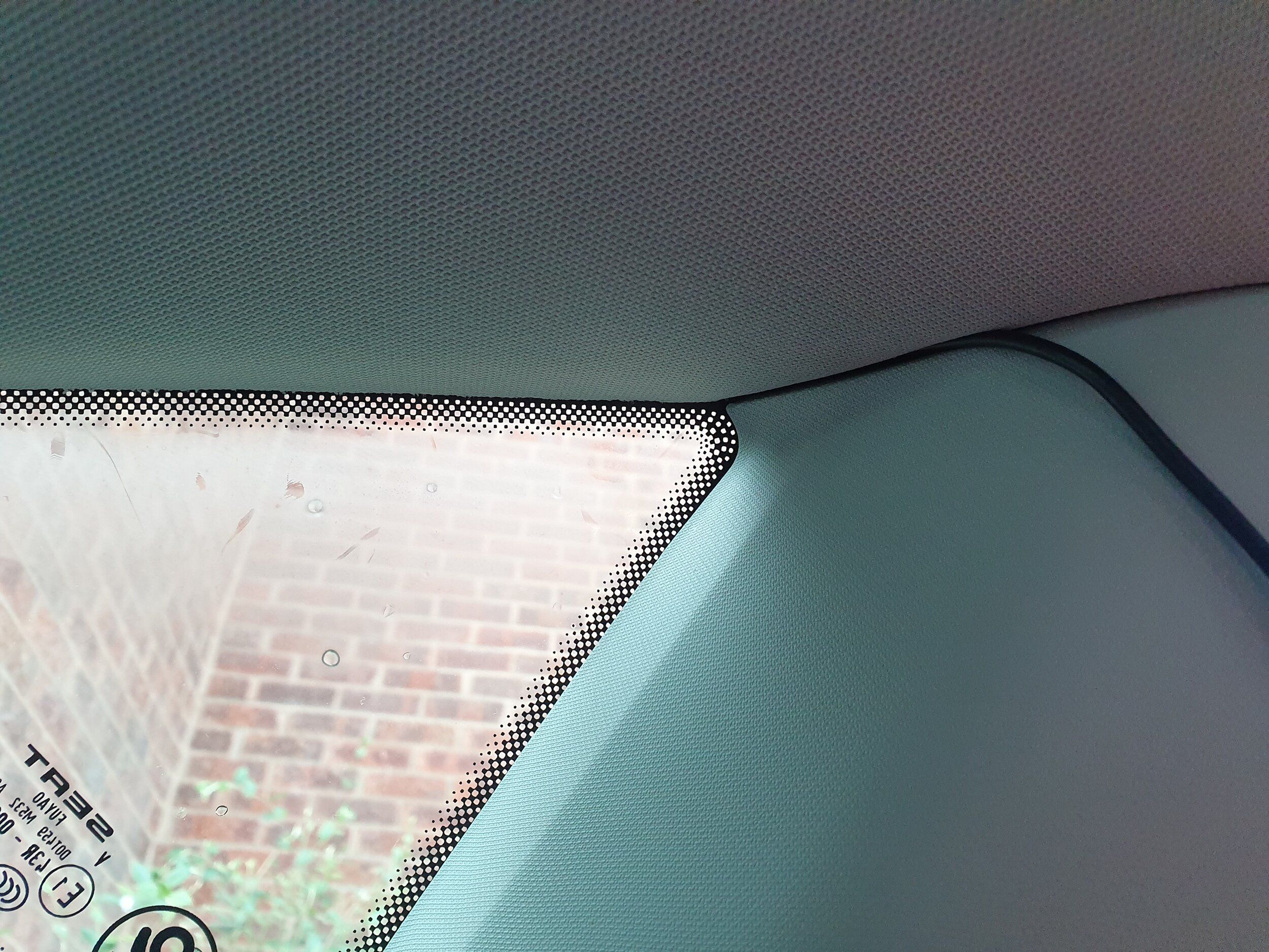

Do this all the way to the front A pillar next to the window screen. Once here, it is time to mount the front camera and power cabling. Leave the cable here at this point as you now need to route the power cable in the same area.

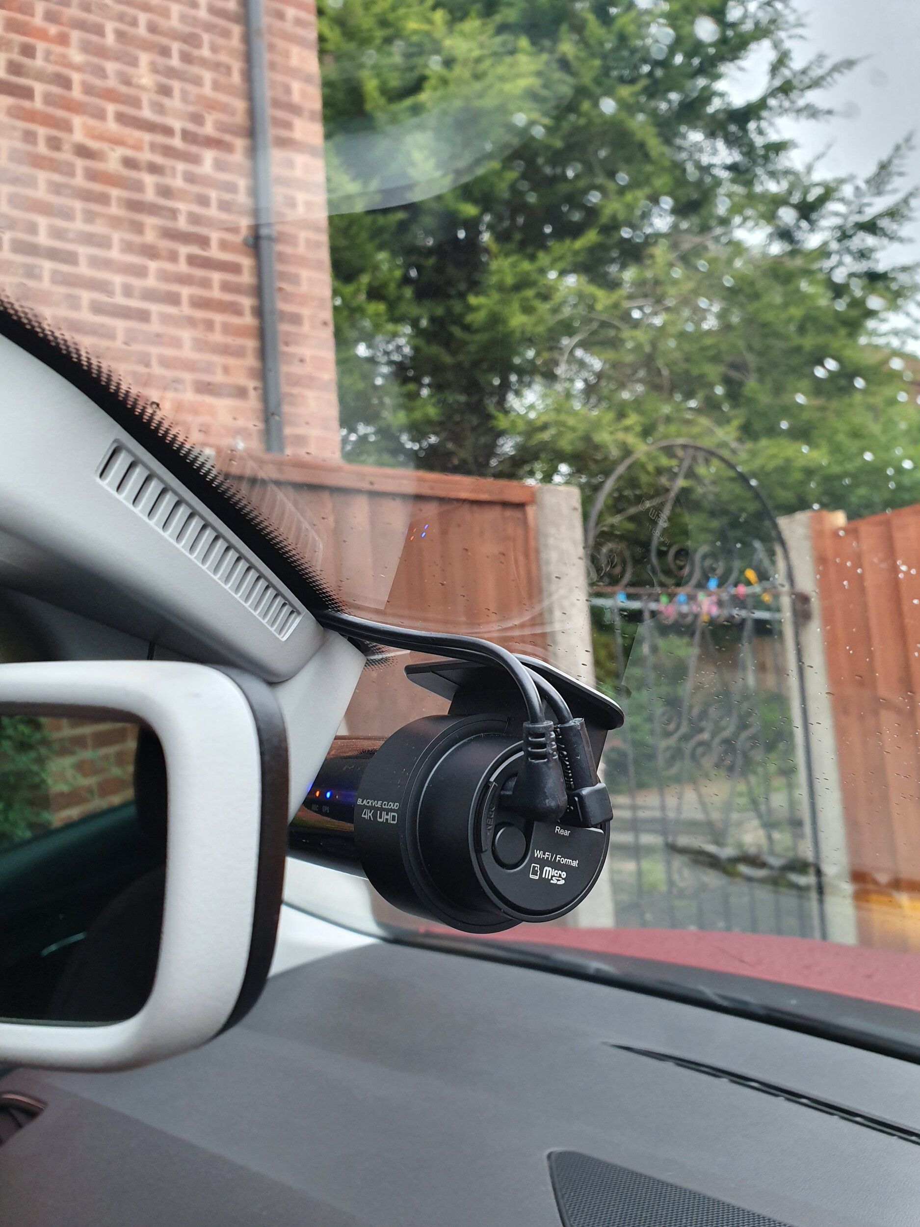

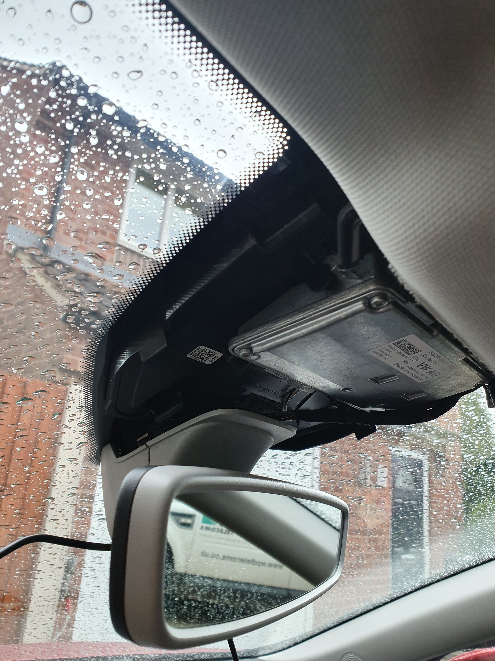

Now it is time to mount the front camera and route the required cables. I mounted mine behind the rear view mirror and routed the cables under the plastic trim for the rain sensor. This trim just pulls off, starting from the wider part at the edge of the roof lining, and slides out and off the mirror mounting area:

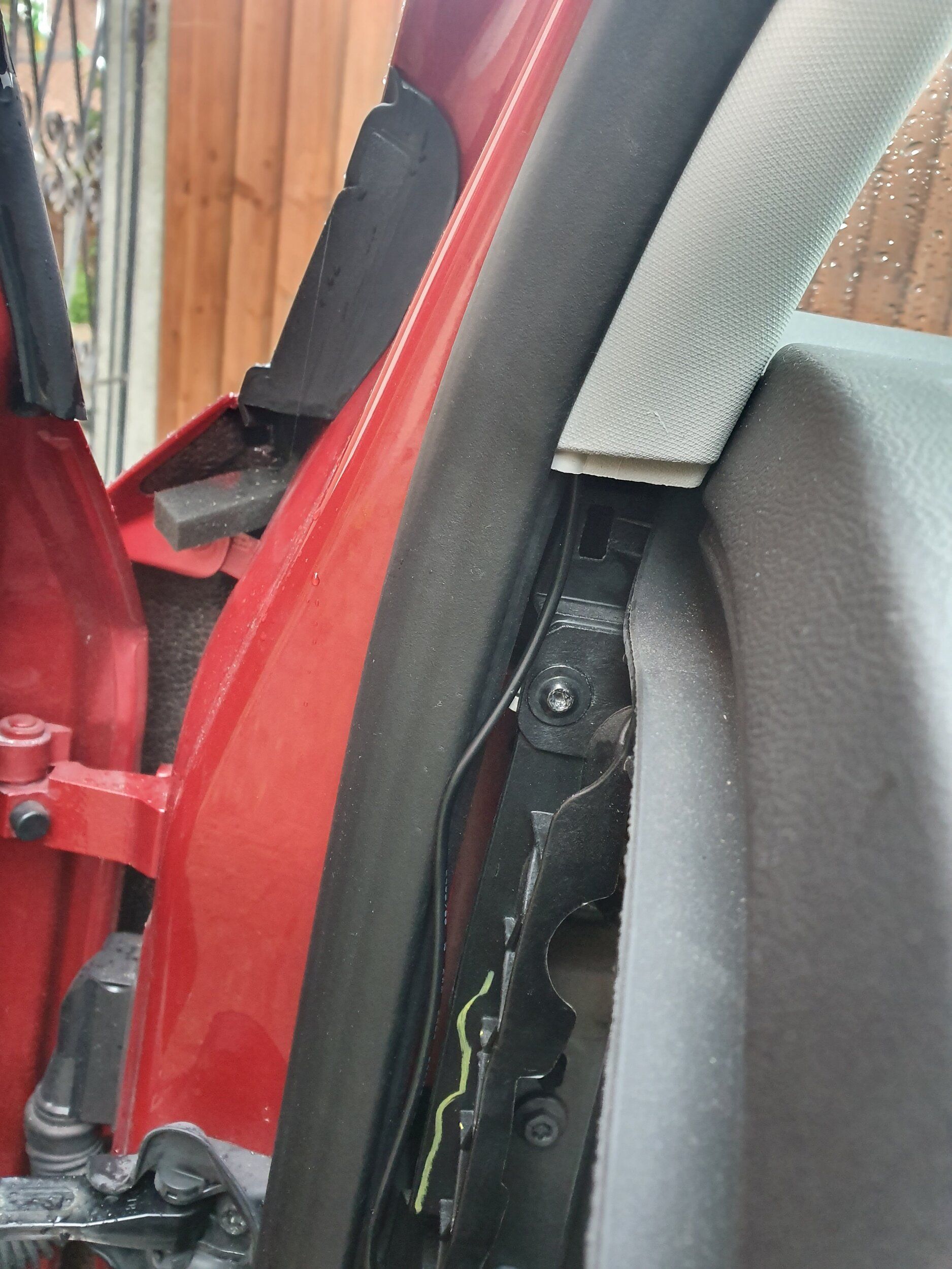

Once you have done this, you need to feed the power cable under the A pillar:
You can un-clip the A pillar trim if you wish, however I managed quite easily to just push it under down the length of the trim where the door seal sits:

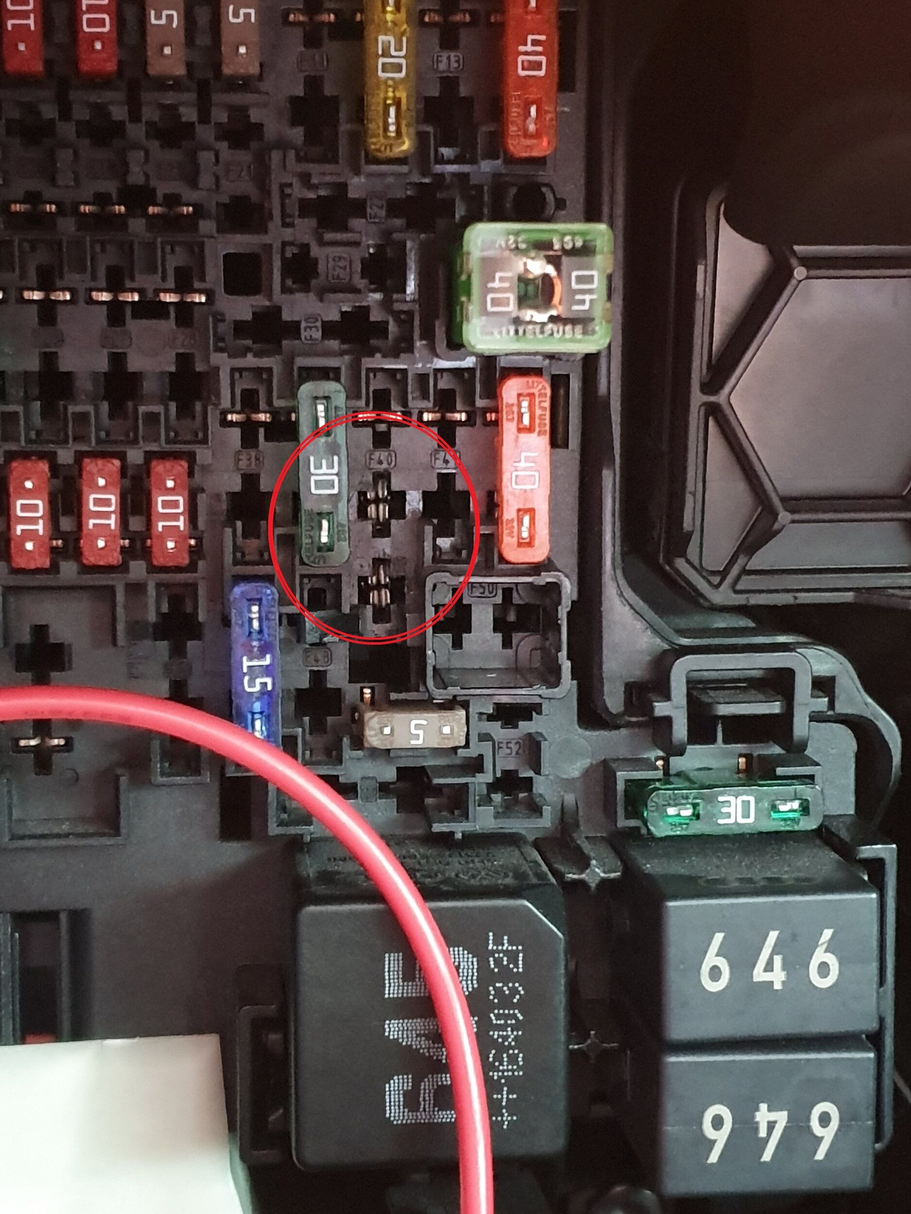

You can use fuse number 40 for a switched ignition live. The fuse box can be found behind the glove box compartment, which can be accessed by pushing in the sides of the glove box when it's opened. It will drop down, giving you access to the fuses. Fuse socket 40 is circle in red:

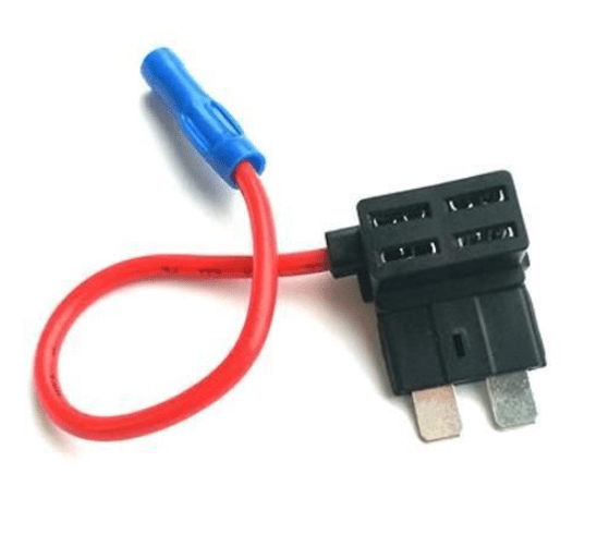

I used a piggy back fuse holder such as this one:

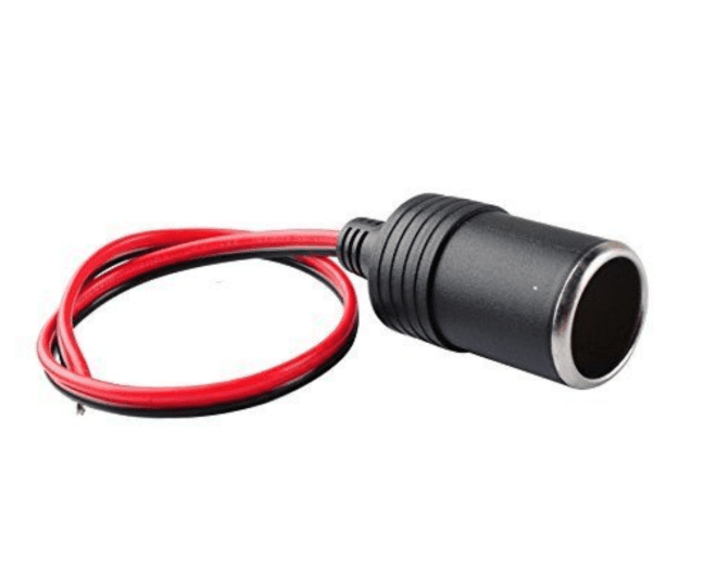

2. This method is the same as above, but omits the use of a voltage switch. This will turn the cam on and off with the ignition. How you do this depends on how the dash cam came. If it has a cigarette socket attached, you need to get an adaptor to wire it in with. Something like this would work and can be found on ebay:
If it came with a hard wiring kit, then you should have 2 wires you need to connect, a live feed and a ground. The process is the same as above, ground the cable to a bolt that connects to the body shell, and the live feed to fuse 40 behind the glovebox.
