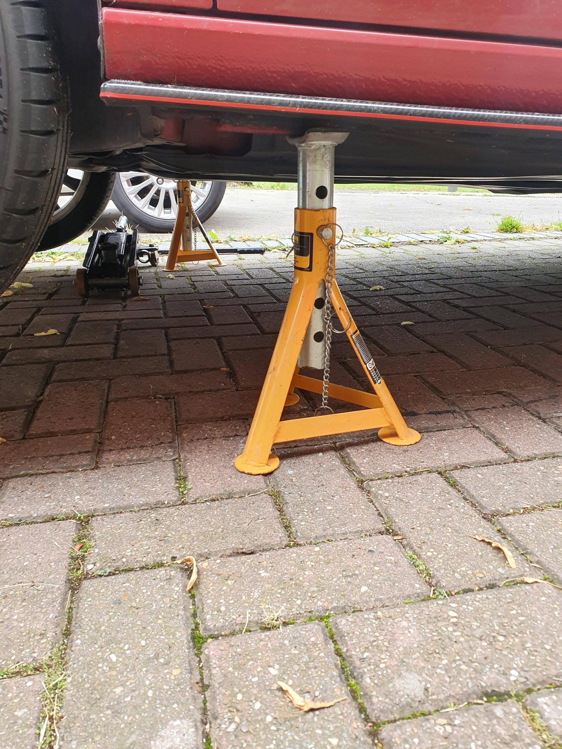

Firstly you need to get the vehicle in the air in a secure fashion. If you have access to a garage with a hydraulic lift, great! Use that. If not, use a jack and axle stands. You must use axle stands! I can't stress this enough, having had a car slide off a jack in the past and nearly crush me, seriously, use the axle stands as you're going to be smack bang under the engine should the car fall. If you don't have any, buy/borrow some. Do not put your trust in the supplied jack/scissor jack, they're nicknamed the Widow Maker for a reason!
Here is my car on said axle stands:

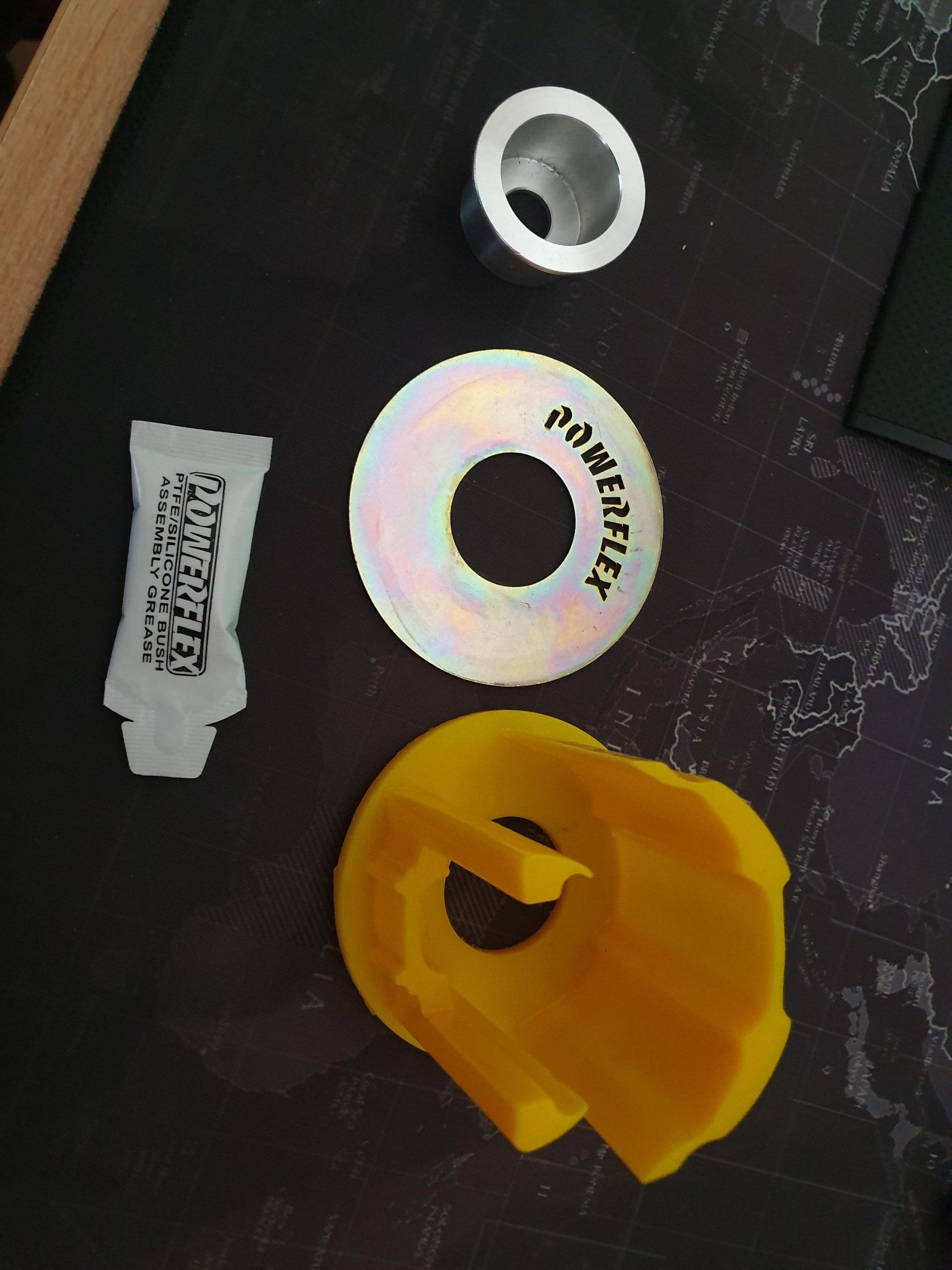

There are 2 types of these mounts used, and you need to make sure you get the correct insert. You can check the mount from above when ordering without having to go under the car, just look down the rear of the engine. I used my phone to snap a pic to make life easier when ordering the part. Here is the kit:

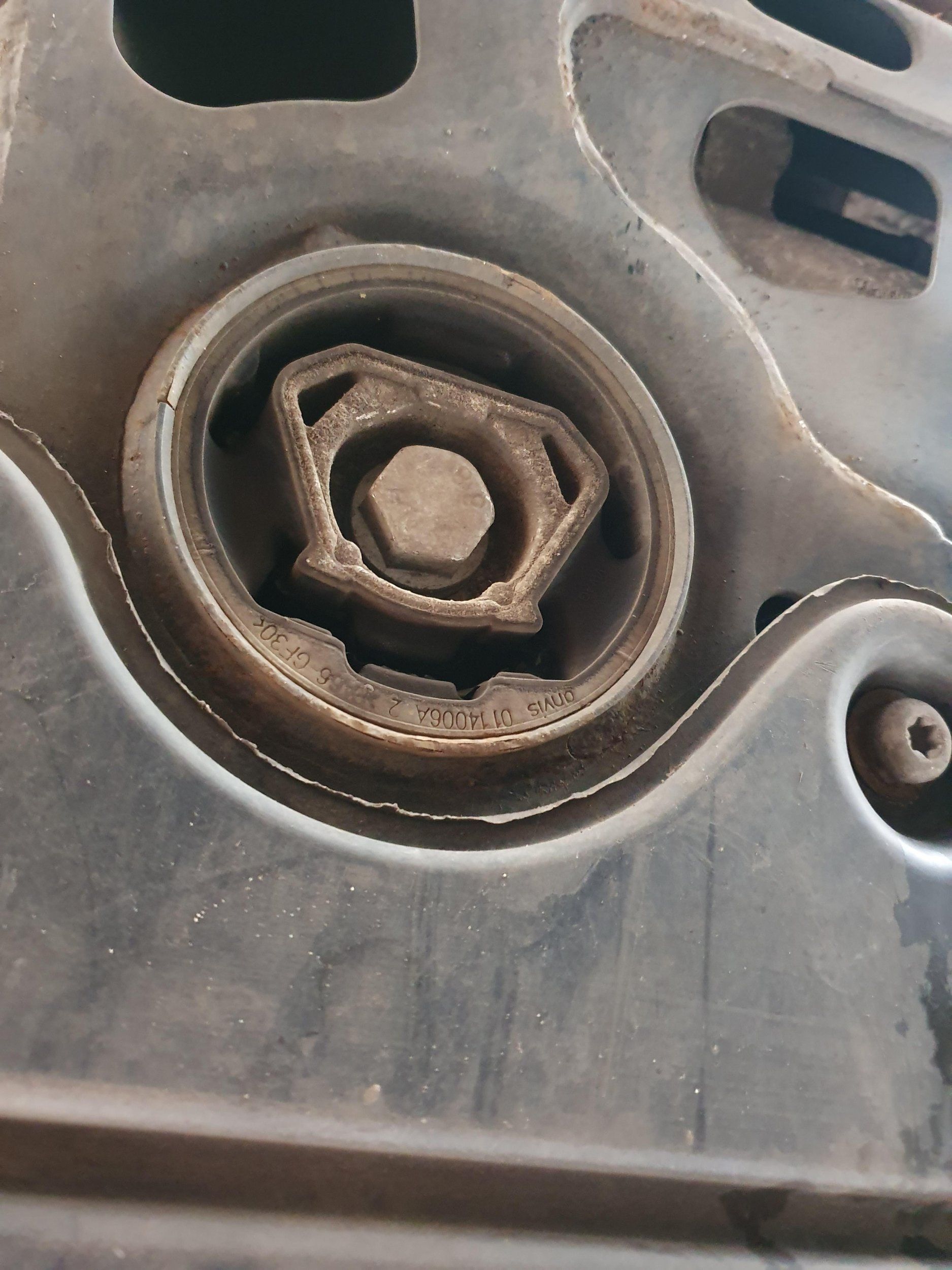

Once you've got the car lifted, shimmy underneath and you'll see the mount towards the rear of the engine. There is no need to remove the under tray to access it:

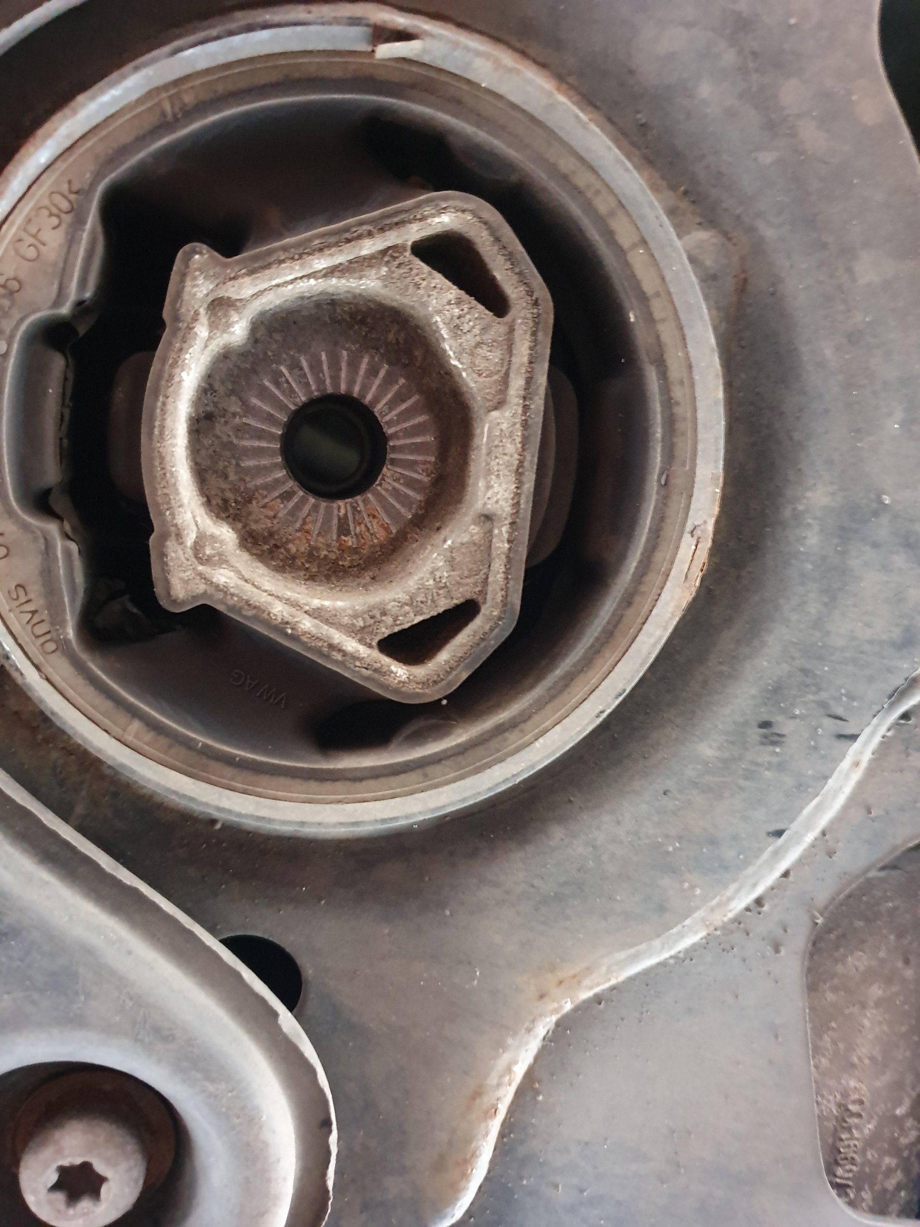

Next, remove the 21mm bolt:

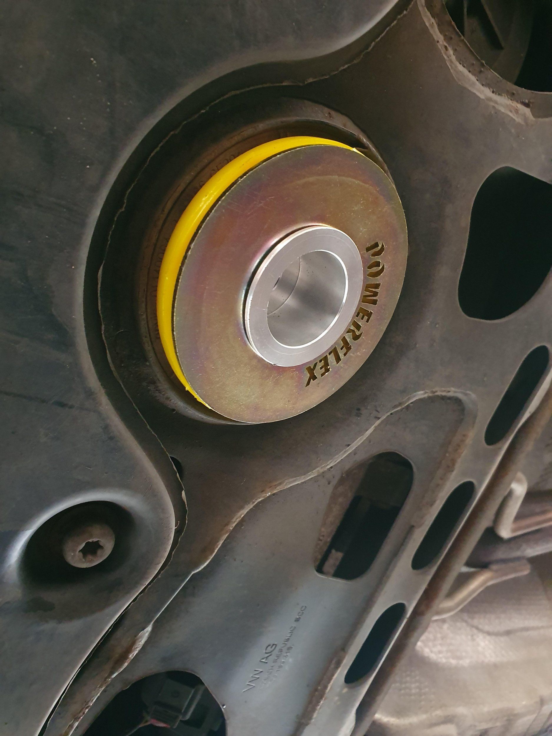

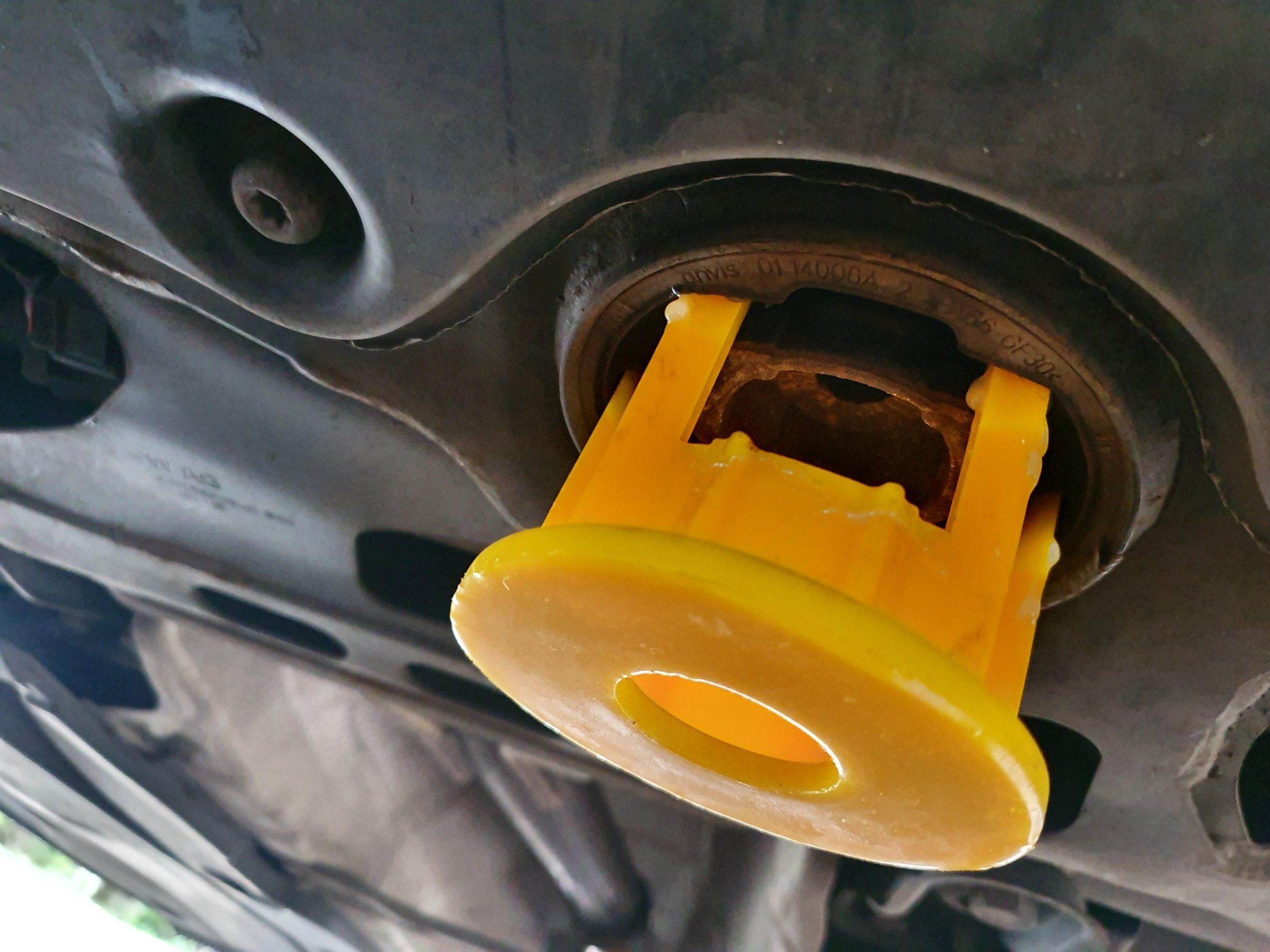

Now, check the bush for dirt and debris and clean it out if required. Next, using the supplied grease, lube up the insert and slide it into the voids in the existing bush:
It may be abit stiff, however it will go in assuming you ordered the correct insert. If you are struggling, apply more grease. Once you've got the mount in, insert the supplied metal washer and cap:

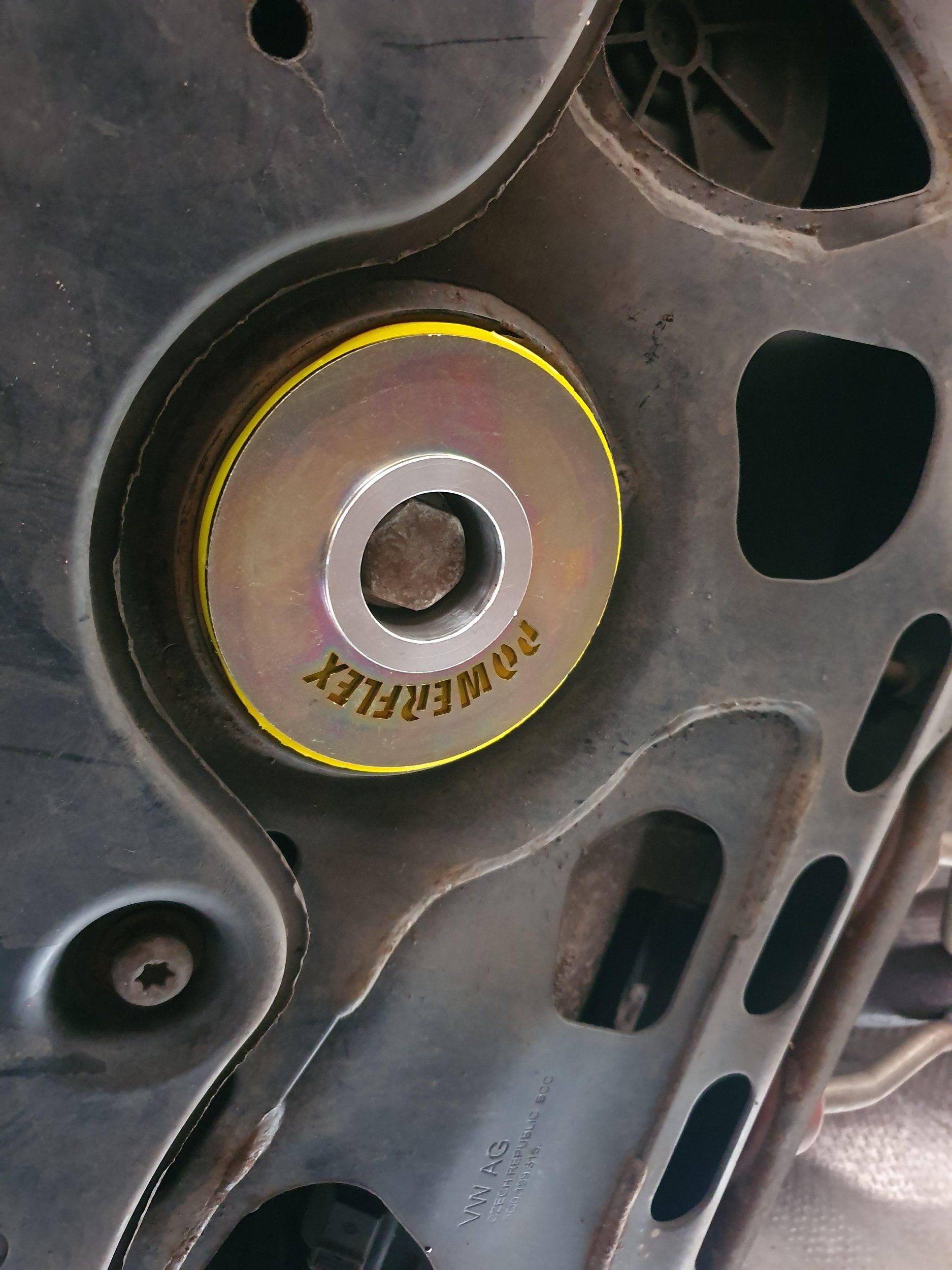

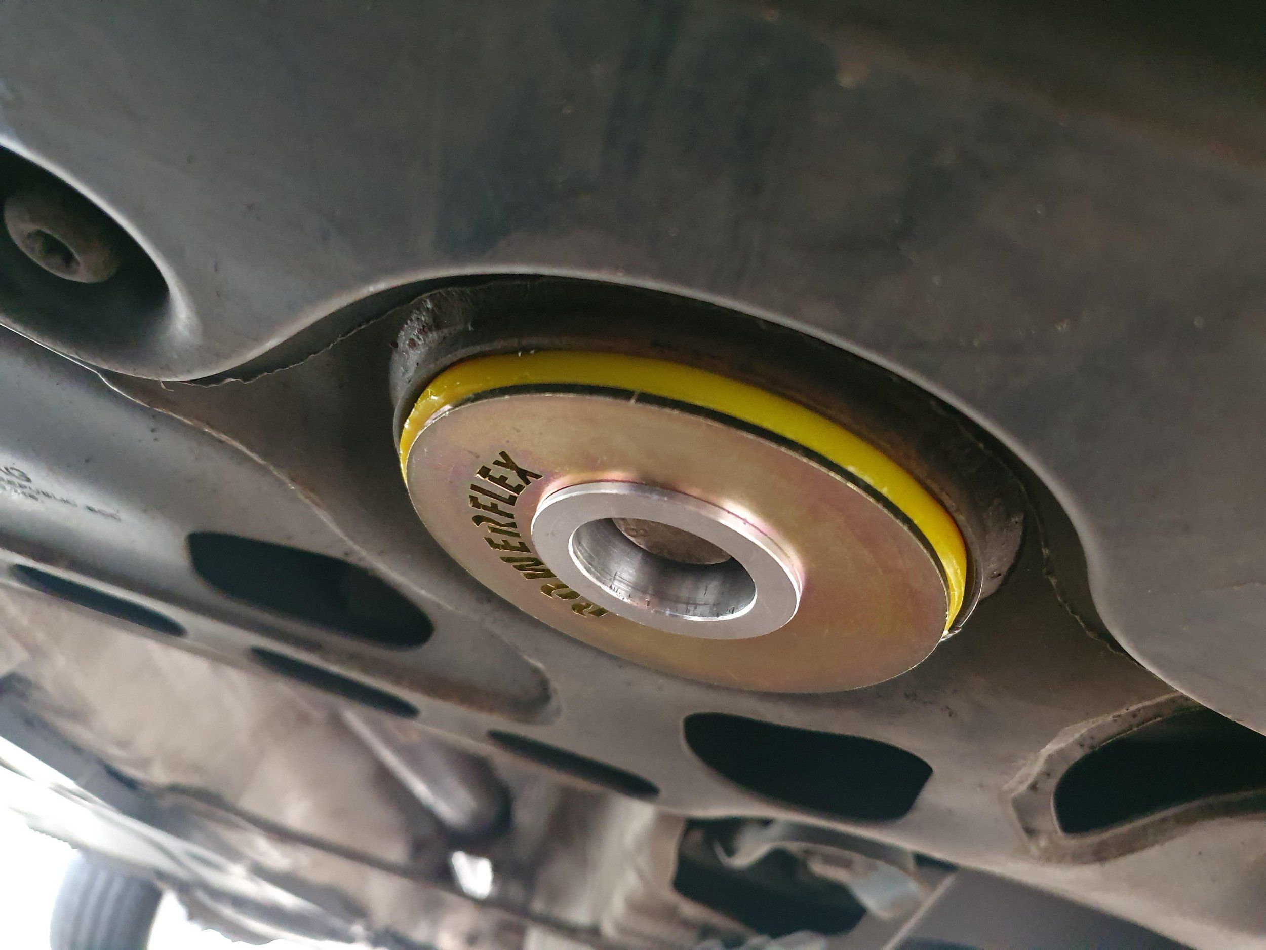

Once in, you need to replace the bolt and tighten. The bolt is what's known as a stretch bolt, and should be replaced if it has ever been removed as it is a once use only bolt. I reused mine, and have done severel times in the past without issue. However it is recommended they are replaced. The part number is N 912 010 01. Here it is all in with the bolt:

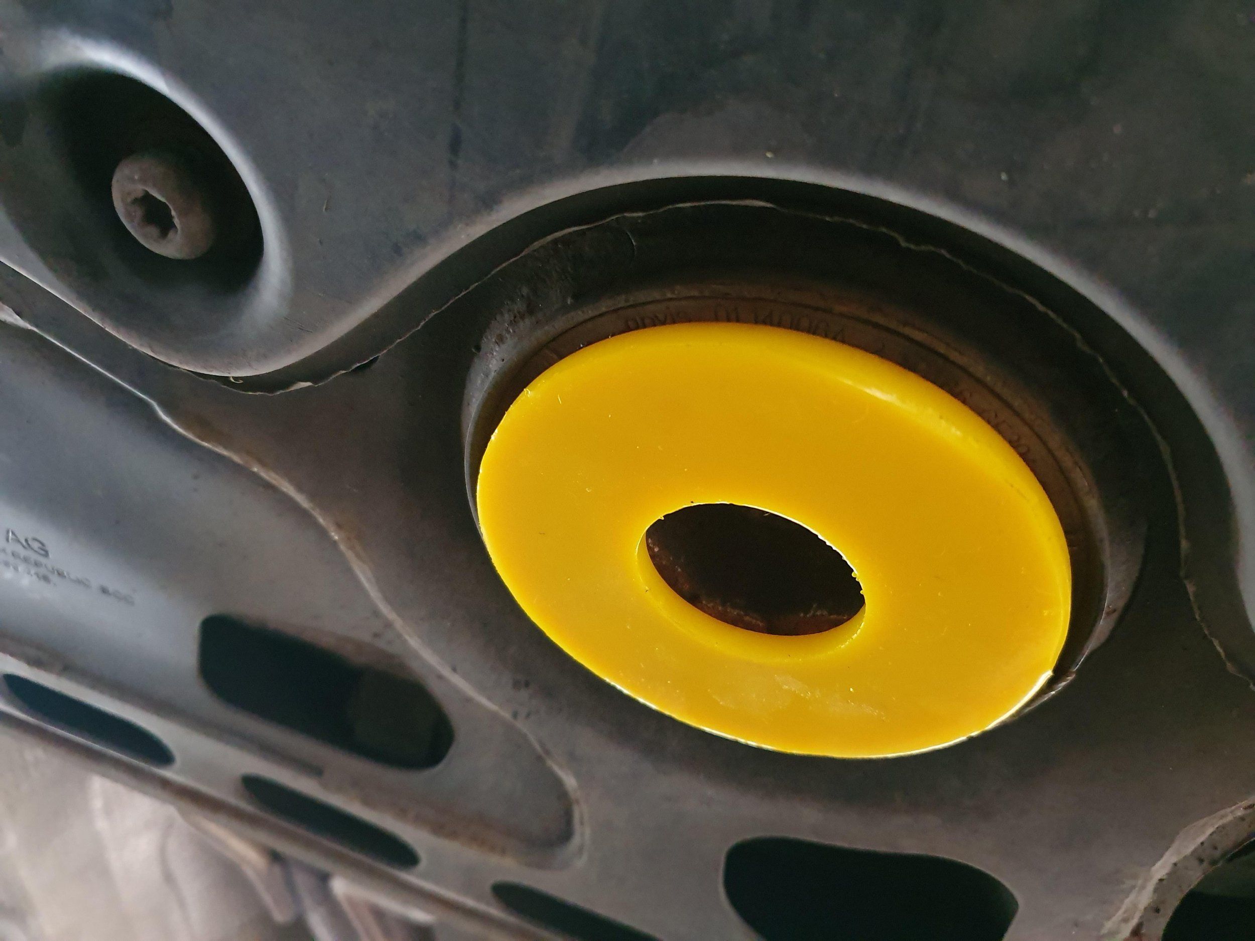

This bolt should be torqued to 135nm. Once done, the mount should be flush and look like this:
