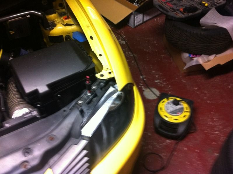

I'm going to cut the end off the original towing hook, then drill and tap it for the tow strap.
Hopefully I can manage to fit them evenly and not cut the bonnet to bits![]()

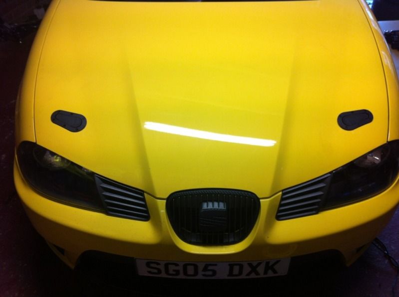

, and 2 fit the catches vertically as the bonnet contours don't allow them to sit ideally the way I've done itAero catch fitting:
Find a suitable hole
Fit pin
Drill out inner skin
Drill centre hole in outer skin
Mark out for catches
Cut out the hole
Finished
Hopefully tomorrow I'll get the inner skin off and that'll be that finished.
If anyone fancies doing it, 1 - don't, and 2 fit the catches vertically as the bonnet contours don't allow them to sit ideally the way I've done it
