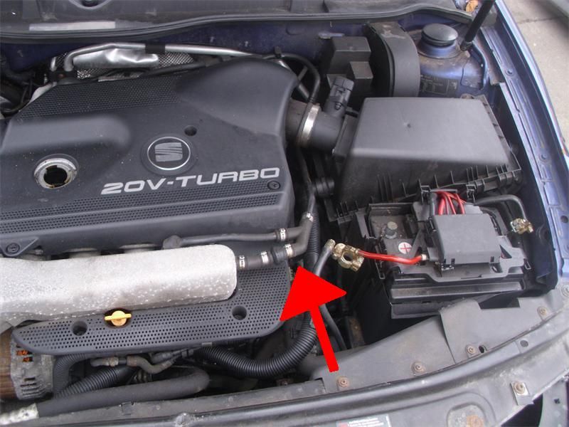

Check the pressure control valve in the crank breather system (n249? If so, in line, but bypassed)

I'm referring to the pressure control valve in the rubber t piece at the front of the engine under the manifold.

its in this area:
